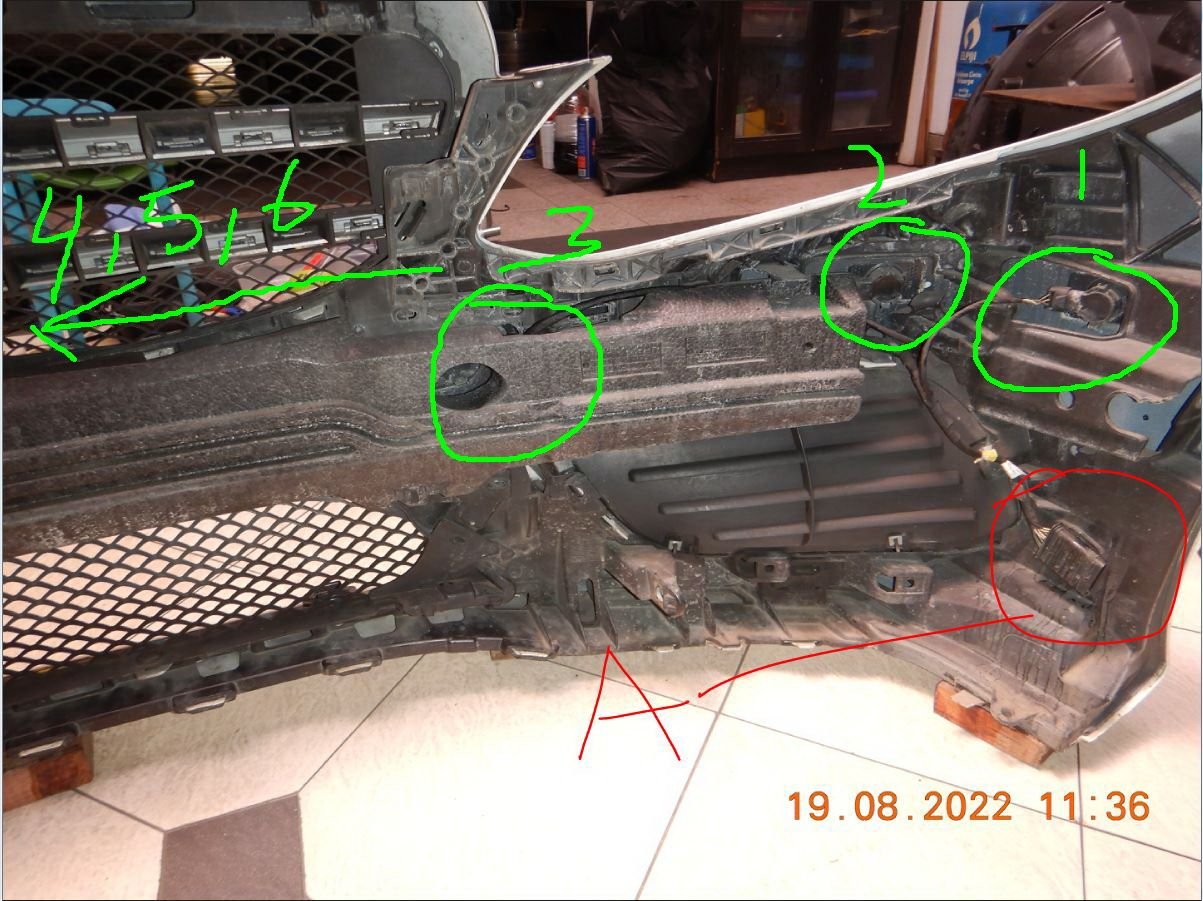

Check bad connetor or wire to bumper for these sensors.
A is at the bumper, right side.
B is at the car.
These two have s-e-x together
Make sure no water entry and no green crusty and no female pin overly open/expanded.
Use contact cleaner and clean these two, insert-remove-insert, while wetting out with contact cleaner. Engine OFF Ignition OFF.

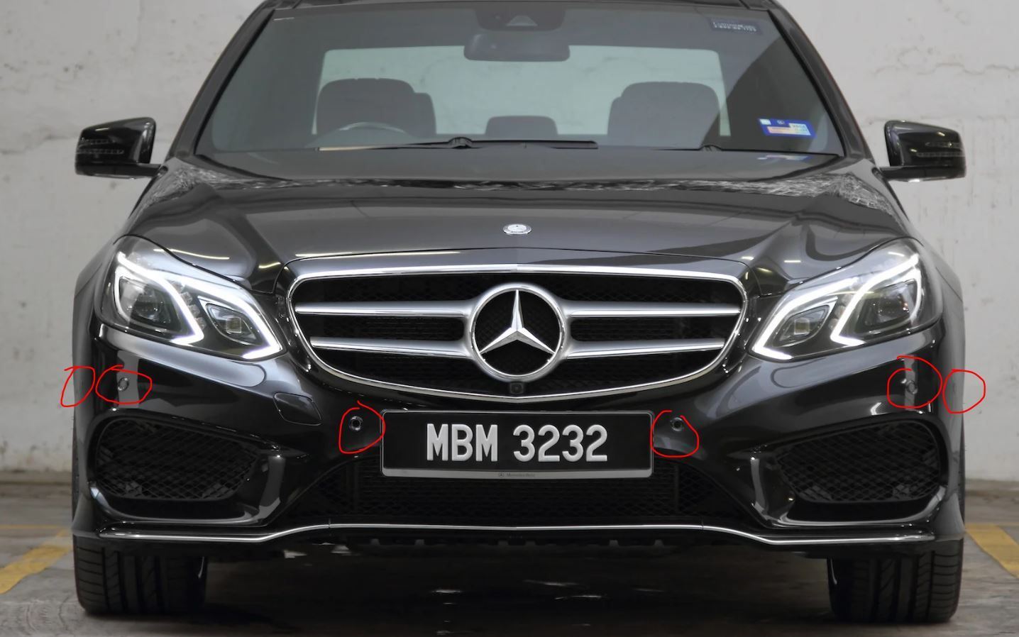

Inspect all 6 sensors at the bumper.
