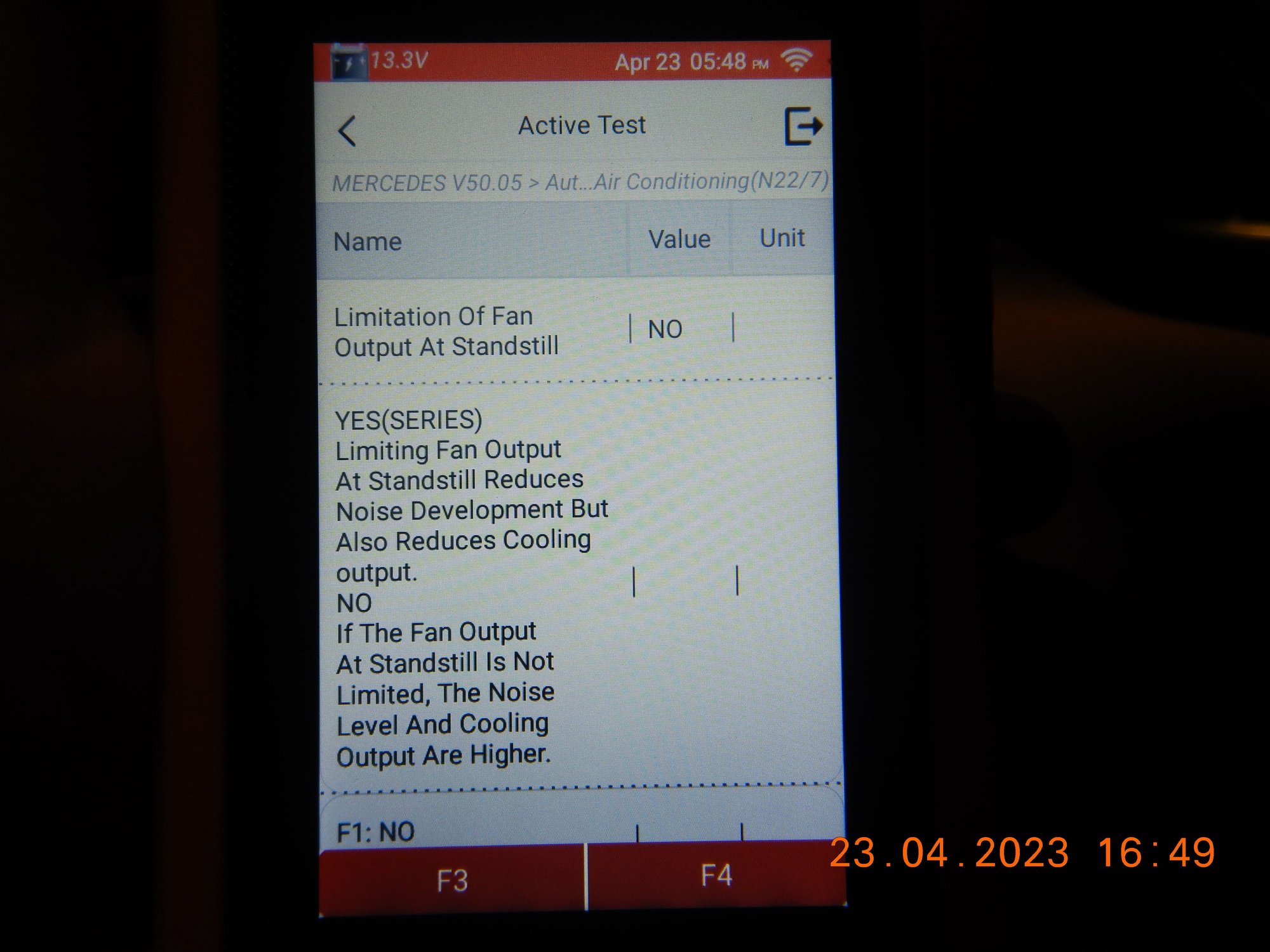

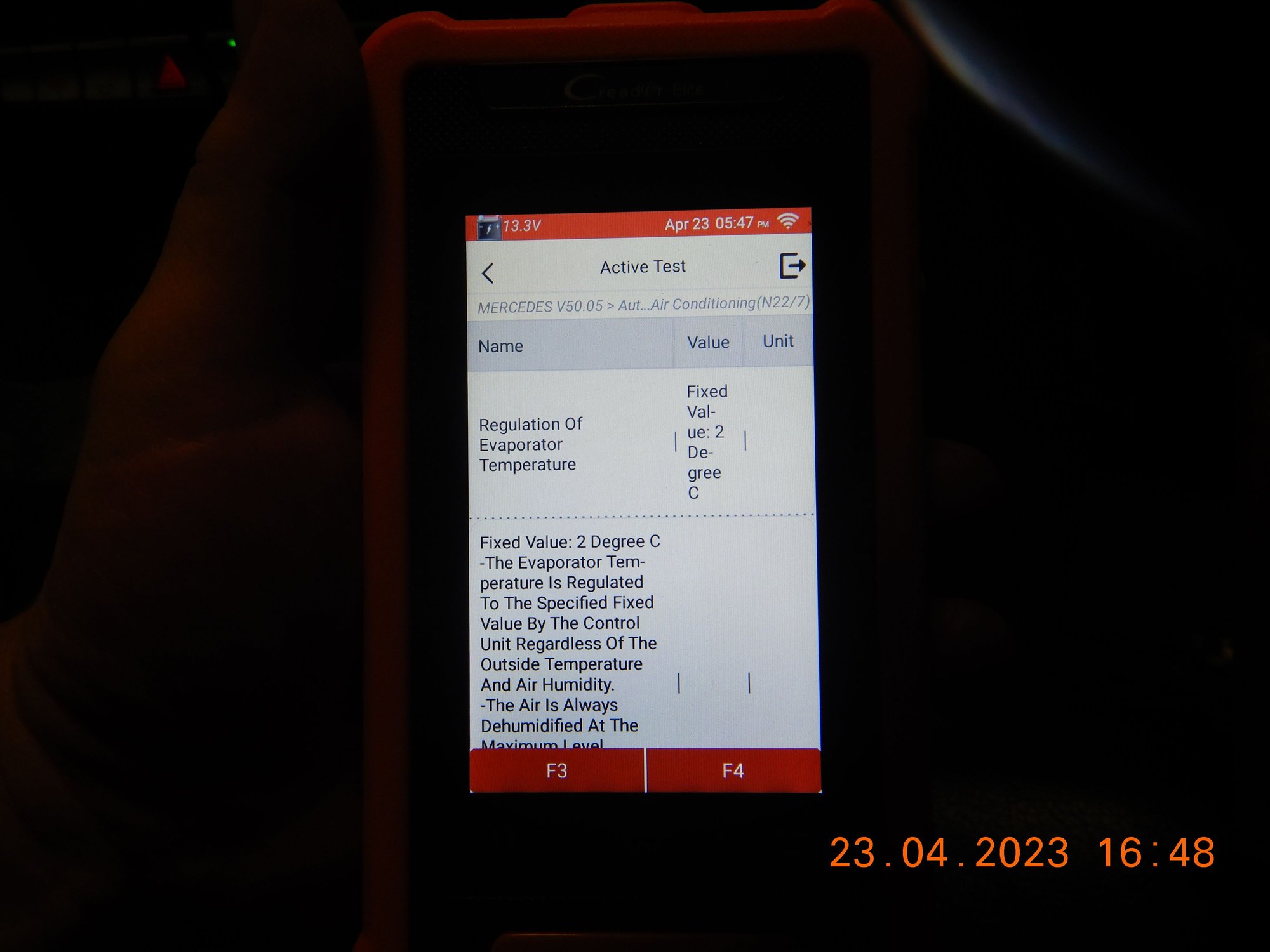

Originally Posted by prakersa

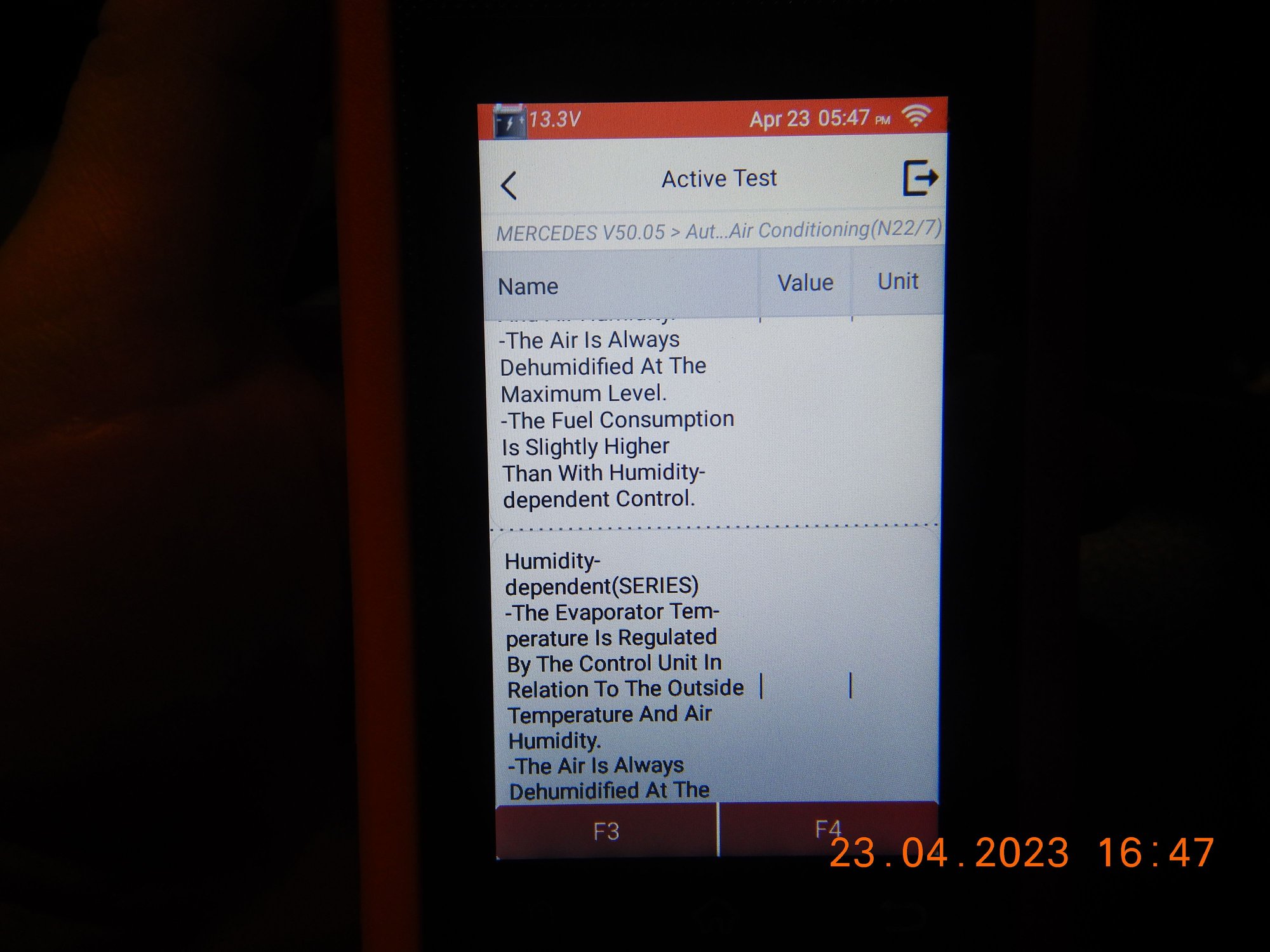

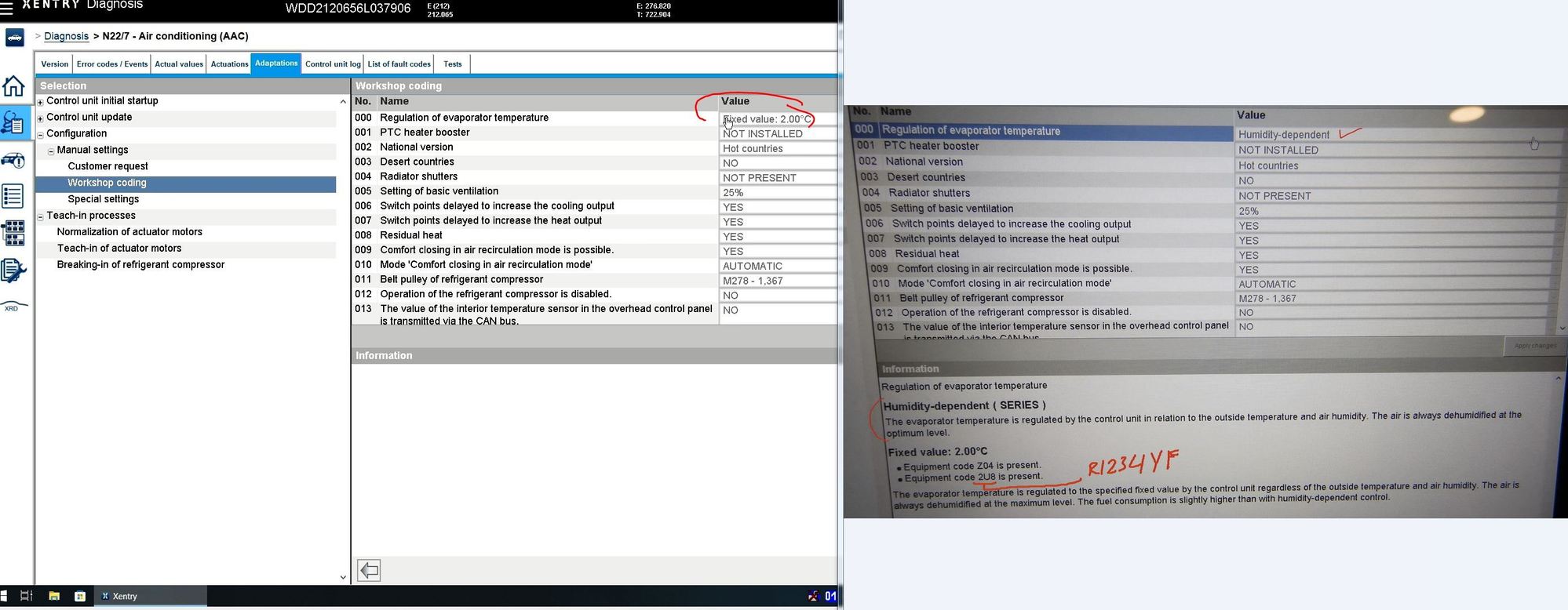

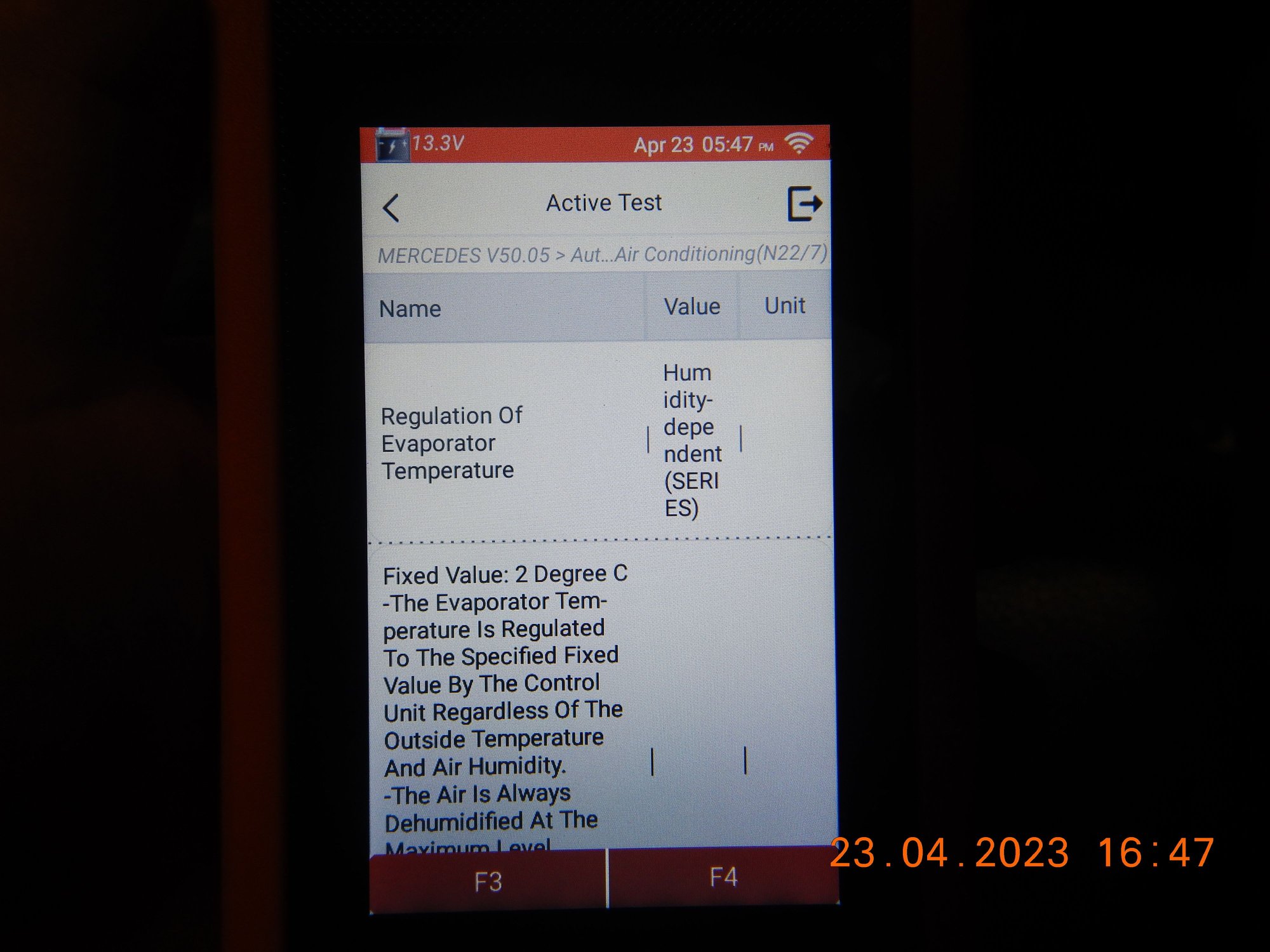

My compressor cut out when temp reach 1C and cut in when 4-5C. Normal or abnormal? E300.2009 thanks
That is normal factory setting.
It is called HUMIDITY DEPENDENT setting.

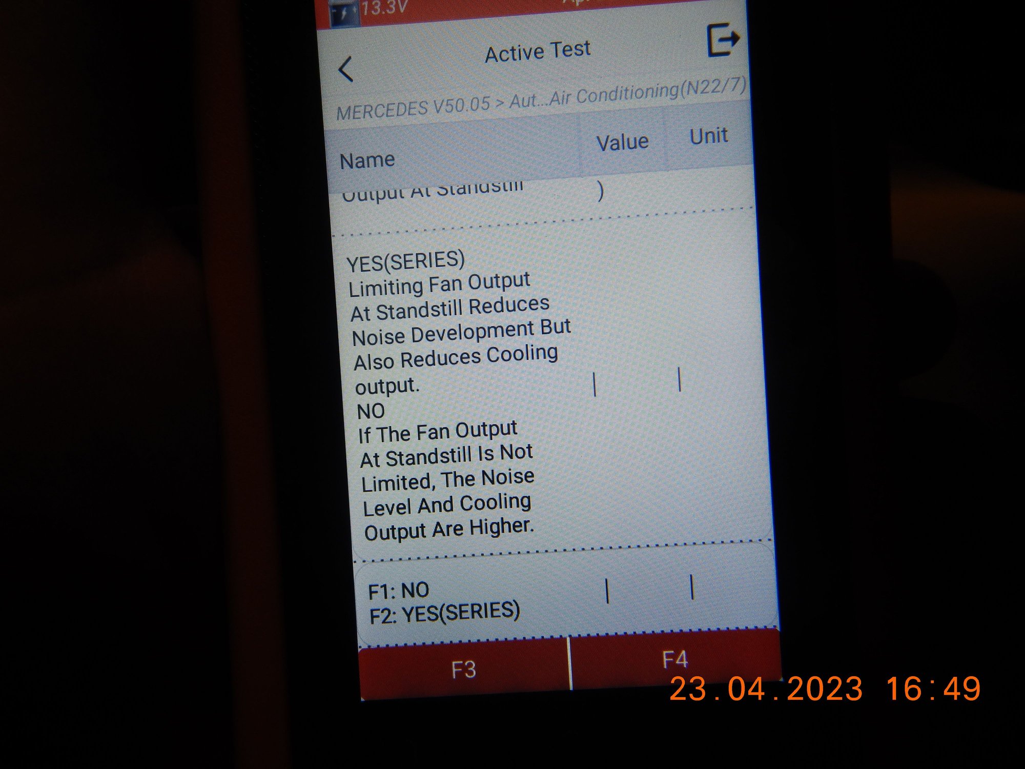

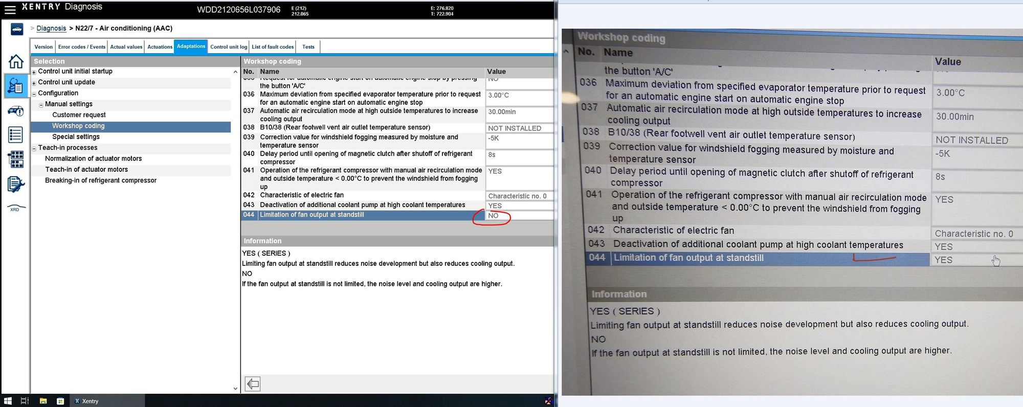

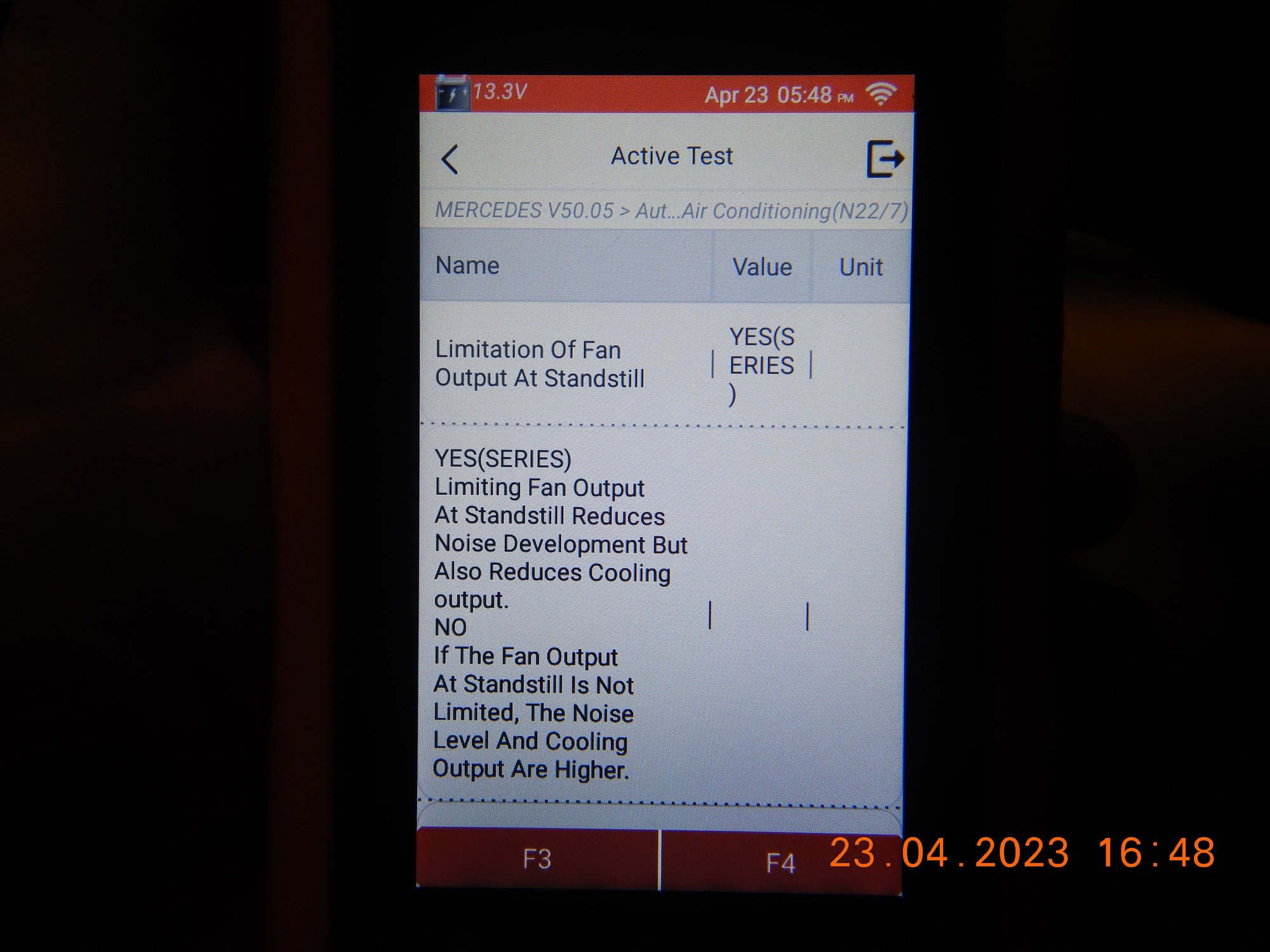

Use your Launch to change it to FIXED 2C
Also change the radiator ( also condenser) fan speed "quietness" target to NO.
