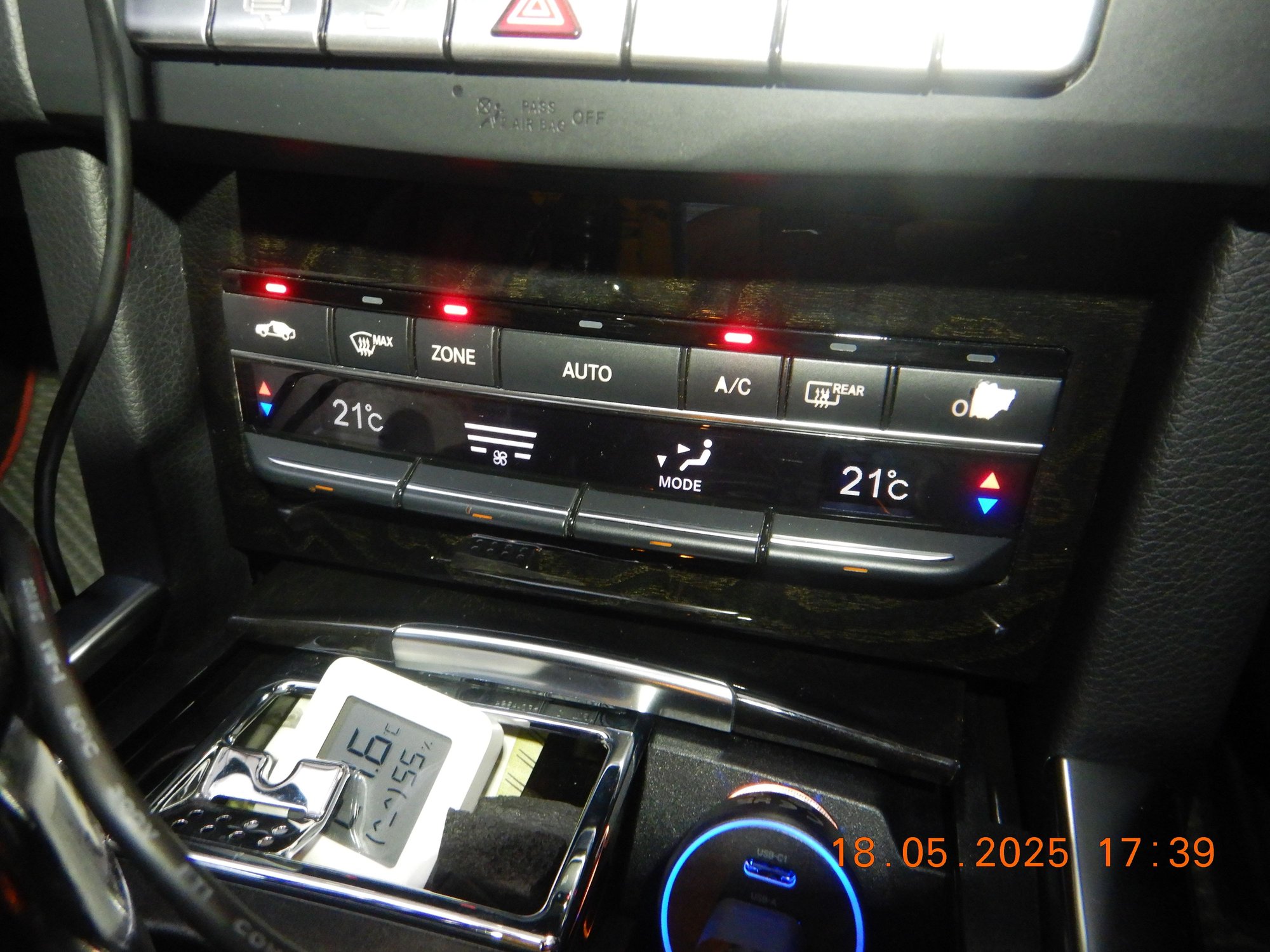

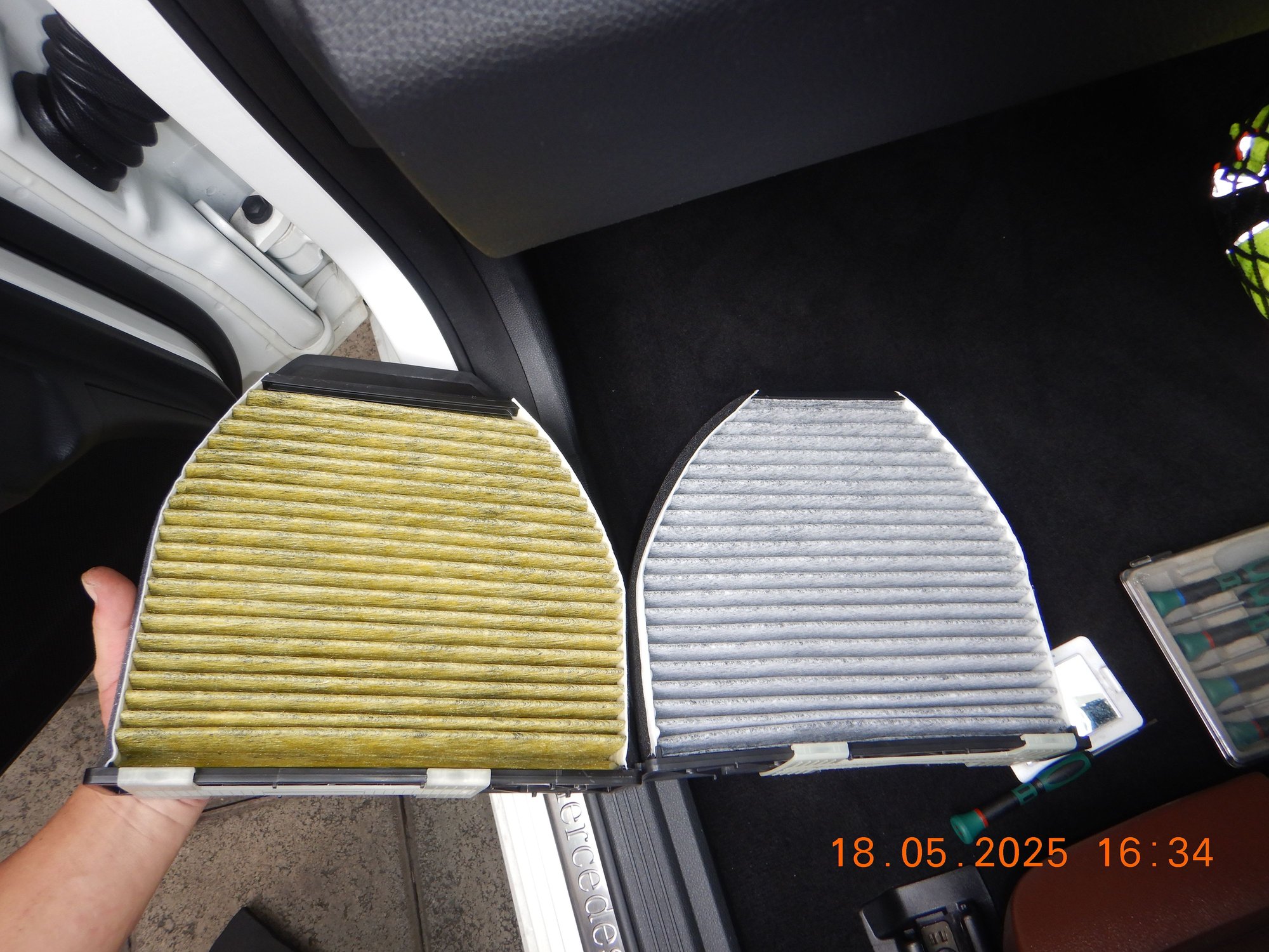

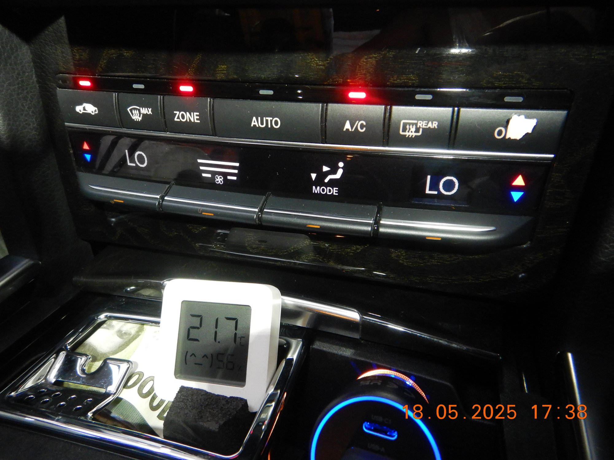

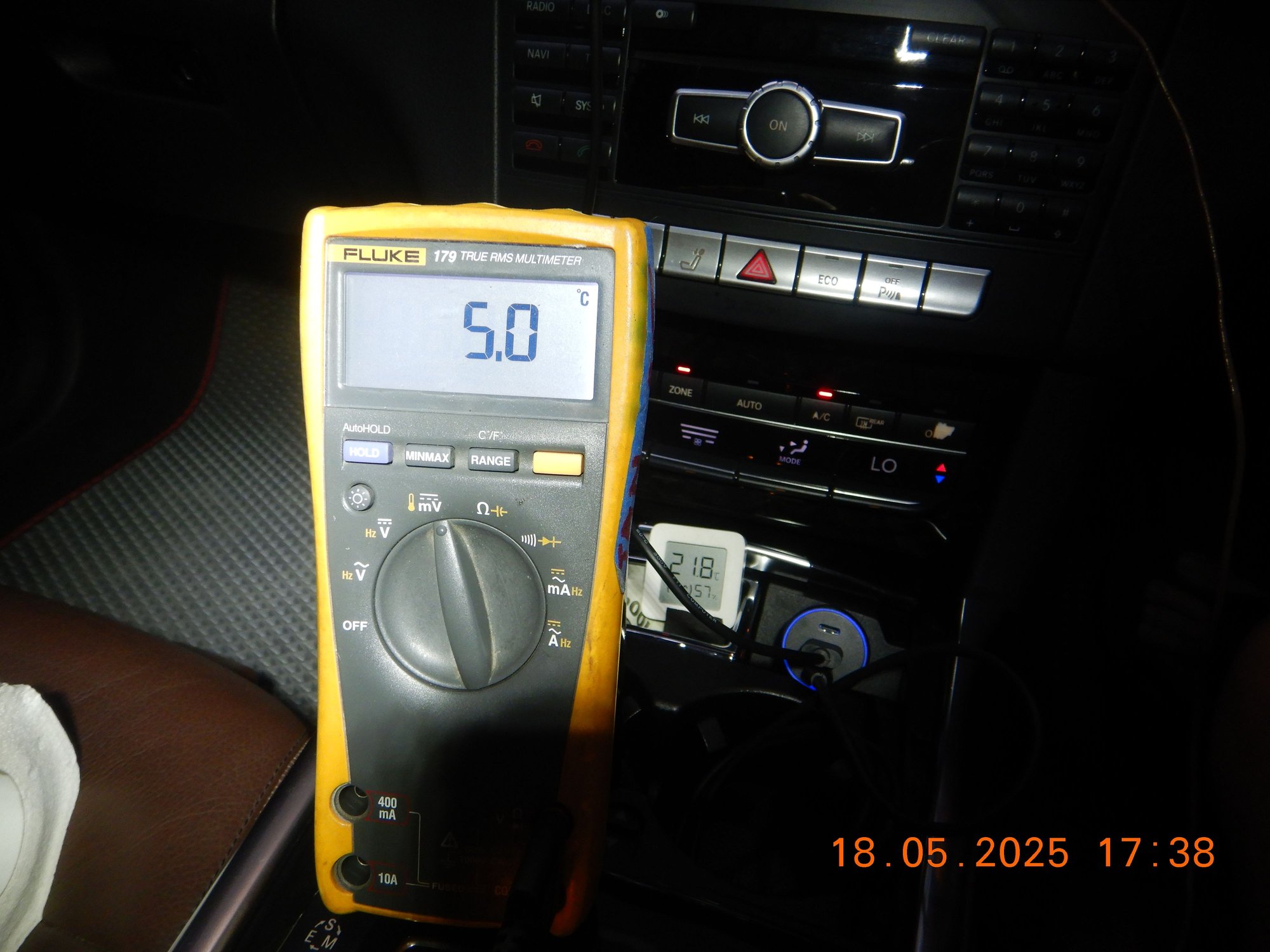

This is my car at 32C ambient temp after I replaced my cabin filter to the Ferocius Plus version with pollen trap, from MANN.
I let it idle for 20+ minutes at least. I have removed ( by-pass) the coolant circulation to my heater core. I am in the tropics, I do not need heater. I need HVAC 24/7 even at night when I use the car.

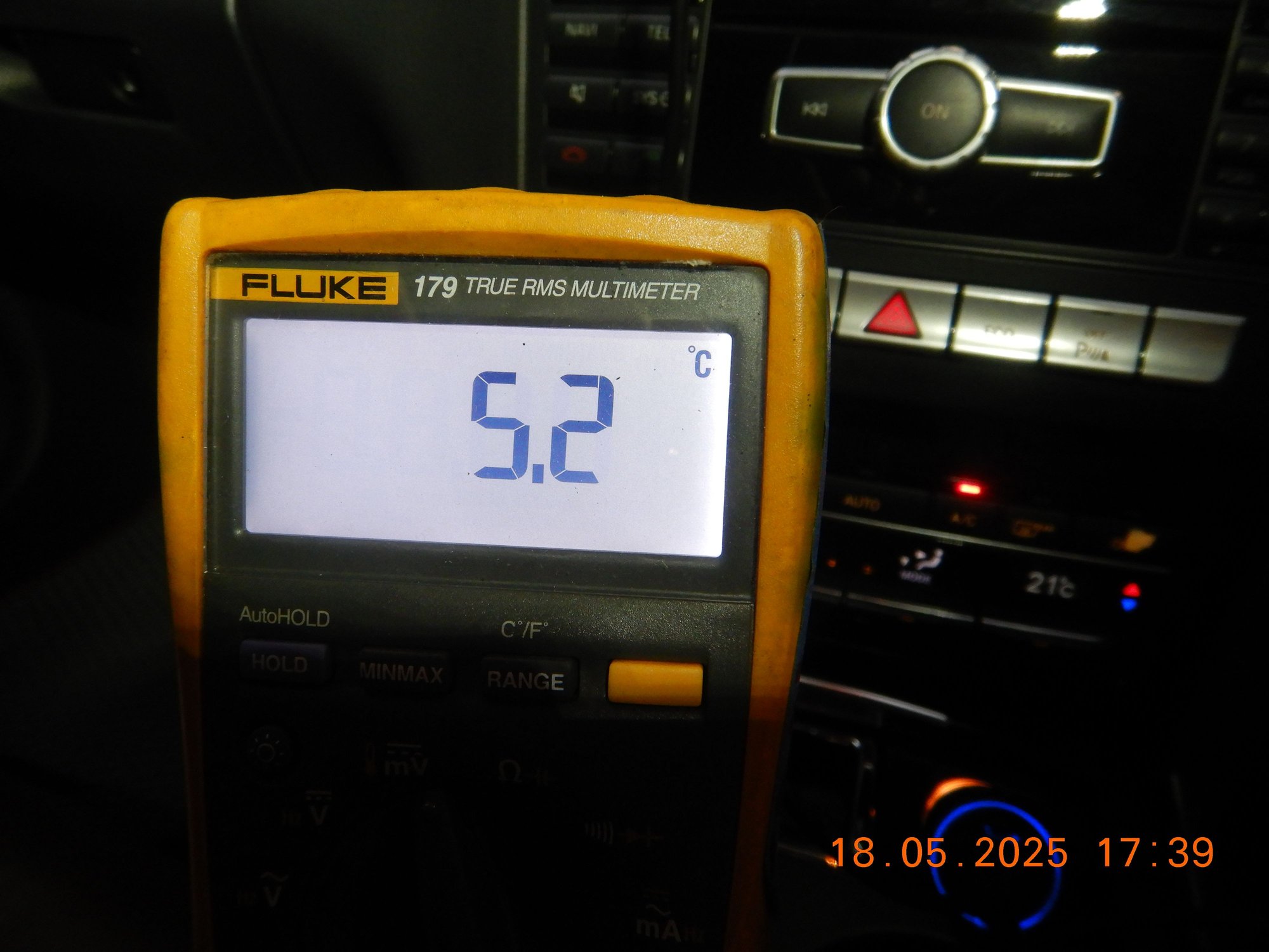

IF LOWEST TEMP MODE, at the vent 3 inches into the vent = 5.0C or 41F
I even use floor vent mode + passenger/face mode, thus in theory less cooling power to my middle vent ( passenger/face).
If I set to 21C or 69.8F, I get 5.2C ( 41.36F) at the middle vent

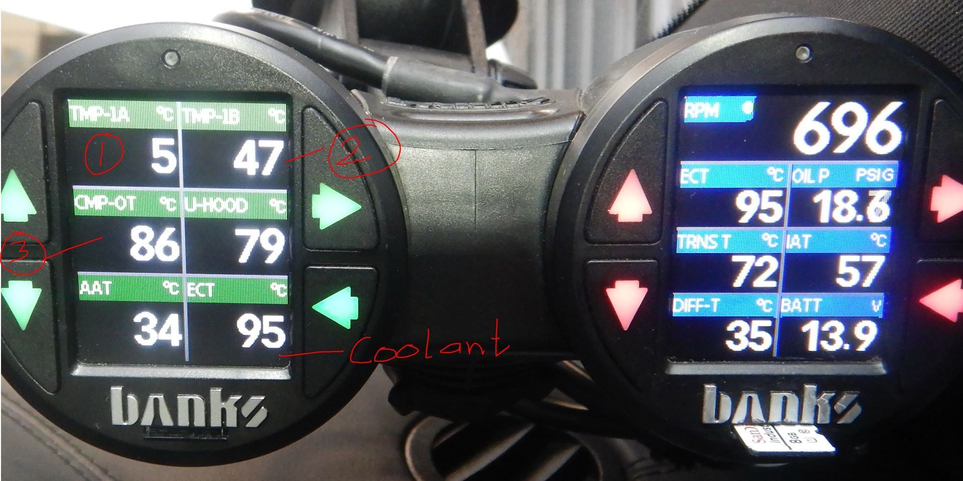

That 5C or 41F sensor TMP-1A label 1 , left gauge , top left.... that is the "exhausted" refrigerant fat pipe skin temperature at the EVAP TXV, near firewall. Suction pipe we call it or the blue color
coupler pipe when one uses those red and blue R134A coupler.
If departing "coldness" is still 5C /41F, can you imagine how good the EVAP is at removing heat ( making cold ) actually is at its surface area or assy, when and if the heater core is not contaminating it.
Label 2 is the condenser output pipe skin temperature.
Label 3 is the HVAC compressor pipe output skin temperature.
I monitor this to prevent HVAC compressor overheating death.

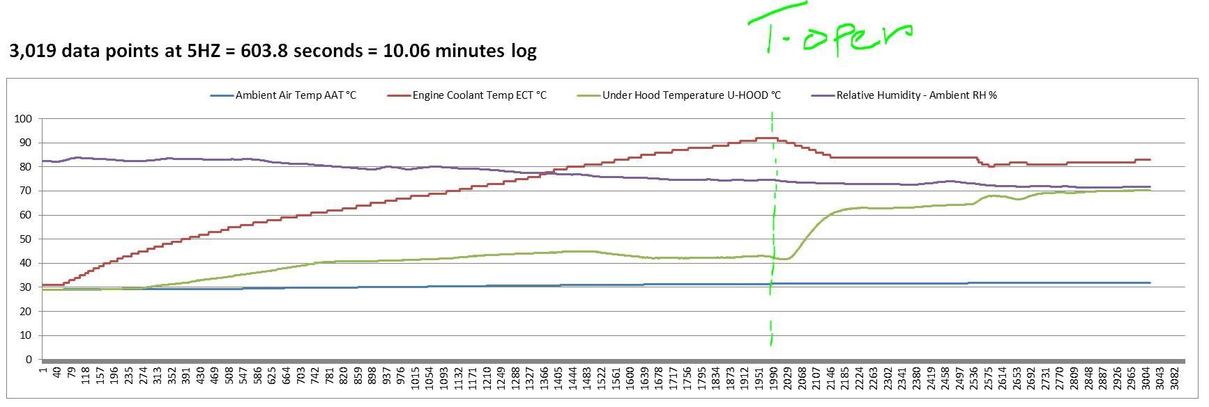

Thus I can show you guys what a virgin HVAC performance of W212 can do, when and if our engine is started from COLD of 30C temperature.
Every damn thing on the car is at 30C. So it is a very very nice temperature for HVAC to work.
When at engine kill after a drive and heat soaked and then you star the engine and AC 30 minutes later, no matter how good is our fake firewall heat shield hiding the wiper assy and
thus the TXV and EVAP firewall section, engine bay heat will heat all up.
It will heat up our compresssor, our hoses and our mini internal heat exchanger at the pipe and the condenser....every dam thing and that alone is parasitic load.

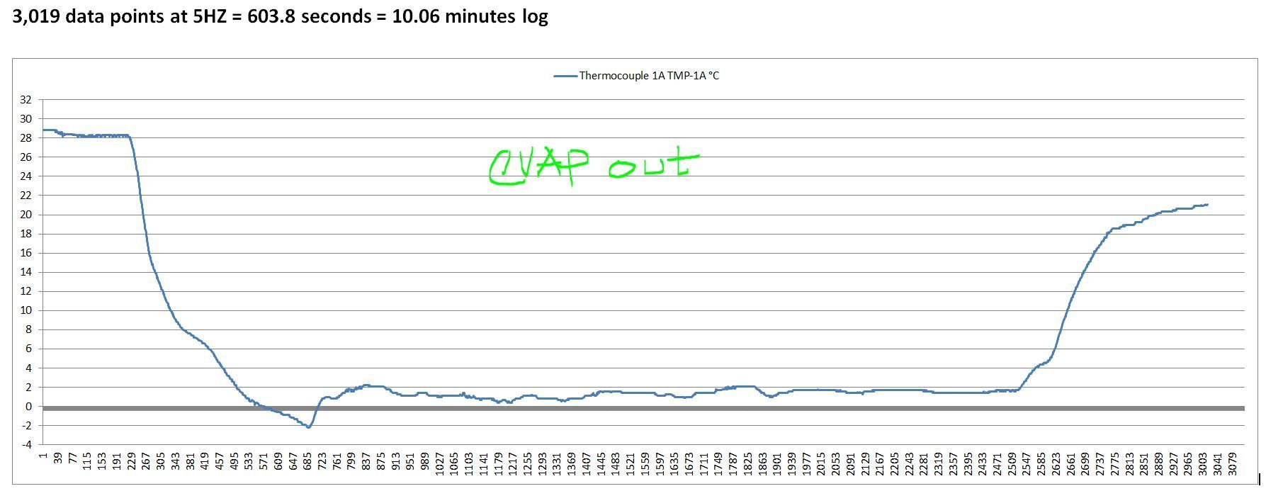

Here is the log.

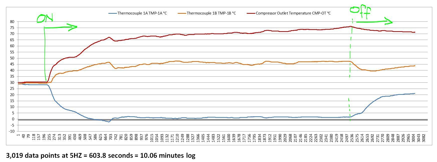

TMP1A is EVAP fat pipe ( outlet /suction ) skin temperature.
TMP 1B is condenser output at its metal section pipe skin temperature
Compressor outlet Temp is , the L steel section pipe at compresssor outlet skin temperature. L pipe is steel and then rubber hose.
Below, T Open means engine coolant thermostat open, thus we can see the engine bay temperture ( under hood ) , suddenly rise up a lot.
Above, initial temperature of EVAP fat outlet pipe being -2C at start of HVAC operation is common.
See how the EVAP is being controlled by the HVAC computer to try to maintain its 2C set temperature.

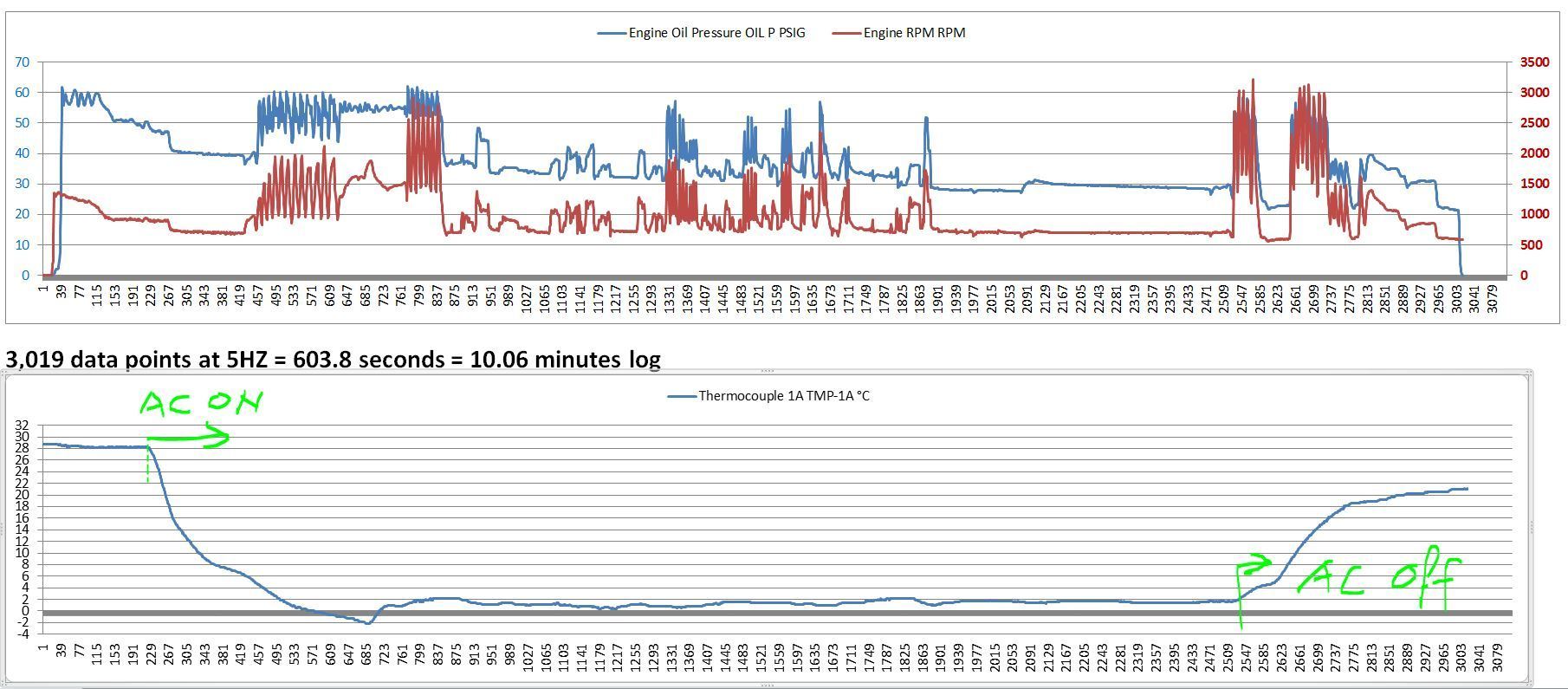

Below is how I warm up my engine when I dont use it on the road. Usually 25 minutes, but today me lazy.
The middle section data point 875 to ,1863 is me moving forward and reverse in my garage clearing rust on the brake like a fool.
Hope this is useful info for you guys.
