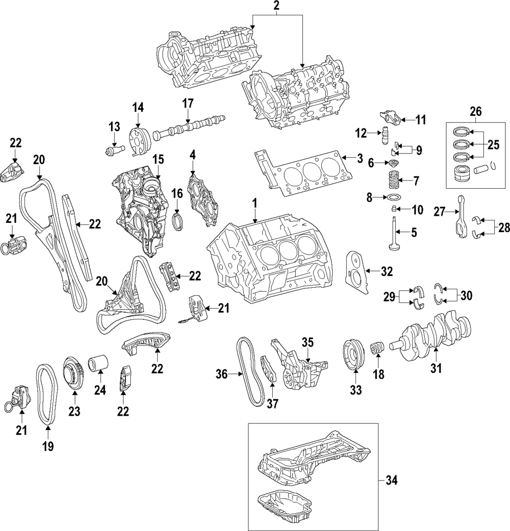

Typical rattle on startup. Replaced both upper timing chain tensioners and the issue remains. I inspected the VVTs while I was in there and they all looked good. My next guess is the lower timing chain tensioner, but despite dozens of online resources describing the replacement of the uppers, I can find NOTHING on the lower. In fact I couldn't even find a mention of there even being one, until I found the exploded diagram on FCP Euro that shows a third tensioner. I am assuming the whole front cover needs to come off to change this? Anyone have a reference as to how bad a job this is? Part #21, part number 276-050-06-11-64.
Old Jul 8, 2025 | 04:36 AM
S-Prihadi's Avatar
Joined: May 2018
Posts: 6,600
Likes: 6,547
From: Jakarta-Indonesia
At the least you MUST state what engine model yours is and don't let people wonder.
It looks like M276, 6 cylinder and no balance shaft.
The lower timing chain tensioner belongs to ENGINE OIL PUMP. So this is a 3rd timing chain tensioner and it has its own chain.
VVT each bank get its own timing chain and tensioner, 1st and 2nd unit.
So total is 3.
The rattle is probably from your VVT sprocket itself. It will happen, they are consumable items, but high mileage ones.
Do you have a fast Xentry , like the one from benzninja.com ?
If you do, log it from engine dead to engine start. When it rattles, the degree values will be whacky for sure.
Read here : https://mbworld.org/forums/e-class-w...rt-idling.html

Apologies, yes it's a '14 M276 engine. Also when I replaced the upper tensioners I confirmed I do have check valves installed as well.
I found a very good video on diagnosing VVTs, and mine are doing none of the things this person had going on in the video - puking oil, "jumping" etc. Do they still fail without being visibly bad? I don't have a Xentry, and from the link you posted I'm not going to be able to get this data with my iCarsoft.
I am really hoping it's not the VVTs, at almost $1k apiece even if I did them myself, that's getting dangerously close to what the car's worth given its' 190,000 mi.

Do you generally have to replace the oil control valve (in the center of the sprocket that mounts it) or just the sprockets themselves? Are there any actual moving parts to the valve that wear out?
Old Jul 8, 2025 | 08:39 AM
S-Prihadi's Avatar
Joined: May 2018
Posts: 6,600
Likes: 6,547
Always replace the VVT sprocket and the oil control valve ( its middle/center ) together. Oil control valve is cheap.
If you can be patient for say 3 weeks or so.... you can try a rebuild VVT company in Europe.
Here : US$530 excluding courier cost into Poland and back to you in USA, which is using DHL, US$120 each way I think its about right. So extra US$240 or so.
https://mehenker.com/en/regeneration...&id_currency=3
Supposedly 2 business days is the rebuild time. Lets say 5 business days or 1 week.
You must watch their utube videos, their machine shop is awesome.
