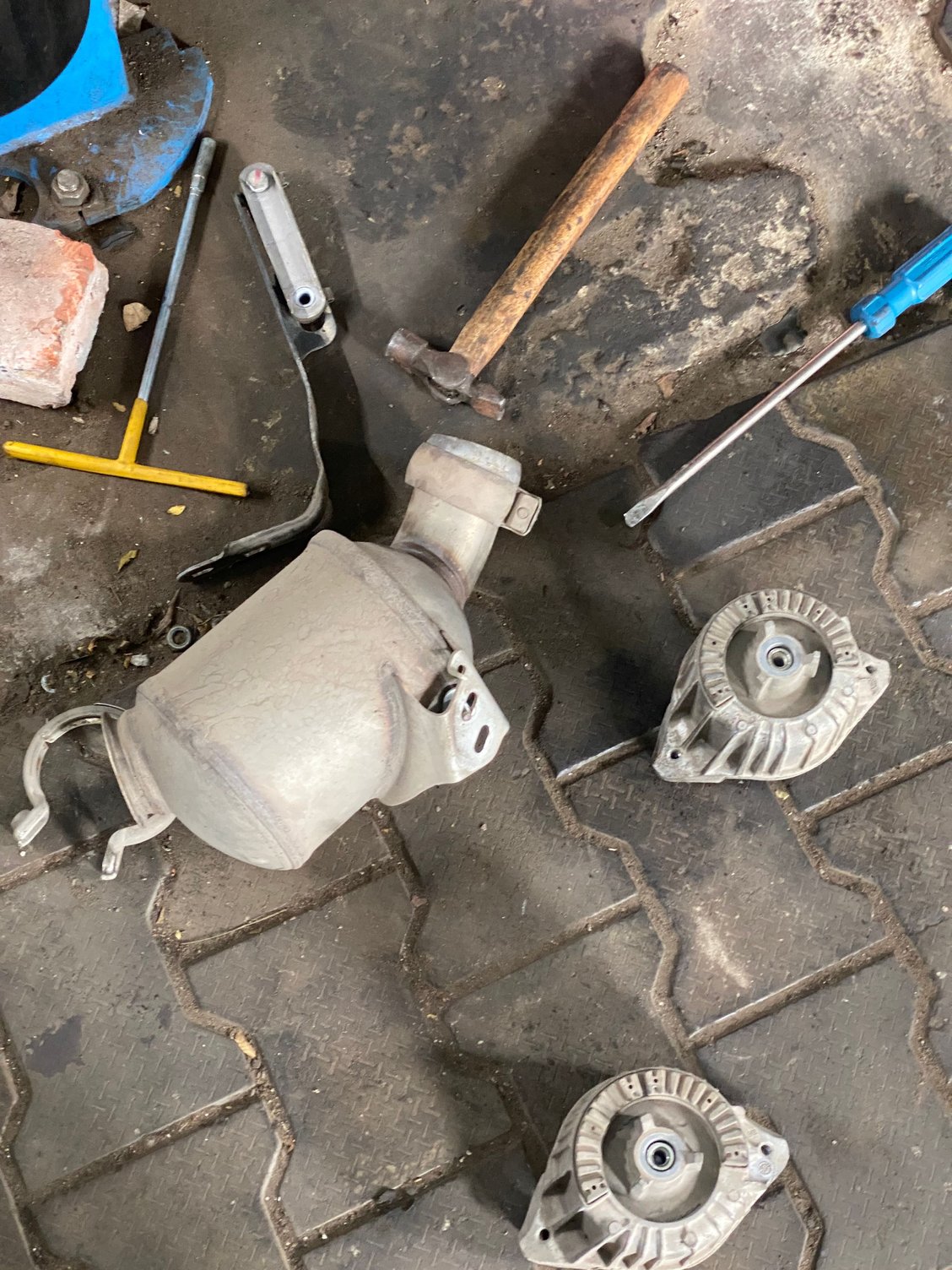

During the work, my mechanic also removed the catalytic converter and the intermediate (lower) steering shaft to access the engine mounts on driver side. What could have went wrong there?

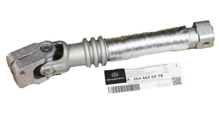

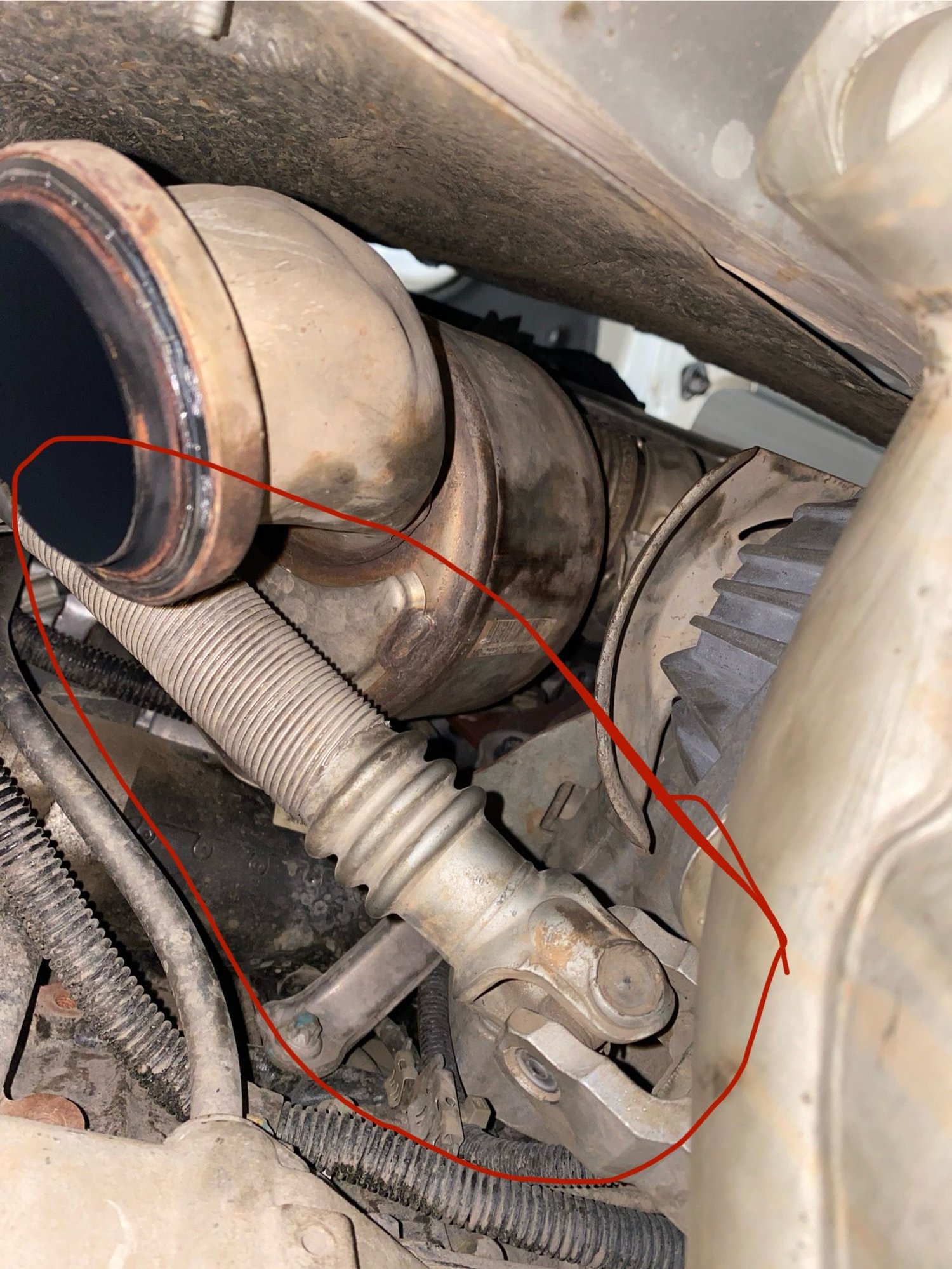

the red circled part was removed and I found on the internet it’s intermediate shaft
Edit

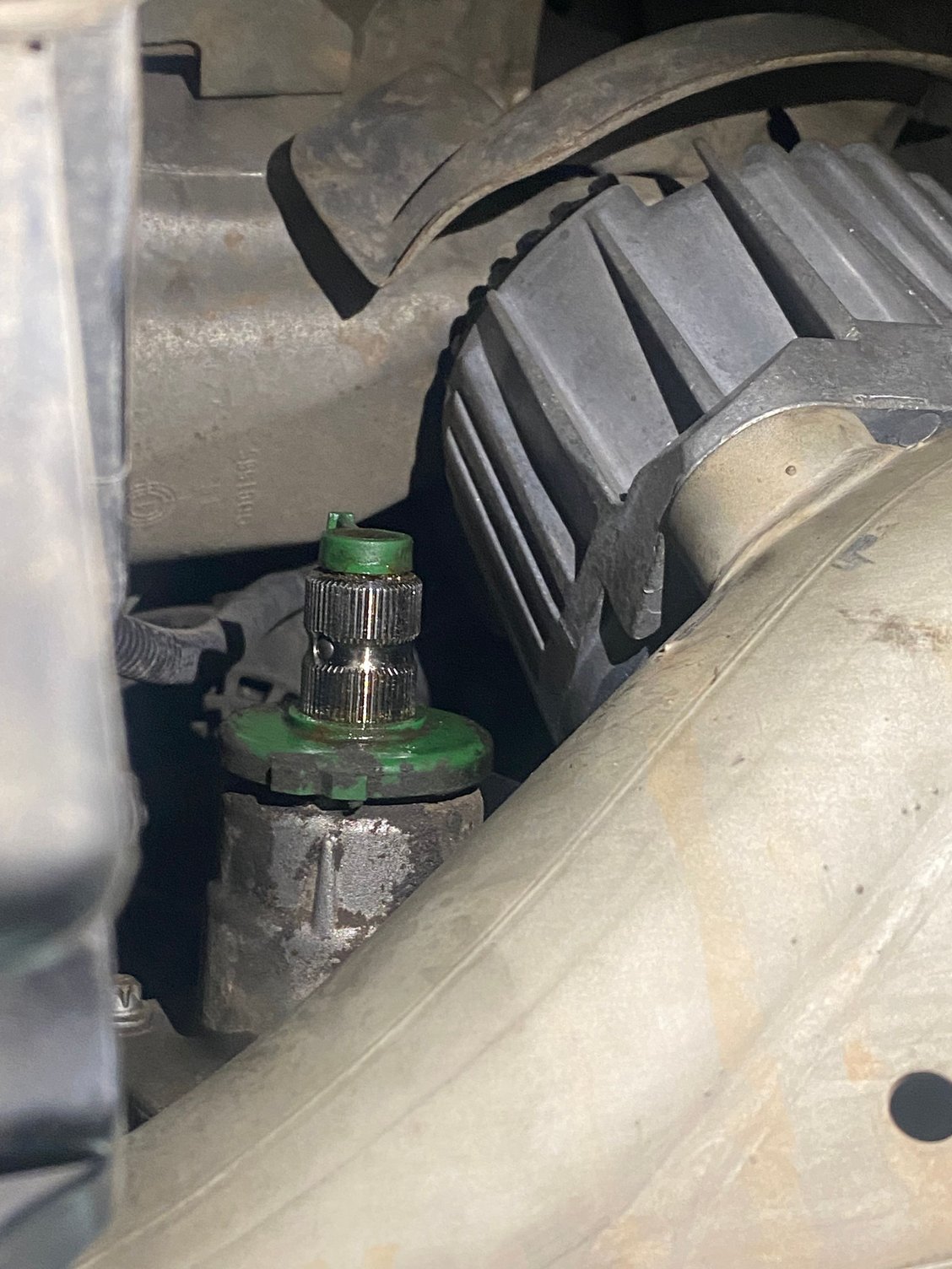

This was the exact part he removed from steering assembly to access driver side mount👇🏻

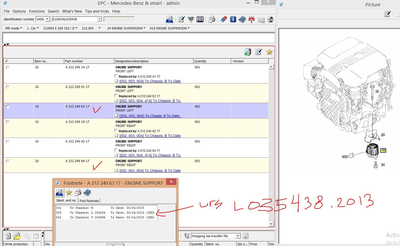

Your mount is Febi right ?..........or you have swap for MB genuine one ?
You only asked at this post but never share the final conclusion : https://mbworld.org/forums/e-class-w...mber-both.html
If you are on Febi which you claimed is the same P/N for both, while the EPC I showed you has 2 different P/N based on genuine MB mount........
your Febi could be part of the problem, perhaps due to height difference or whatnot.
Or the steering link rubbing your exhaust system.. maybe. I have no clue on OM651 W212 engine bay lay out.

I installed Febi mounts, they were same as the MB genuine ones. I got to know this when the mechanic removed the old MB genuine ones from the car. I suspect steering coupling because the mechanic centred the steering but didn’t locked it with a tool in the center like alignment guys do, and when he removed the coupling car was on bay lifted the steering must’ve turned a bit (I couldn’t see it as the car was lifted) and when he re installed it the position must’ve been a little off center and that could’ve caused the problem.

> Spline's fine!
I have removed the other side of the steering column... the splines positions can not be mismatched.

Removed both sides of the steering coupling and reinstalled it. Tire pressure is also fine.

If you get under the car while a buddy turns the wheel, can you see where the rubbing might be happening?
