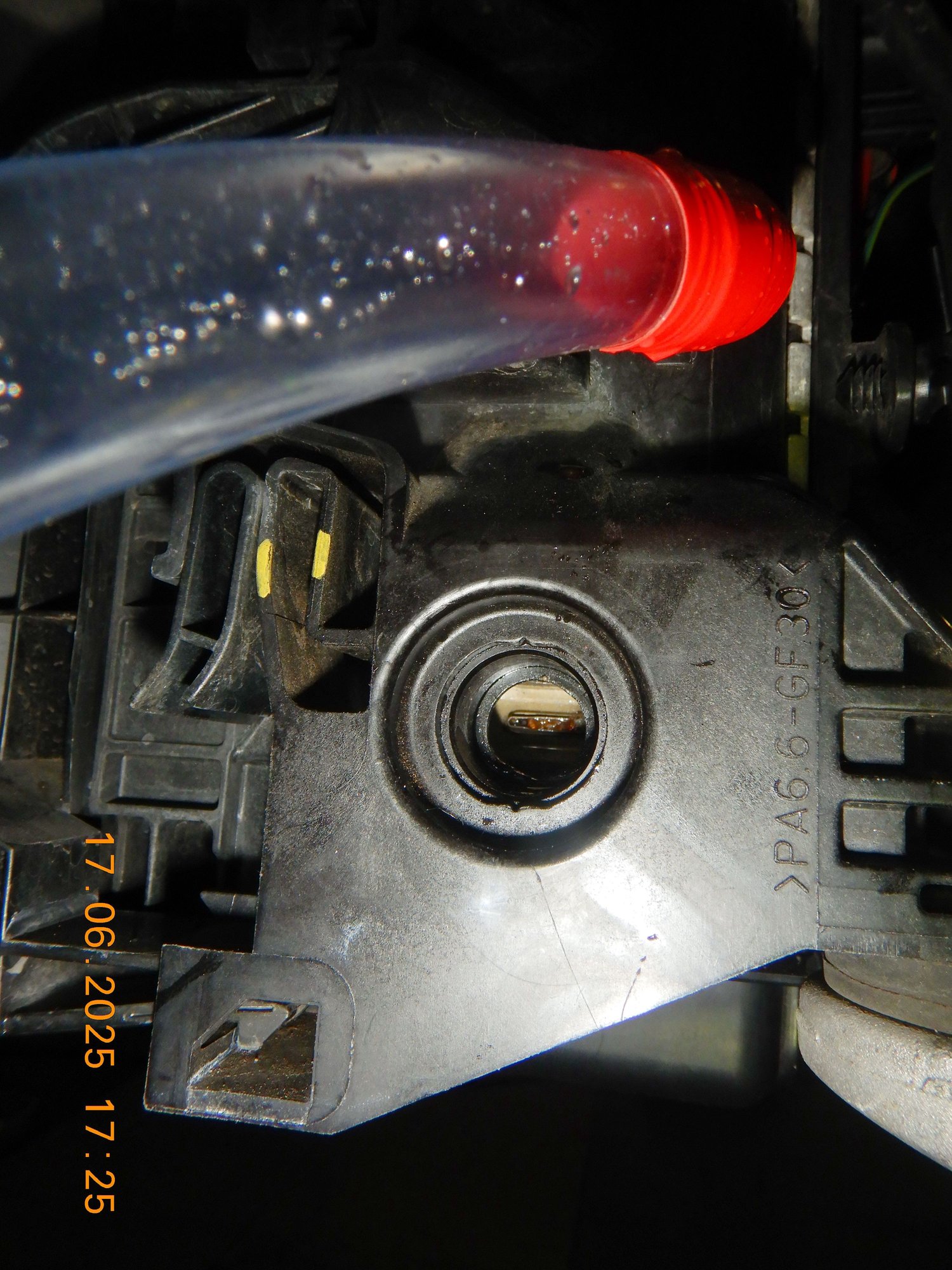

Old Jul 18, 2025 | 09:58 PM
S-Prihadi's Avatar
Joined: May 2018
Posts: 6,600
Likes: 6,547
From: Jakarta-Indonesia
130kMi: time for summer maintenance.
The tiny hose between radiator and expansion tank has a check-valve built-in. Get a new assembly.
Up for debate is the engine Bk-2 rear coolant pipes. Firewall elbow is No2 leaker.
Replace now + flush or replace heater core circuit.
> BANK2 VS HEATER PATH
@S-Prihadi Surya, do you recall if 100% of bank2 coolant must circulate out through the heater-core right?
Meaning when heater-core is plugged up Bk2 gets limited/zero circulation, right?
Need a new heater or a bypass surgery.
Yes, heater core always get bank 2 coolant output.
M276 has no stop valve of any kind.

Coolant Flush
Originally Posted by omer.zdm
you are definitely right,
that’s why before I start doing any repair, I will begin by doing a coolant flush/cleaning and go from there.
any other advice about what I can do more?
Appreciate for response
Update:I opened the radiator drain plug from underneath to drain the coolant, but only a small amount came out. The coolant reservoir didn’t change at all it didn’t go down even a little.
I am assuming the pipes are clogged?
Old Jul 21, 2025 | 08:15 PM

Were you able to pull out the entire drain valve ? Black plastic thingy, below :
Also open the black/white coolant reservoir cap ( as vent ) when draining coolant from radiator bottom drain valve...

As noted above, if you didn’t open the reservoir cap, then the system will draw a vacuum with the drain plug out, allowing just a small amount to drain before it stops.
no I couldn’t, I only opened but didn’t pulled out.

Important Update
Thank you for everyone for your recommendations and helps.
As mentioned, I was trying to remove the hoses to see if there is any clogged because of the leak sealer I used in the past, and good and bad news is I found it....
The hose and the radiator was completely clogged because of the coolant sealer. And that was a good lesson for me never use to this kind of product.
At the end, I removed the hose and cleaned it completely, but unfortunatly the raditor is also clogged and I will get a new radiator instead of cleaning as a best option for my car health.
Thank you and never use leak seal product for your car.
