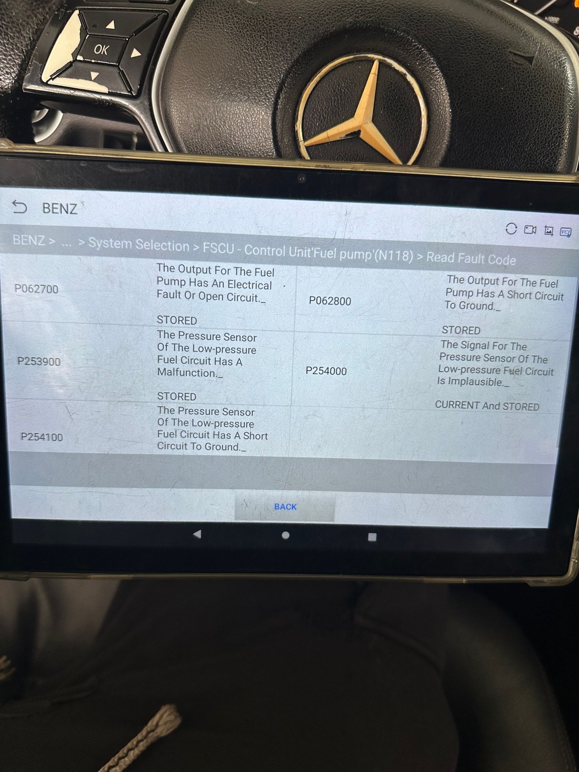

the issue happened again today, but this time before swapping pumps i had someone scan the car for errors and this was found:
After swapping the pump again, the car runs fine (until it happens again i’m sure)
i want to understand before buying a third pump.
Could this be solely a wiring issue like this scan says or would this errors also show up if both fuel pumps I’m swapping between are not good

it looks like you're fueling problems keeps coming back because replacing the fuel pump does not solve this.
Your fault collection makes it clear that your low pressure sensor circuit is having issues.
This failure is not a common occurrence.
The tank staying half-full on driver side is likely caused by a disconnected hose during the initial tank service. Inspect & reconnect.

it may just be that he is pumping air with tank level reported as half-full.
One side full + other empty = half Qty.
The sadle tank pump should be fixed up first.
Pressure sensor may be ok reporting a true low-pressure when pump sucks air on seemingly half-full tank.

If fuel filter and fuel pump is MB genuine, you may have wiring isssue from N118 fuel computer to fuel pump or from power supply to N118 or N118 is going bad.
Your fuel pump is already a 3 phase pump or still normal pump ?
