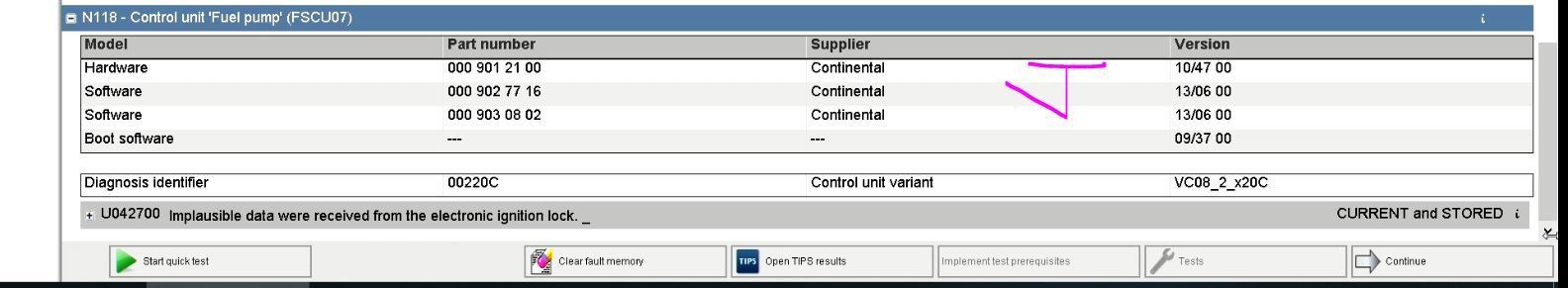

Has anyone had this message show up while not having the system? Any clues as to why and how could the cluster display a fault for a system it does not have equipped?

Low Bat condition can produce weird DTC, just like Power Loss.
So always note but ignore DTC after battery went flat and when battery charged OK, clear all DTCs and scan again.
If the said DTC never came back, that is Low Power./Power Loss caused.

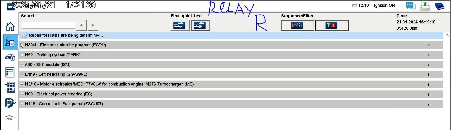

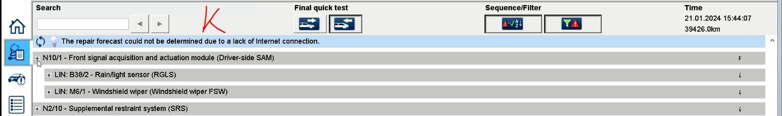

Here is an example of me plugging off a relay on purpose, I wanted to see how smart the modules are.
Relay J removal. Ignore my soft DTC for alternator/starter. I disconnected my alternator LIN on purpose.
Relay K removed
RELAY R, a very upstream relay powering a few relays downstream of it.

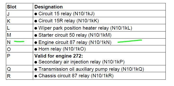

As I finally found the time to look into it I found some interesting things. Now I started with the fan turning on for a couple revolutions. Unplugged the fan, the current draw still appeared but was down from 0.450 amps to about 0.250 amps. Checked the fan connector and I found I have constant power on the fan power line. Checked the relays in the engine compartment but none of them seems to be responsible. To me it is not logical to have constant power to the fan especially with how big the fuse for it should be. Looked over several schematics for the relays but can not find a dedicated relay. Is it a separate relay or is it combined/ named in a weird way?
The other thing I found was when the car wakes up relay N turns on. Tried unplugging it as well but the consumption was still high. What module turns on said relay?
Fuse Box Diagram Mercedes-Benz E-Class (W212; 2010-2016)
As there are other electronics behaving unreasonably like the cluster turning on and off while the car is locked and is sometimes flickering while changing gears I am thinking of taking it off and unplugging it as well.
Had some DTCs about the front driver door window switch not being learned but it relearned normally and unplugging the door module still did nothing.
The most odd thing is that when walking around the car when everything is locked pulling on the trunk switch imitates the consumption and all other complaints like turning on the cluster display, turning on the N relay, the fan does its couple of revolutions, the consumption goes to the one I was previously measuring (about 0.450-0.500amps). It being a switch and not a mechanical lever seems reasonable to me to be waking the car up. As I do not have the proper tools to take off the trunk liner I could not measure for short between the pins of the trunk switch but unplugging the switch itself did nothing and the car is still waking up.

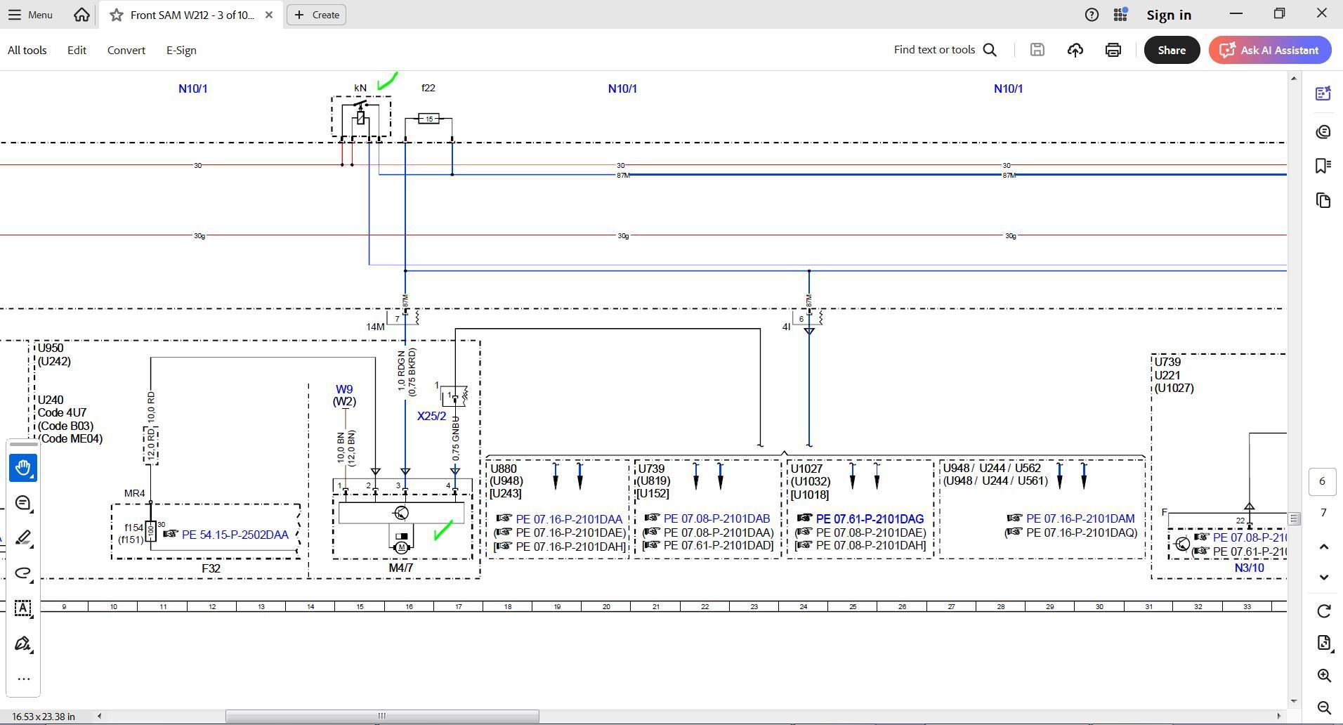

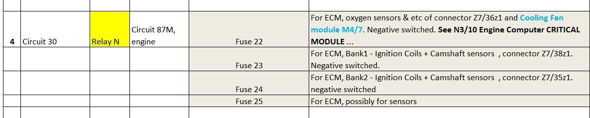

Relay N is Circuit 87M. That meant it is engine related.
Relay N also send signal to radiator fan M4/7. The power of M4/7 the two fat wires, the positive is direct fed from F32 fuse F154 or fuse F151, depending on our car model, option etc etc.
M4/7 fan has built in PWM speed controller, so if you asking its dedicated relay, it has one inside it and is a solid state, not mechanical one like relay N.
If in my car, W2212.065, Relay N feed power to these fuses :
You need to see the full copy of Front SAM ( 10 pages/sheets ) and the engine computer N3/10 schematic ( 2 or 3 pages/sheet ) specific to your engine type, which I beleive if 2010 is an M272 ...yes ?
To see what are the fuses served by Relay N. The basic design of MB for W212 engine fuses assignment is similar, albeit not the same between engines, but very similar.
