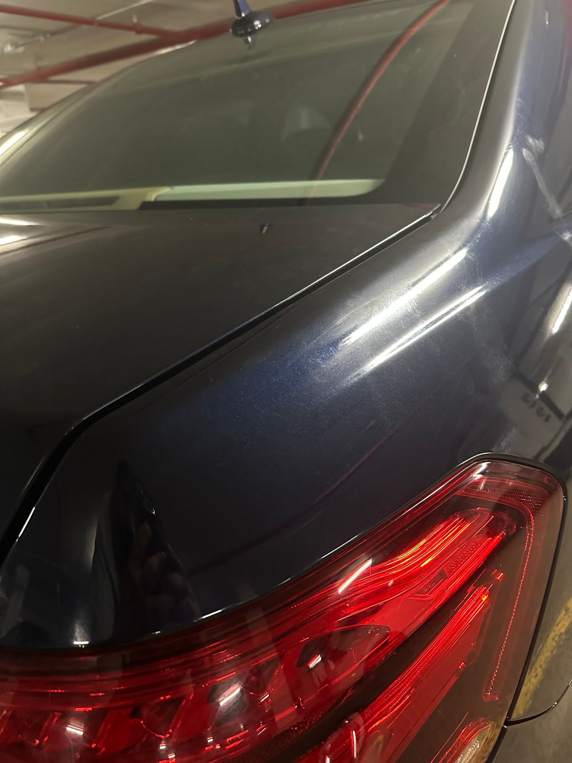

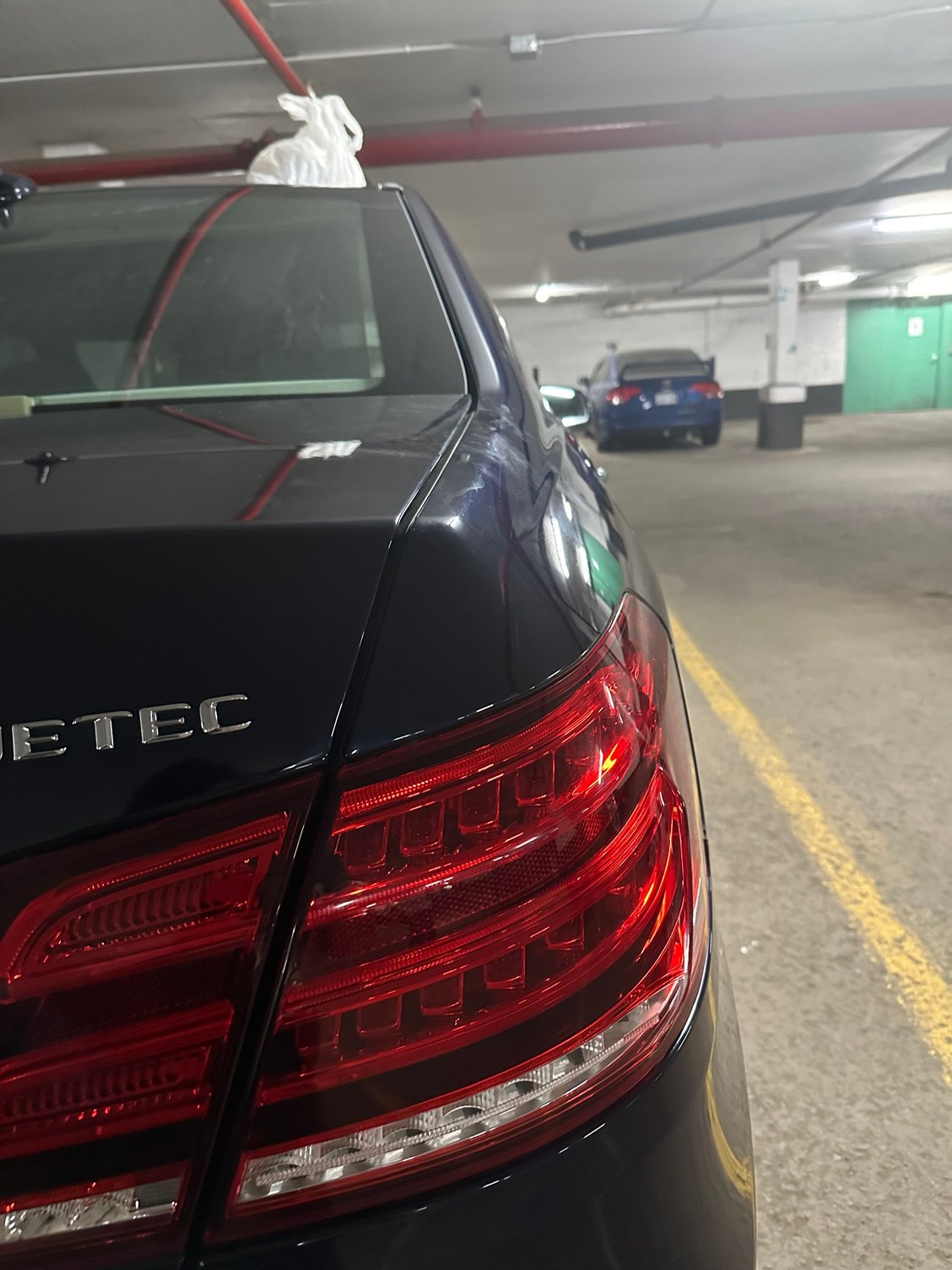

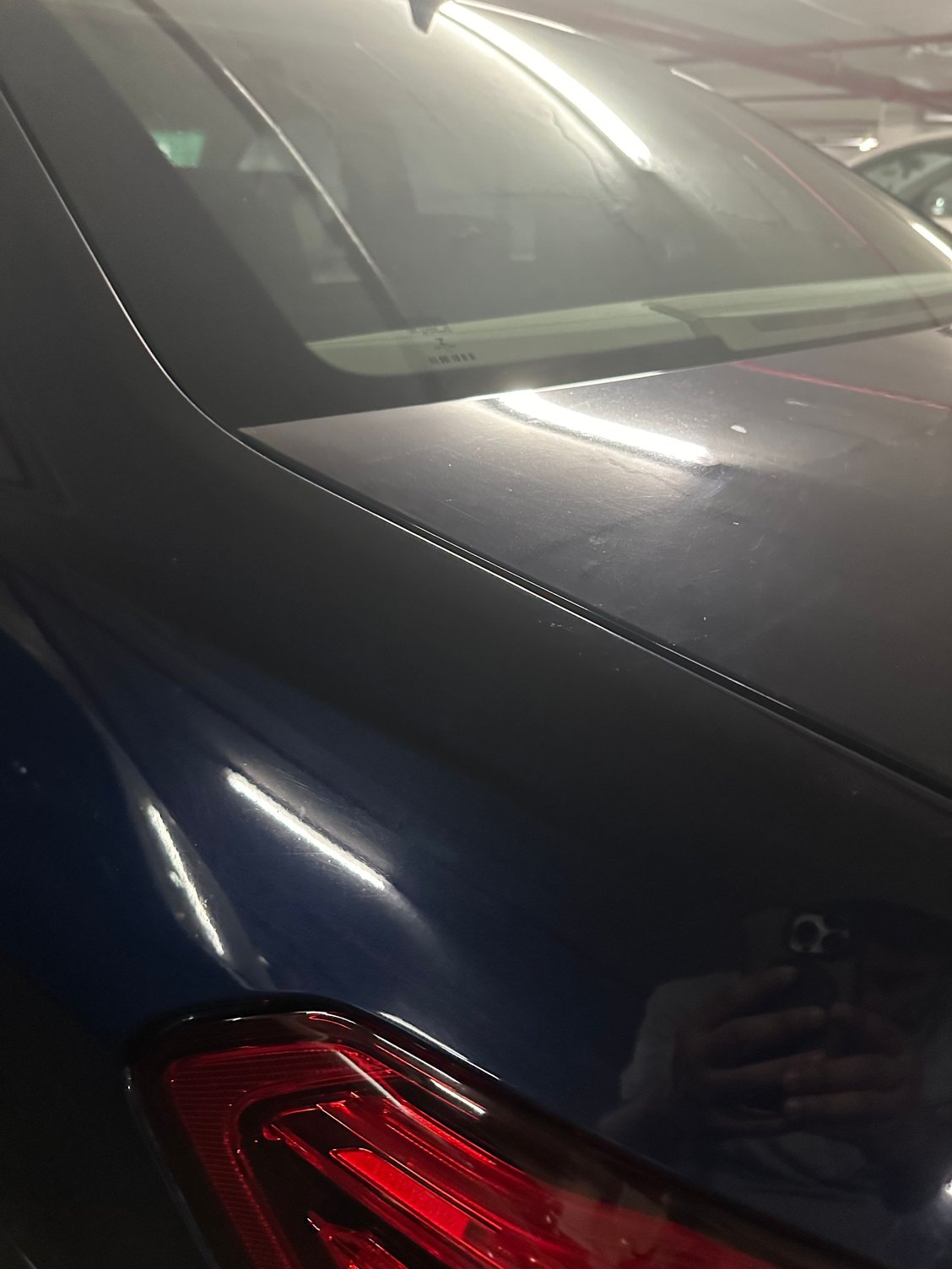

I recently bought E250 and noticed right side trunk is not flush with rear fender when it is closed.
Does anyone know how to fix this gap and make it flush with rear fender.
Attached picture of trunk
The other left side is flush and no gaps.

Unfortunately this didn't fix the issue. I screwed the stoppers all way in but trunk didn't move a bit. Previous only must have smashed the trunk when it was full and caused this misalignment. I did try to push it hard but no luck.
can anyone post what would be the real solution other than what was mentioned above?

Is this area of your deck lid bent or dysfigured? Is it identical to the left side?
Old Oct 6, 2025 | 10:31 PM
nebrou's Avatar
Joined: Mar 2014
Posts: 22
M3
no bents. It is identical to left side

If you have tried moving the stops and there was no change, your'e right trunk bracket is bent, replace it or have a body shop rebend it back into position

Has this car been in a wreck or collision? Either the trunk lid needs to go down on that side, or the car needs to come up. Any difference in ground clearance from one side to the other near the very back of the car?
Old Oct 9, 2025 | 12:04 PM
nebrou's Avatar
Joined: Mar 2014
Posts: 22
M3
I don’t see any previous accidents. All original body parts are intact and paint is original as far as I can tell.
I believe the issue is due to previous owner tried forcibly closing the trunk lid on oversized item that doesn’t fit trunk and something got bent but I cannot figure out what moved.
I do see the issue on other Mercedes classes as well but there is no clear instructions on how to solve it other than going to a bodyshop to fix it.

Yep. That was my next mention: If deck lid is fine then remove it and stand on the hinge arm and bend it down a bit.
Someone tried to forcibly close it with too much shlt in the trunk.

Can I try to do that while it is in place? I am just not sure which direction to put pressure on

It's your call. In a body shop, we would remove the deck lid.
I have done this before. Have a few years in a body shop. Misalignments are often corrected with brute force. It's even how we align doors, albeit with a special tool, but all it does is bend the door hinges/shell metal back to correct alignment.
If it was forced and bent in one direction, you're just reversing the action, whatever it is. If you're afraid to stand on it (don't know how buff you are, if you can push on it and correct it with upper body and arm strength, then have at it) use a tool. Make a breaker bar out of steel pipe or something and use Archimedes' Law of the Lever. This really isn't a big deal. You'll get it corrected, then in about 3 weeks you won't even remember it was a thing.

If I have the trunk fully opened which becomes on top of rear window and push it hard towards the rear window, would that work or make it worse?
