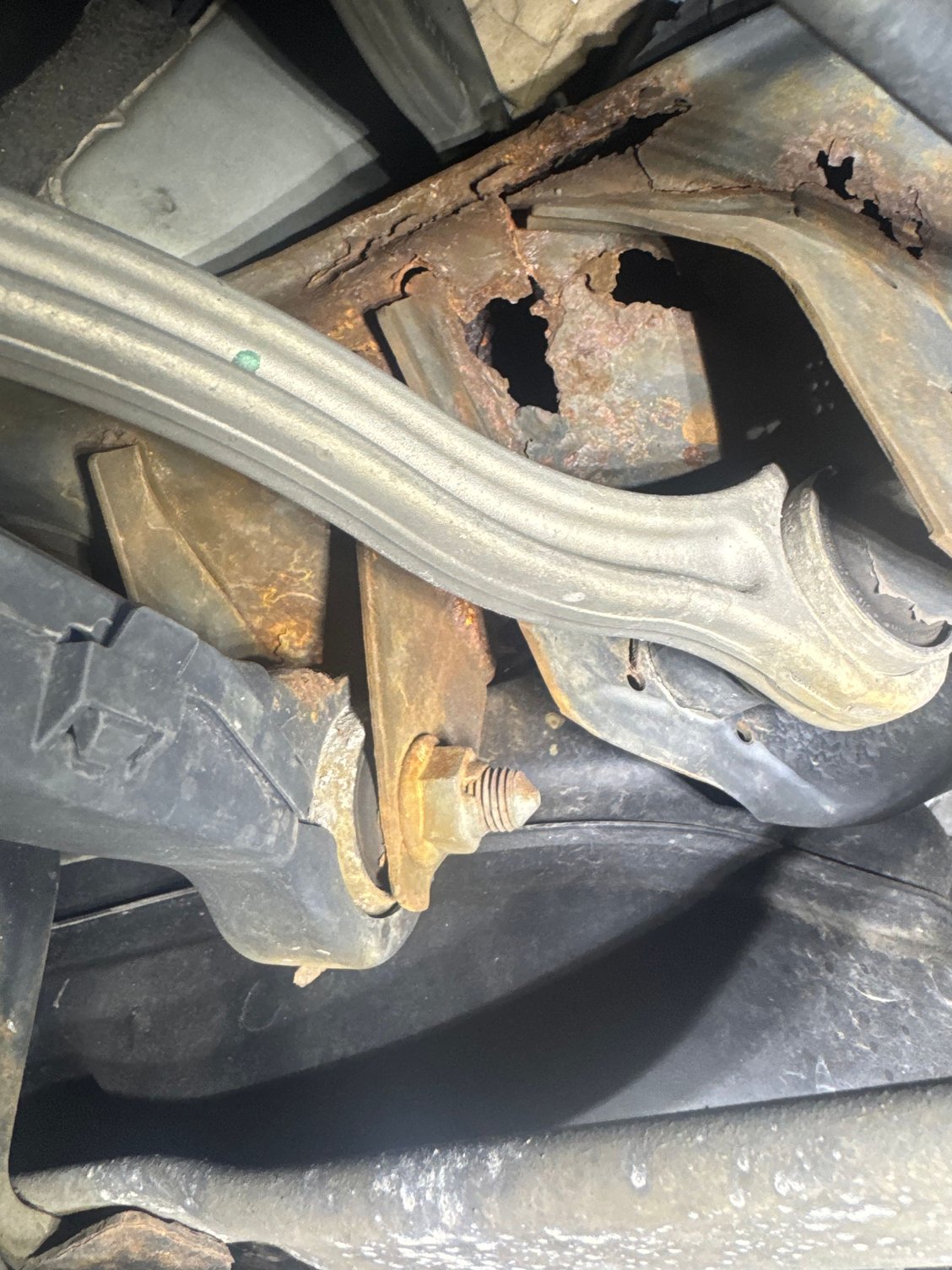

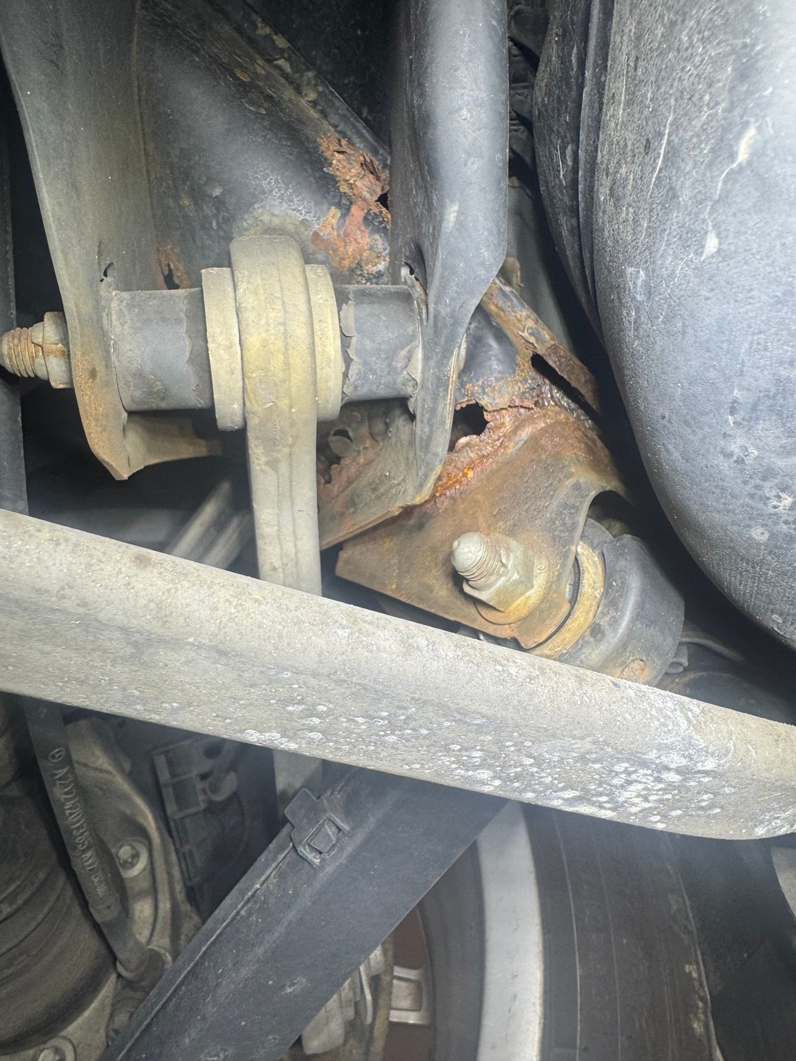

Picked up a ‘13 E350 wagon with ~145k mi from my stepmom recently. Regularly serviced, by dealer first 120k miles. Put on my lift for initial oil change, immediately spotted rusted out rear subframe! Clear as day, and ready to separate rear axle/suspension from rest of car!
Dealer replaced it no questions asked, even had the subframe in stock! ‘Happens all the time’ per SA. Nice to get bushings refreshed for free at 150k miles too!
