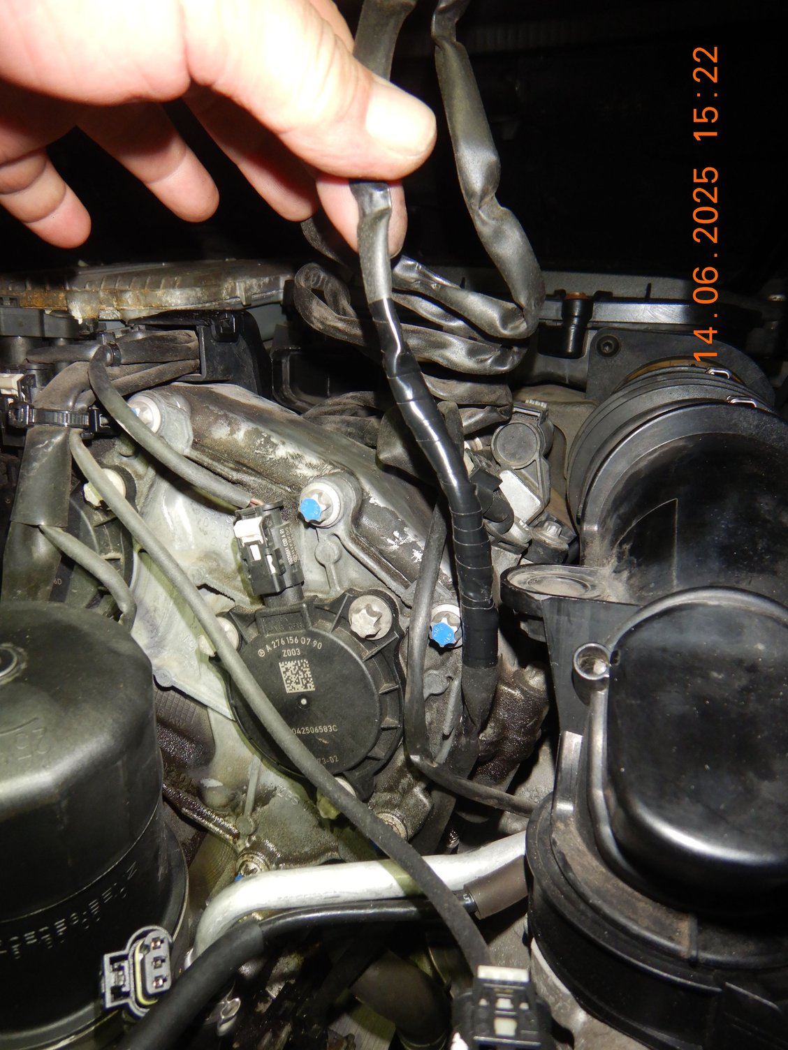

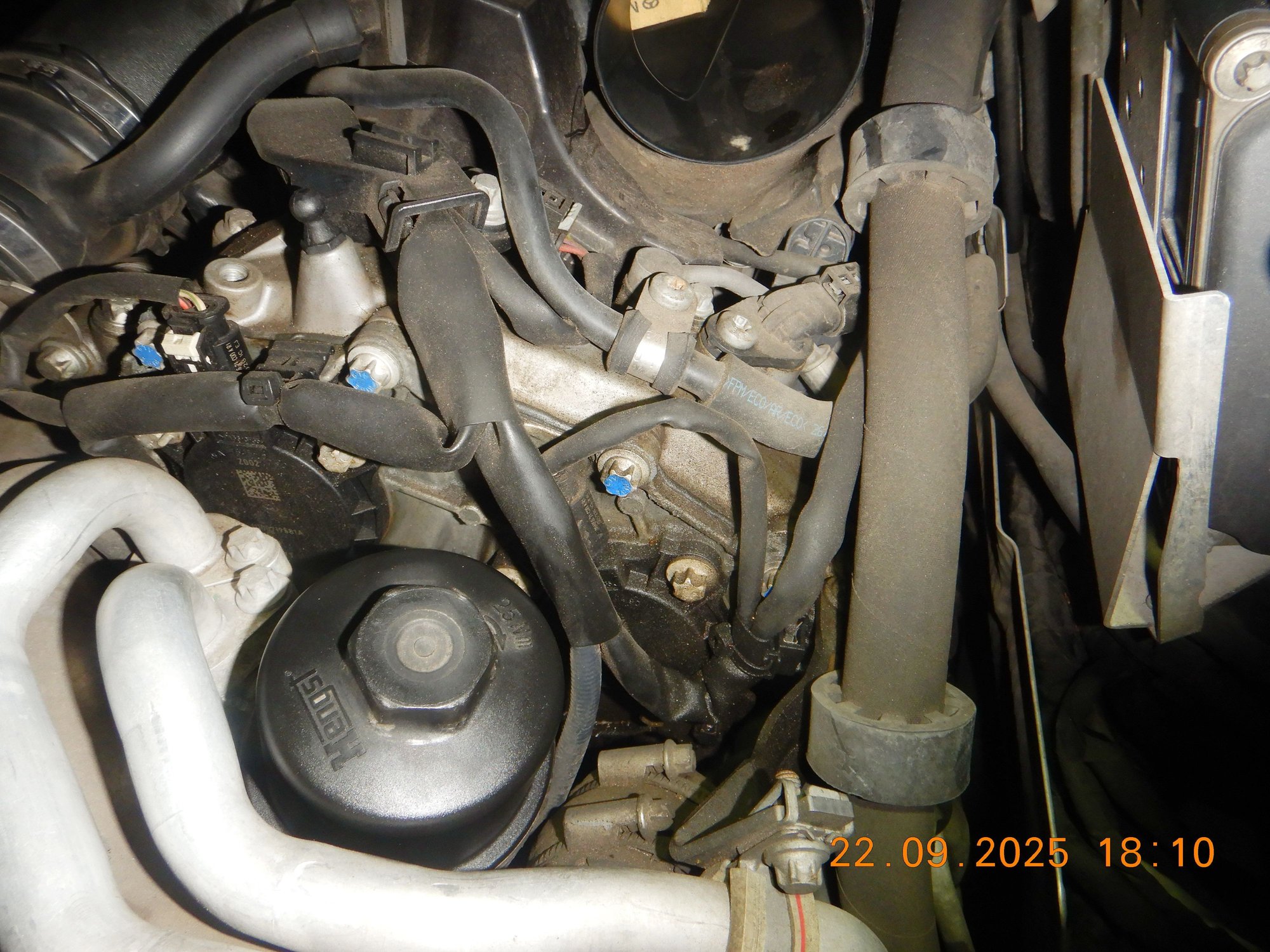

Hey all,
I recently bought a ultra clean 14 E550 with about 80K on it. Love how this car goes down the road and the plan is to keep it for 4 years which is maybe another 30K miles for me.
I knew the front of the motor had a leak and I negotiated that into the purchase price, now I'm trying to figure out just how much is leaking.
What's grimy:
Alternator
Front of block both sides
What's not grimy:
Turbo lines L&R
wastegate L&R
heat shields L&R
What I observe with my borescope and just looking close with a flashlight I see the left-most magnet is wet on the bottom, and the right most magnet is too. Looking behind where the cam cover meets the valve cover I'm not seeing much oil, the wategates, lines, and shields for the turbo don't look dirty on either side. The left side looks like it is leaking the worst, I was able to see the Alternator housing looking a bit grimy so the oil is getting down that way but I do not see oil pooling on the under tray.
Part of me is thinking to first try replacing the 2 O rings on the outer magnets left and right. Is that worth trying first or should I just pursue resealing both covers, replace 4 magnets and O rings?

80kMi with leaking timing covers are to be expected.
Suggested maintenance are:
  • swap chain tensioners
  • reseal timing covers
  • inspect magnet-solenoid leaks (o-rings)
  • test VVT Phaser locks
  • replace CPS + pigtails
  • Vacuum pump check valve
  • (thermostat)
  • air filters: engine + cabine
In addition to inspect/replace:
  • serpentine Belt kit
  • ignition plugs + boots
  • trainy ATF
100kMi... HPFP + PCV kit

The VVT window cover often get poor sealant job from MB.
Your leak is common, very common.
Not so easy to re-do the sealant on M278 due to high density of parts in front of the engine, but do it .
Read here : https://mbworld.org/forums/e-class-w...lant-work.html
BELOW :
This is 21,000KM M157 ( bigger sister engine to M278, very very similar ) of model year 2012
If enough teardown done, you will see much more oil leak trace under the mini VVT window.
If you can see oil there at the under carriage plate, that means the leak is quite bad. Mind you 21,000KM is only 12,000 miles or so.
GLE400 M276.8 , 3.0 Turbo. 67,000KM
If your leak is bad or get bad, your alternator may get fried from overheating due to oil coating its winding.
Worst case your serpentine belt get destroyed by oil and then get stuck at the main damper pulley and it will chew the crankshaft main seal and your can get your serpentine belt material into the
engine oil pump...yep, this is insane. 2 recorded case on M276 the serpentine belt entered engine from front main crankshaft seal.
Read here : https://mbworld.org/forums/e-class-w...-teardown.html
This is how M278 nad M276 looks like without much components in front of it. You can see where the oil leak will spread to.
Have fun fixing the VVT mini window.

My $0.02…I’ve done this job on my 2014 e550 coupe and my 2015 e63s sedan. FWIW, I agree that you do or will soon enough need to do the full job.
That said, there is certainly no harm in ordering the super cheap set of four new rubber o-ring gaskets to install on the cam magnets. It’s important as always to observe torque values on the magnesium cam cover plate bolts and replacing the one-use bolts is recommended. The pro tip for cost savings is to find the cheaper identical bolts sold for the BMW ($1/ea vs $4-7/ea).
Regarding the full job, I have bunches of pics and parts list if needed…just depends on how capable and comfortable you are with diy…and how much time you can have afford to have car immobile. The passenger side (US) bank is an easy-ish job, much less to remove to detach plate and reseal. The driver side is pretty involved. Some say they have found a way to avoid removing oil filter housing via specific wrench…I could not for my m278 coupe.
Also, your oil filter housing gasket WILL leak and need replaced soon, if not already. In order to remove it though, you WILL have to remove your turbo coolant lines, thermostat, upper rad hose. Your thermostat will break or is already broken, and you will find your water pump needs replacing. SO, as you’ve likely read already…it’s a pretty deep rabbit hole. For less than $1500 in parts you can do the full refresh and save $6-10k in labor from dealer…but it’s not an easy job
