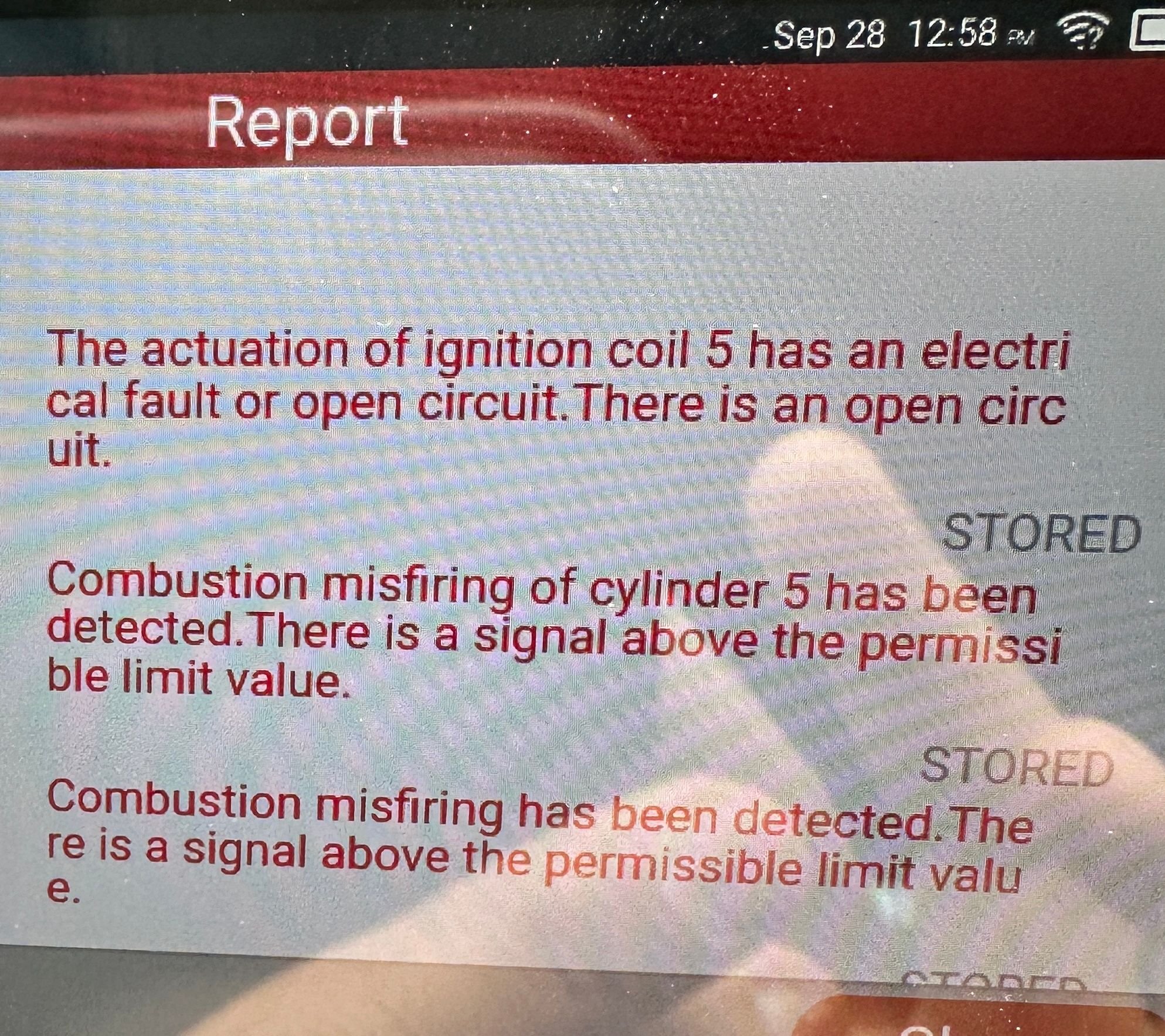

I was over 100 miles away from home cruising about 80 MPH when I felt car losing its thrust and sure enough CEL was on. I safely pulled over and ran a scan and sure enough another coil has died. I turned car back on twice but continued to see CEL staying on. I called a tow truck and when driver came, he asked what was the issue so I told him and showed him a picture of the scan results. After he uploaded car on truck bed, he told me there was no CEL showing, which he saw as he drove car up the truck bed. After he got me and car home, I started car and sure enough the CEL was gone.i ran a few errands around town and it’s still fine. In the last 18 months, coils 6 and 3 were changed. I have yet to change my spark plugs, so I just ordered 6 coils from FCPEuro and will do the whole job next weekend. Not sure how long it’s going to run before CEL comes back on, I hope just enough until coils get here.

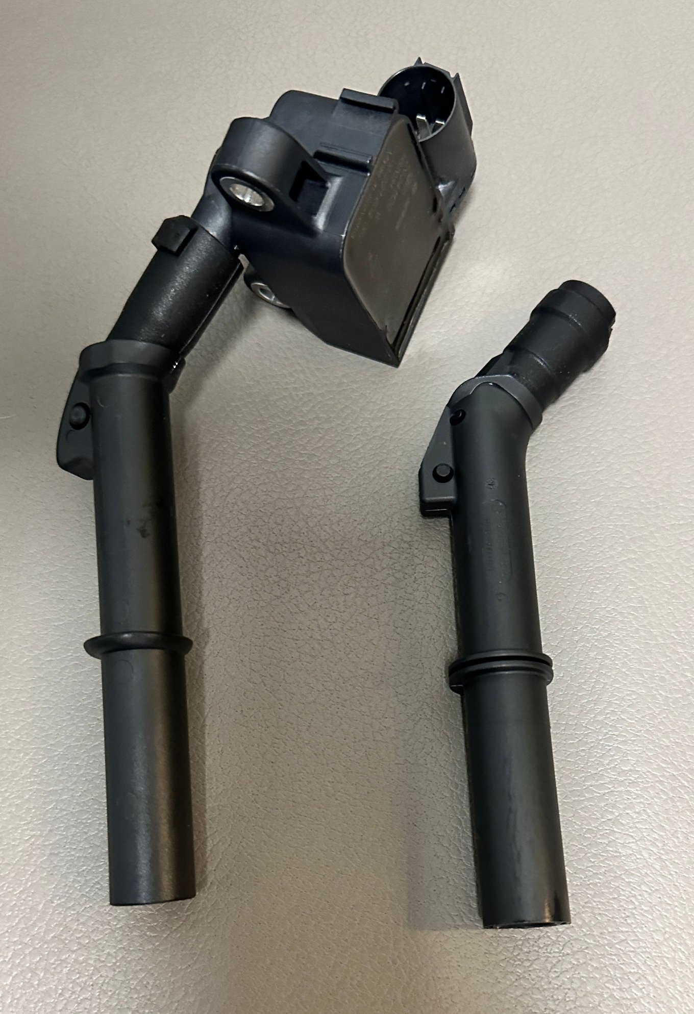

I'm getting ready to do my spark plugs replacement this weekend. Now, it's been a while since I changed those plugs on my former 2013 W212. I got the coils and the connectors and I'm not sure if the coils I got came with the connectors as one unit. Do these coils I'm showing here have their connectors? I ask coz I also got separate connectors, and it looks like coils have the connectors attached. I'm a bit confused.

this COP uses your engine harness. Be gentle & keep the surgery clean of dust contaminants.
Boots are a great maintenance part because they have built-in carbon pile... fragile!

Thanks, but my question wasn't answered, did I buy the connectors when they're already part of the coils I'm showing here?

Yes you're using connectors:
coils are built with male connectors
harnesses is build with female connectors

Yes coils generally come with the boot. You can also order them separately as a maintenance item. You can send back the boots you bought separately. If the dont have it, make sure to ad some dielectric grease to the boot.
