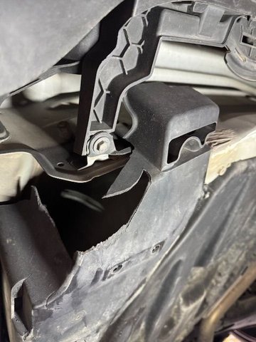

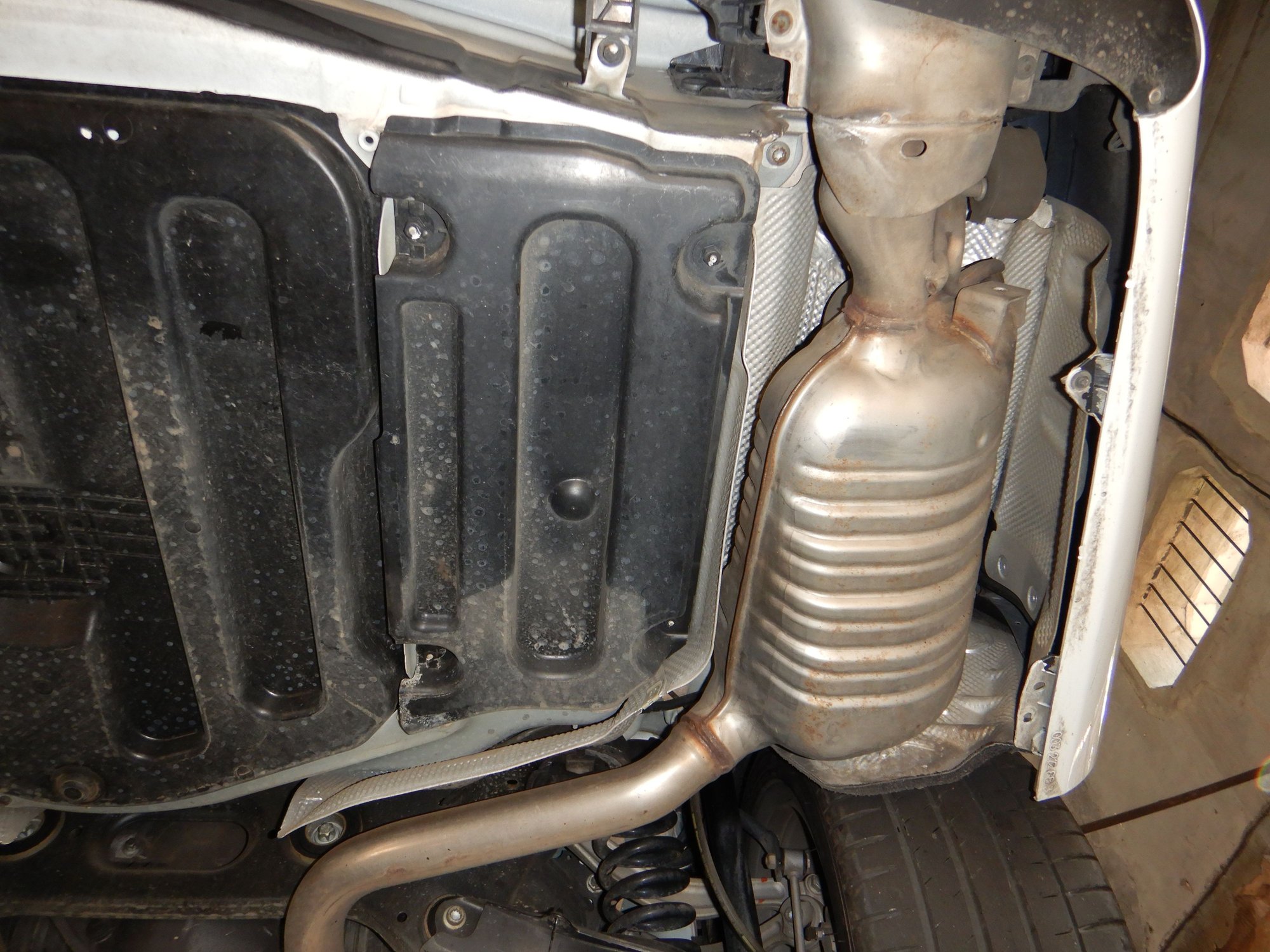

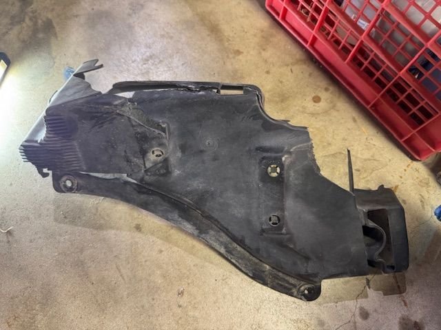

In working on my car, I discovered that this panel is broken. It attaches between the muffler and the trunk. If someone could furnish the part number, it would be much appreciated. 2016 E350 Sport, RWD LHD

Locating MB part numbers is never simple
try this MB parts distributor
This looks like the right place to get results, right?

You gave a 2008 Chevy truck VIN
2008 Chevrolet Silverado 2500HD 2WD Crew Cab 167" Work Truck
VIN: 1GCHC23688F164255

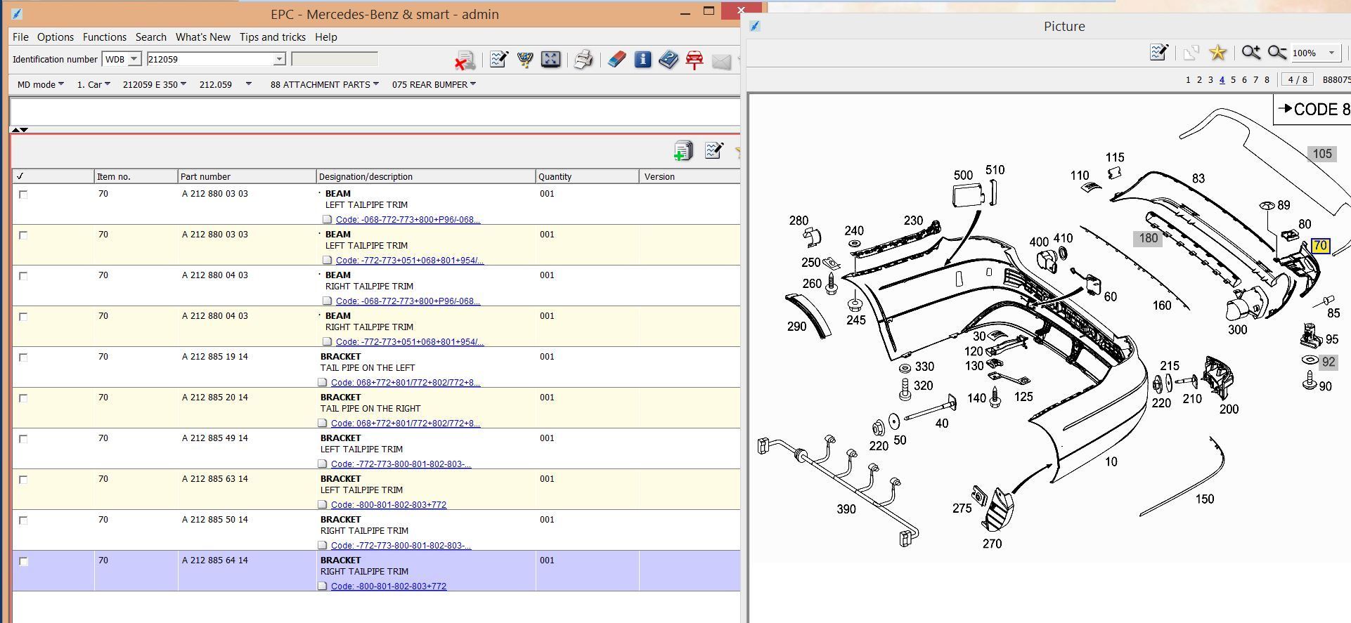

Is this the part #70 you asking ?
https://www.ebay.com/itm/125653237097
Give me ur Mercedes VIN, so that the correct item 70 can be pointed out.

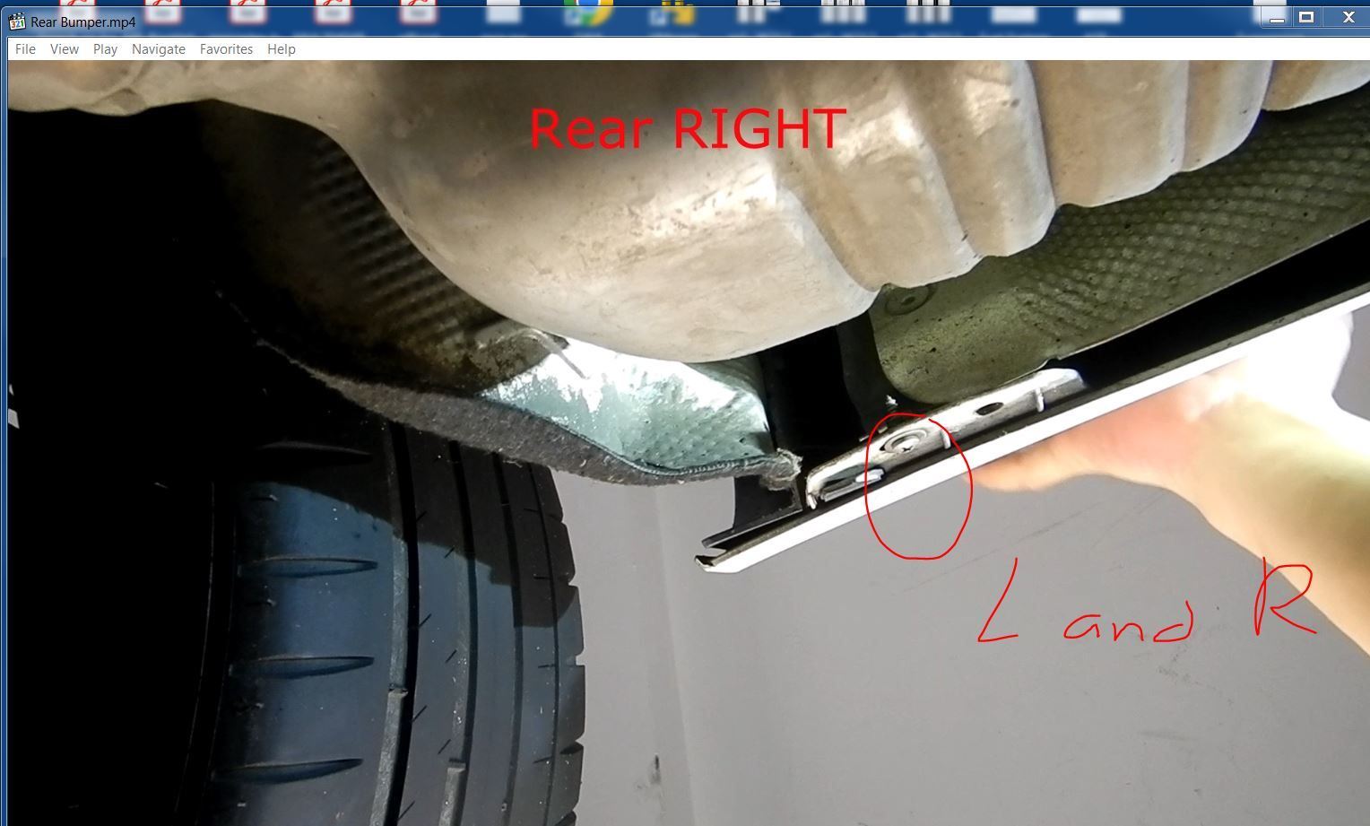

Yours being a 2016 year model probably is code 804, facelift. Mine 2014 facelift is code 804. Previous post I shown is Code 803.
Mine. RHD version.

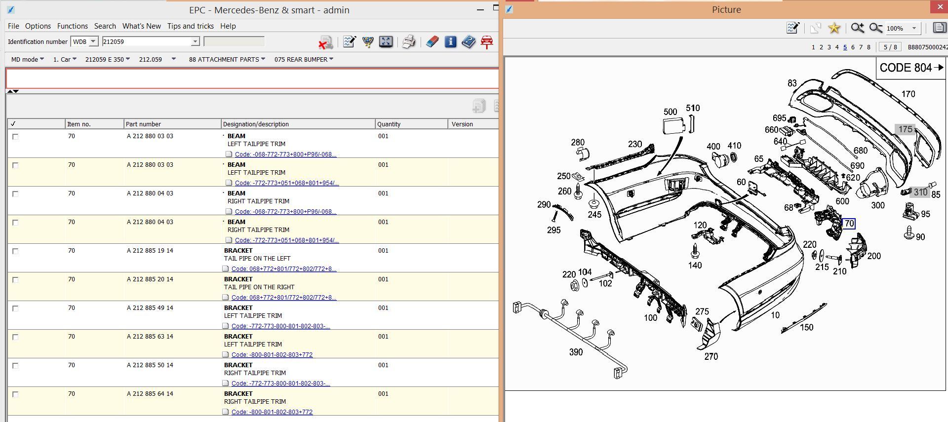

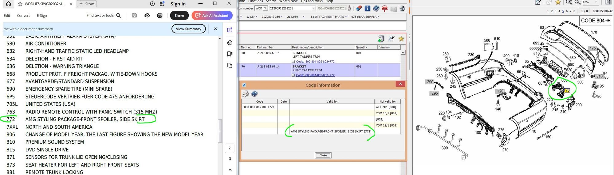

Okey dokey, your year production code is 806, meaning year 2015 built.
So we use Code 804---> after code 804, which is year 2013 and up, basically the facelift.
LEFT A2128856314
https://mercteil.com/mercedes-benz-a...are-part-vGLln
RIGHT A2128856414
https://mercteil.com/mercedes-benz-a...are-part-xbxN5

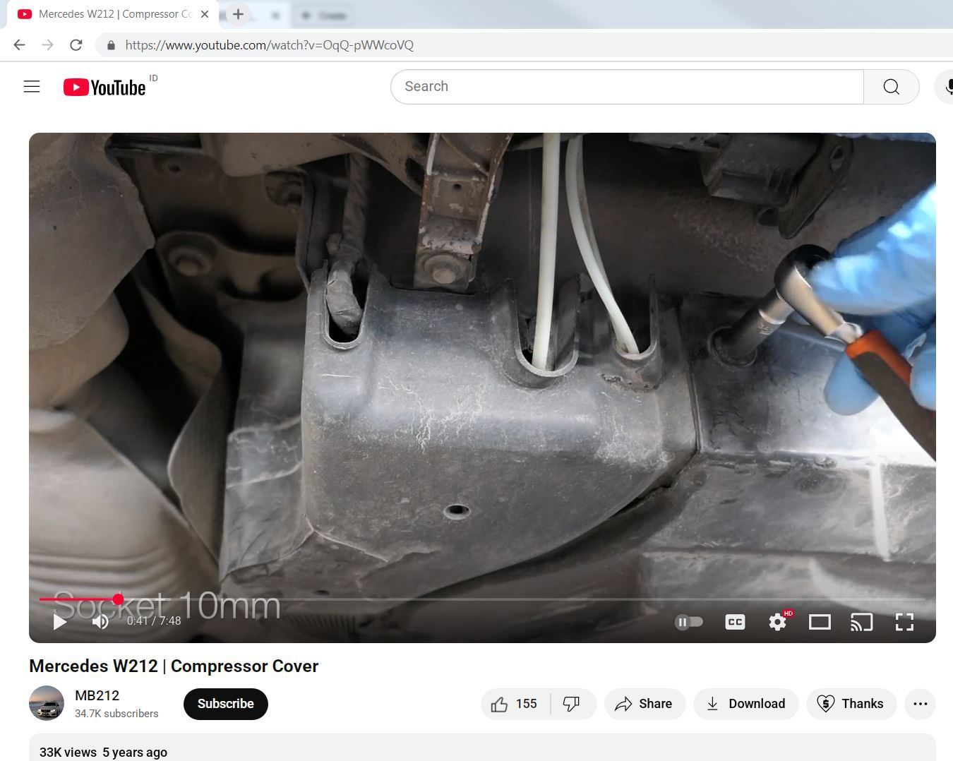

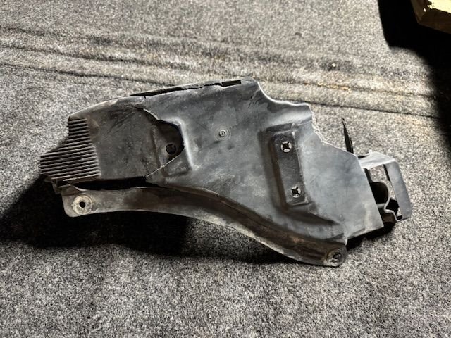

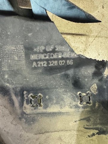

AI pulled the broken part out tonight, and there is a part number on it—A 212 328 02 86.
The part number is available here: https://mbparts.mbusa.com/oem-parts/...ver-2123280286, but the website says this PN does not fit my car. Indeed, a 2016 E350 is not listed. I sent them my vin # to verify fitment. Also, they say that the part description is COMPRESSOR and the parts group does show to be some compressor.
I guess I'll wait and see if they verify fitment.

Aha....

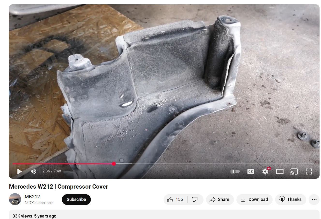

W212 airmatic version has compressor on LEFT side near exhaust
Maybe previous owner has once replaced it with airmatic version cover, it surely fit too.
The airmatic type cover is much bigger( a bit lower to ground ) than non airmatic it seems, no wonder you whacked it on the road.

That helps. As far as I can tell, it does nothing but take up space under the car. Your first picture in the post Oct 1, 2025 11:31 PM looks exactly like mine. I wonder if it has the same part number?

If you think the current damaged one P/N is good to use, order the same P/N and tell seller you take the risk of mistake and no refund.
As far as I know, official USA MB dealer would not want to sell/send you parts their EPC deemed as incorrect to your VIN. I guess they do not want hassle of return.
Here is the same P/N as yours, use it to compare to your broken one. Plenty of photos from all angle.
https://globalparts.es/en/splash-gua...b91q6AeLPtj9zl

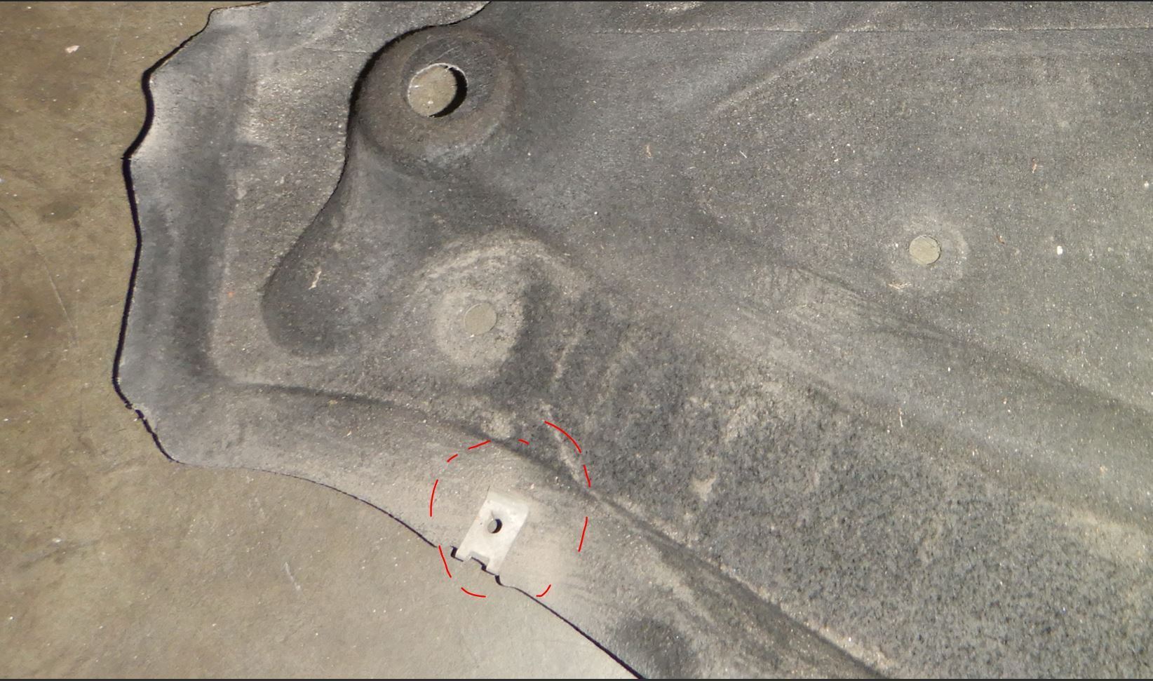

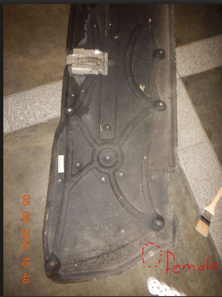

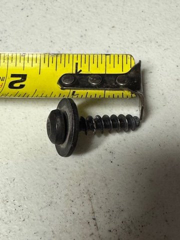

One more thing. There are 3 of these large black screws. I do not remember where they belong. If you recall, please let me know.

Metal screws or nylon nut with wide flange ?
A photo of them on you hand would be nice for size perspective.
Old Oct 4, 2025 | 06:49 PM
Sunnyslope48's Avatar
Joined: Apr 2016
Posts: 457
Likes: 151
From: Phoenix, AZ
2016 E350 Sport 2WD

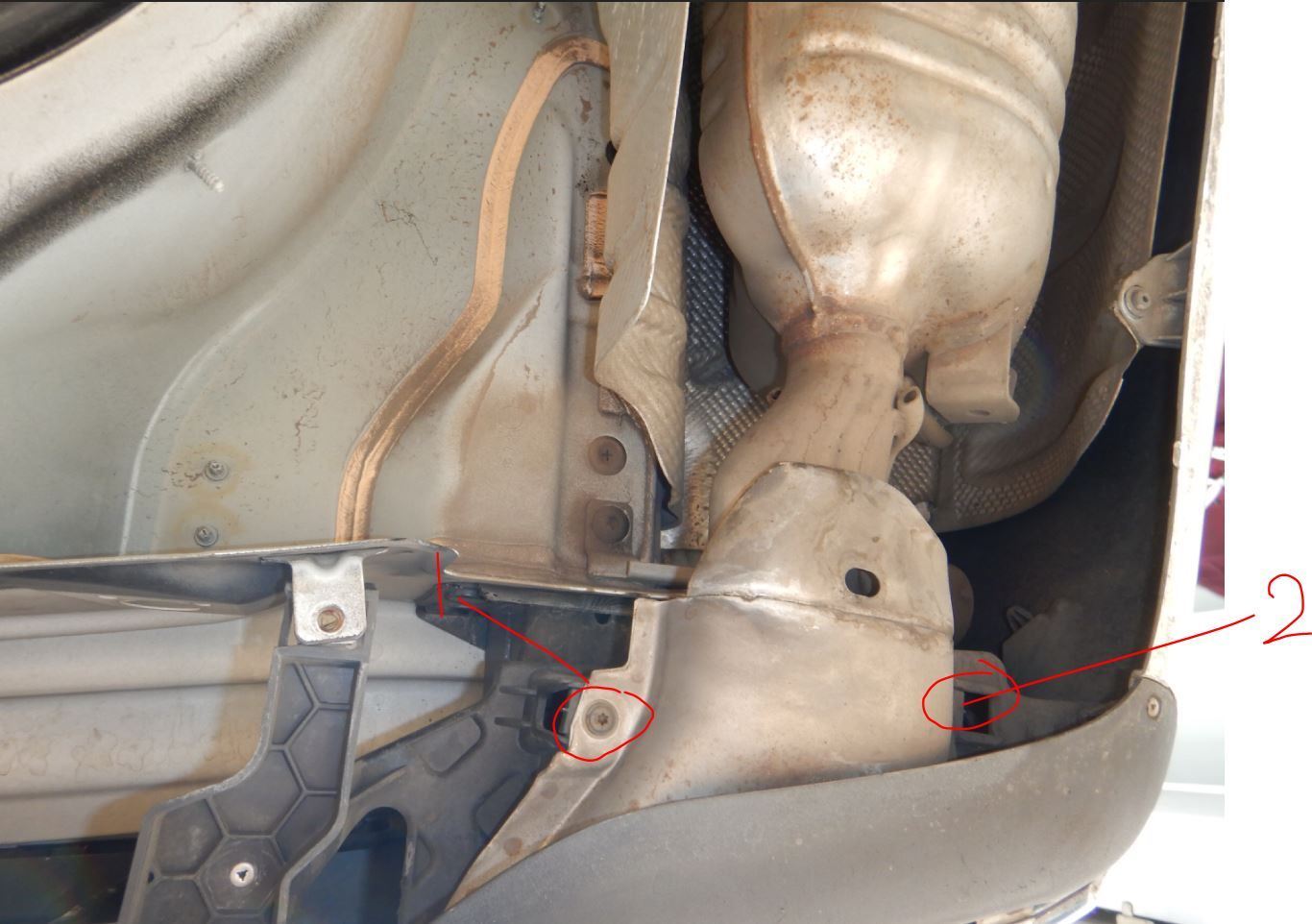

Oh, I attached the pic but it was dropped. Definitely metal screws and metal washers
Try again
Old Oct 4, 2025 | 11:28 PM
S-Prihadi's Avatar
Joined: May 2018
Posts: 6,600
Likes: 6,547
From: Jakarta-Indonesia

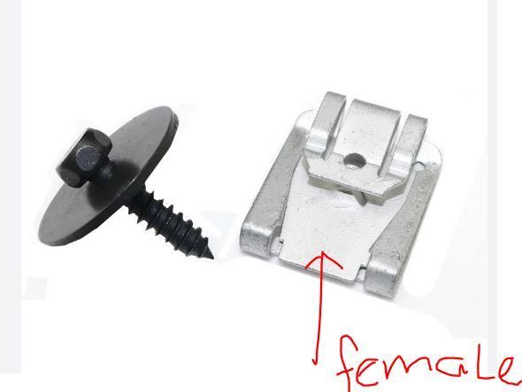

Ohhh, that one.
That one is very likely from below, that is always easily loose. Its the noisy screw...LOL.

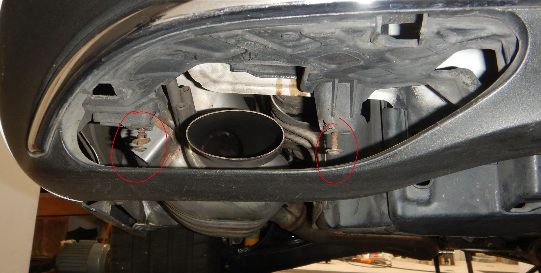

While you are down there, inspect the same "wood" screw of the exhaust tip decoration piece, 2 screws each.
Whenever you see these type of self tapping screw, guaranteed in our car its female counterpart would be plastic parts of the car or those cheap metal female clip like below
There is another location using that screw. But it is a bit smaller size. The sound/heat shield hairy black one, the longest one under the car.
The noise maker bumper to heat shield.... that is why that screw there is easily lost.
