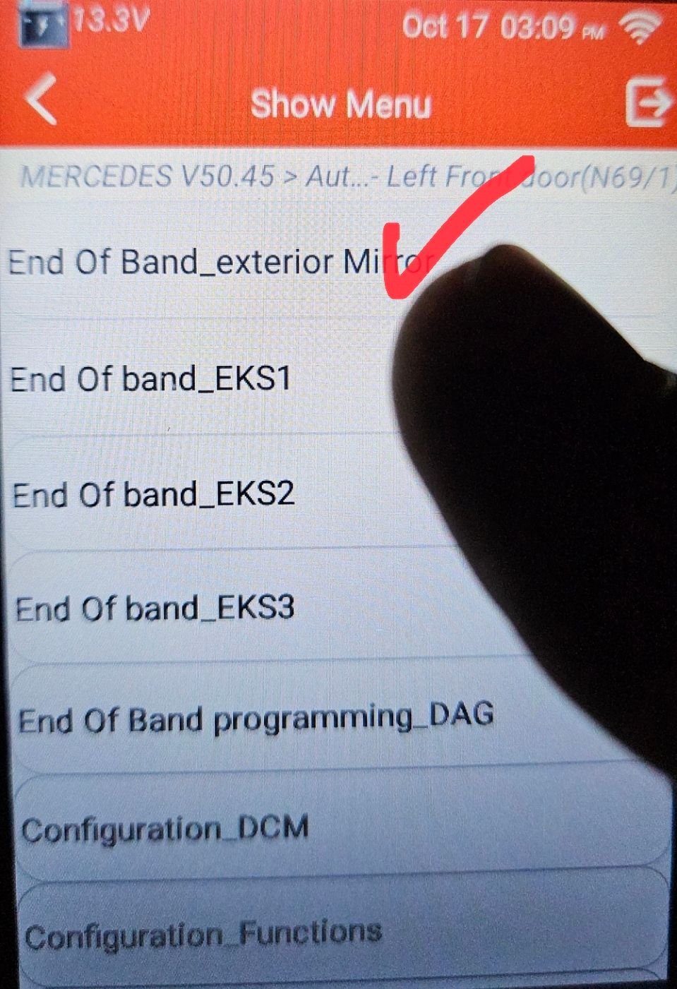

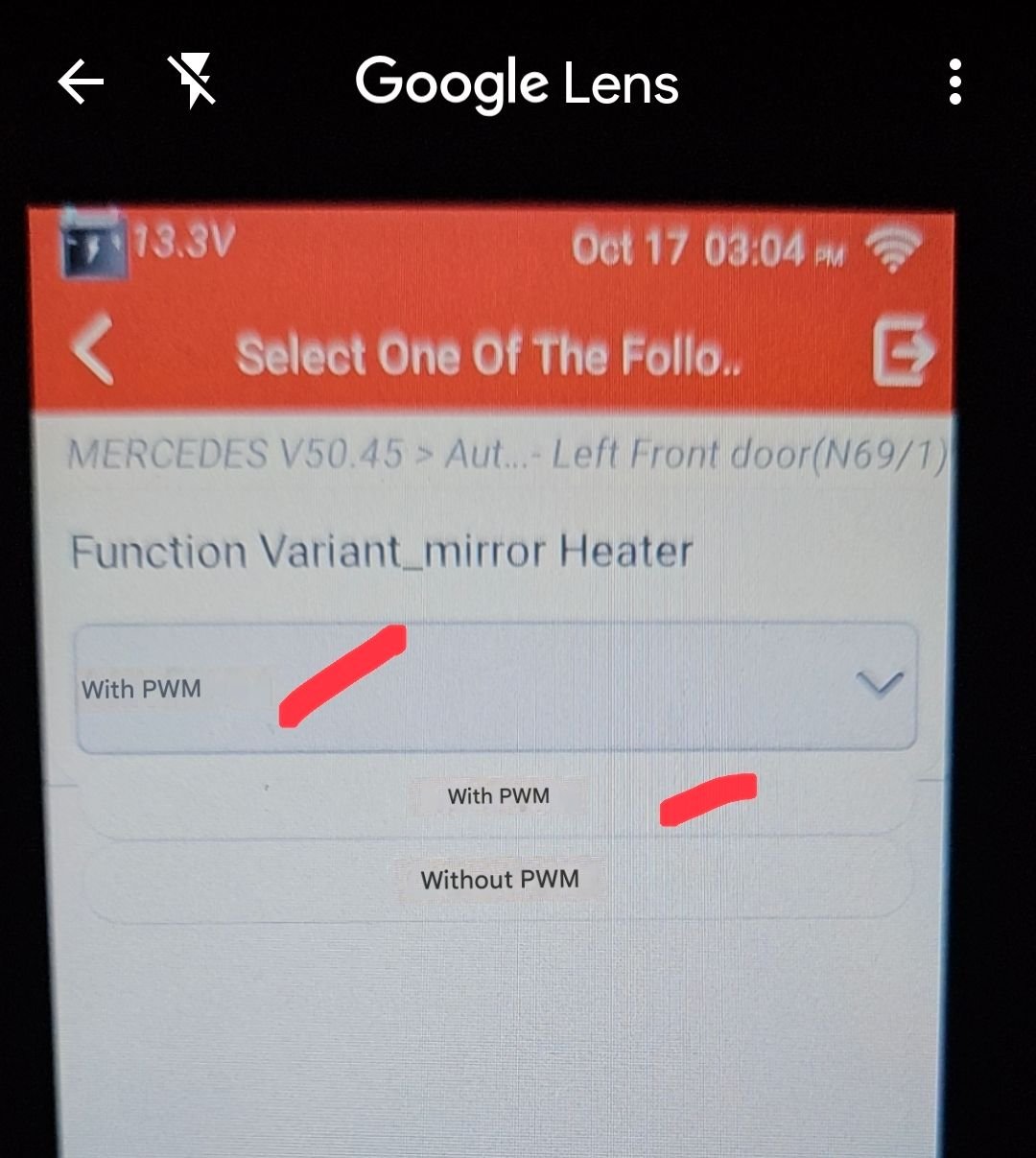

I took the time to revisit the DCU now knowing that it's controlled by "Rear Defrost" button.
Look what I saw...
PERMANENT is default value
The setting PERMANENT (default) threw me off
It should read "UNLIMITED" or "Rear-Defrost"... since we know mirror defrost is not actually permanently powered ON.
DCU can shut off heater after time out
MIRROR HEATER TEMPS
MIRROR HEATER TEMPS
Temps optional settings
Icant make sense of this setting besides Temp3 = (Temp1 + Temp2)
driver-side active options
There are available options to time out mirrors independently of the rear-defrost control.
mirror heater mode... PWM: YES.
mirror heater mode... PWM: YES. (DE translated EN)
Top level menu: modules selection
DCU Menu : Variant Coding
Variant menu:
Variant menu: "Ext mirror"...
personalized options saved ... All set!

Old Oct 19, 2025 | 01:15 PM
CaliBenzDriver's Avatar
Joined: Apr 2019
Posts: 11,923
Likes: 6,776
From: Silicon Valley
W212 MY'14 M276-3.5NA @75kMi
CUSTOM CODED OPTIONS
Originally Posted by Antoniio
What diagnostic machine did you use to code it? Thank you.
I did this using the LAUNCH cReader MB Elite
acailable around $125 or so.
Both SAM's, NTG, IC-Display... modules can be Variant coded.
Be sure to backup your own module before trying new settings. Every car use slightly different config.
