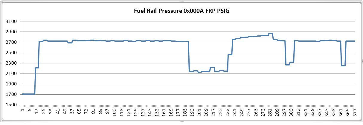

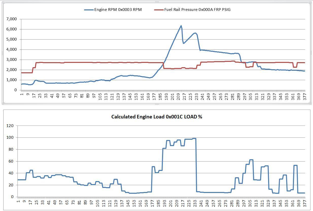

The fuel filter , the only fuel filter, is very small.
Do not wait for problem from fuel filter, as you may starved the high pressure fuel pump.
Internally, high pressure fuel pump uses fuel as lubricant, externally it uses engine oil.
Go to post #12 to see my not so dirty fuel filter vs new fuel filter pressure. Mind you my car is only 36,000KM at the most back then in 2022.
https://mbworld.org/forums/e-class-w...ml#post8568085
Quick summary
The HP fuel pump pressure vs RPM vs LOAD would be like below :
Yes, the rail pressure actually decreased when RPM goes high and load goes high.

Is it possible this is bad gas working its' way out?
I agree that while I should replace the fuel filter just for preventative measure, fuel pressure does not seem to be the problem.
I am wondering if I went and just did some good driving and maybe put some fuel injector cleaner in it tomorrow if that might at least "stabilize" my numbers a little more. They looked pretty normal just now.
However that does not explain bank 2 not going into closed loop.
It seems the GDI engine is more advanced than your iCarsoft scanner can handle. Other members have used it, I thought it had fair coverage.
Then I'd stick with OBDII fault codes if that all you can really count on.
Not replacing the downstream sensor is a great mode: rarely useful! Upstream yes helpful but not "downstream".

Originally Posted by Darel
I just went out and started the car again after letting it sit. When cold both fuel system status were "---". At about 110-120 degrees bank 1 went into CL. Bank 2 is not going into closed loop.
Recall that prior to the most recent CEL reset Bank 1 was always showing "CL-fault". Now I have a good "CL"
Now, as I was sitting there watching the numbers, they started matching up bank 1 vs bank 2. The trims were very close to one another, the voltages and currents of the o@ sensors made more sense left to right.
Thinking back, this car gets driven very rarely since my wife works from home anymore. I think the last time I put gas in it was August. My wife filled it up on Thursday.
I assume this battery is fully charged, correct? Like, it's sitting on a battery tender all this time when it's not driven? If not you could be chasing all sorts of random computer based ghost faults that have nothing to do with anything.
Fuel filter is still a good idea at this point. But so is always storing the car with a full tank of gas. Extra room in the tank is mostly air and corrosion waiting to happen. Consider those best practices.
For your specific issue, I'd say run a full tank of gas and Chevron Techron through it and see what happens before you do anything. Maybe dump the fuel filter after the Chevron runs through.
These are old cars. My '06 sits a lot. A couple months ago it threw a CEL. I suspected coil packs just because I know they're due. One got replaced a year or so ago (less than 5k miles) and I didn't have time to do all 8, so I just did the one. Before I could get it to my guys and have them replace all the coil packs, the CEL went away. Do I know why? No. But I know the battery is full and the fuel filter is new-ish (with that new coil pack). Coil packs will wait until next spring maybe.
It's the price you pay for driving a better car with no car note. Charge it to the game.
