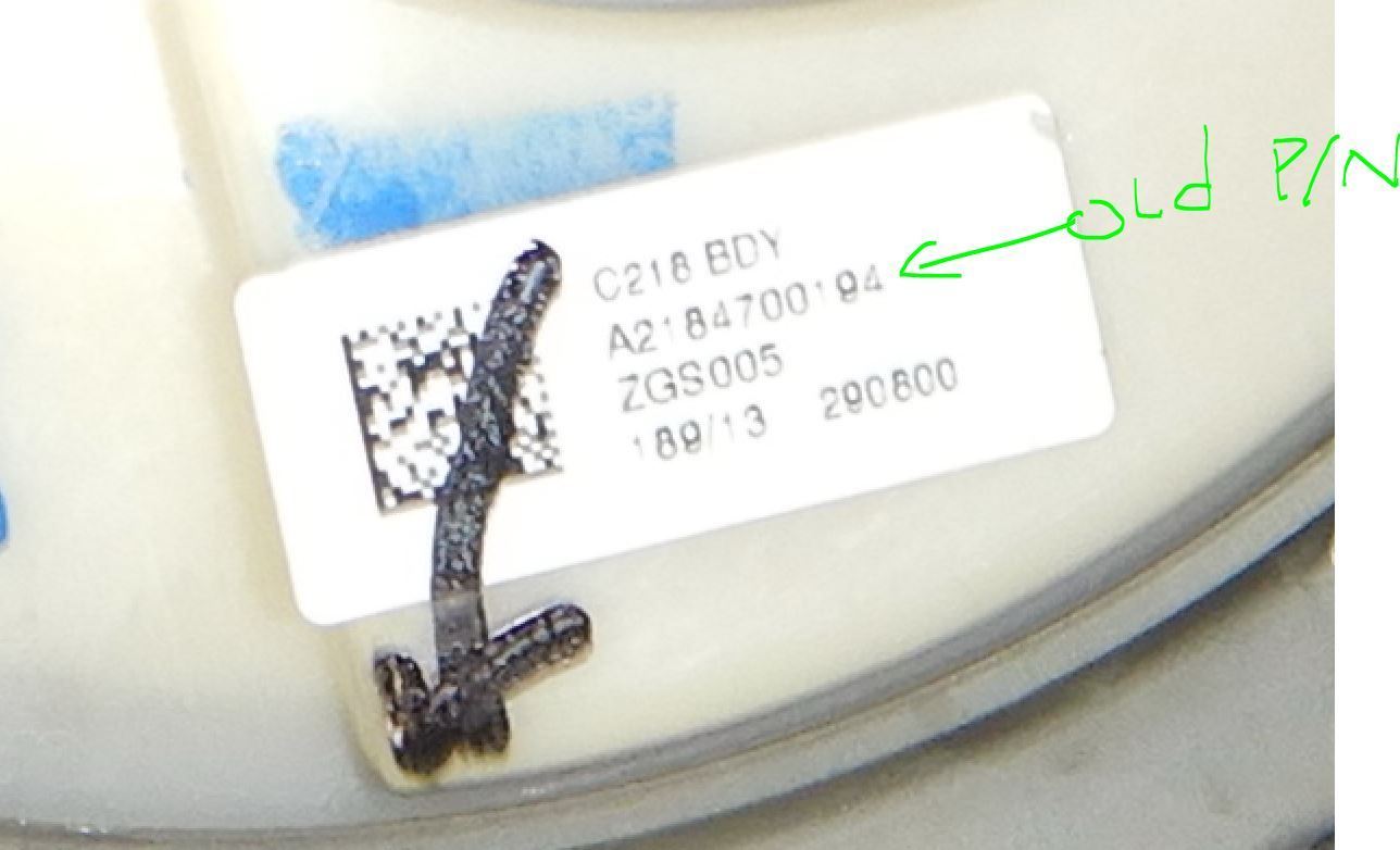

Those stickers mounted on the devices show the part number of each one. I'm in the middle of replacing those myself.

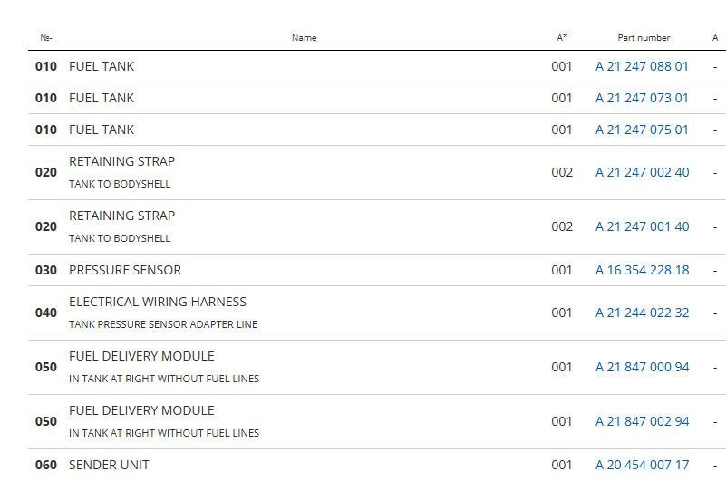

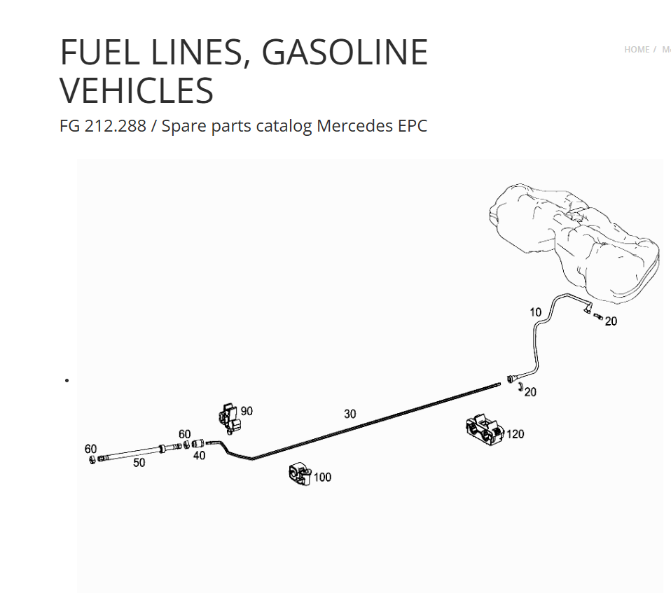

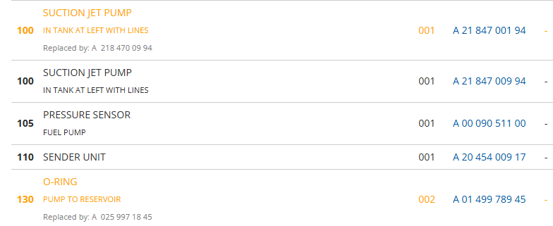

Your vin is helpful when searching for parts. Know which part# you need and then search for it online. FCP is not the best at listing parts that will fit your car since there are numerous variations. Example mine is a PZEV engine yet FCP only lists non-PZEV fuel pumps for my car, i have to enter in the part# on the website to even find the correct one.
Seems you looked and located the part #'s in your car which is what I usually do to make sure im ordering the correct part.
Theres only one fuel line that leaves the fuel tank and goes to the engine.
Without knowing your specific vin# I just picked a random W212 with M276 engine. I assume you have the M276 since there is mention of a HPFP. Diagrams below for reference. Im unsure what the question even is.

Well, I don't think this is the issue anyway so I'm just going to send it back. As far as the stickers, yes I know the part numbers are on them. That's the part number for the whole fuel pump, not the filter.

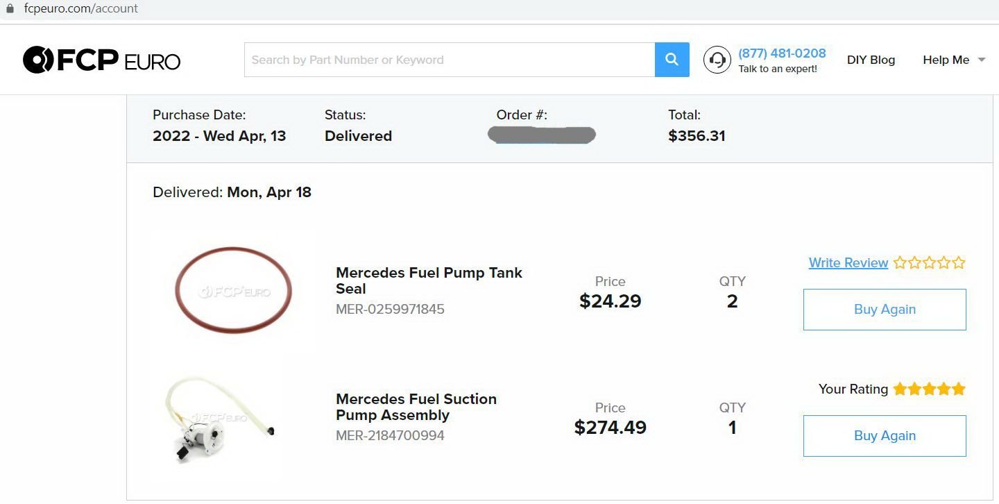

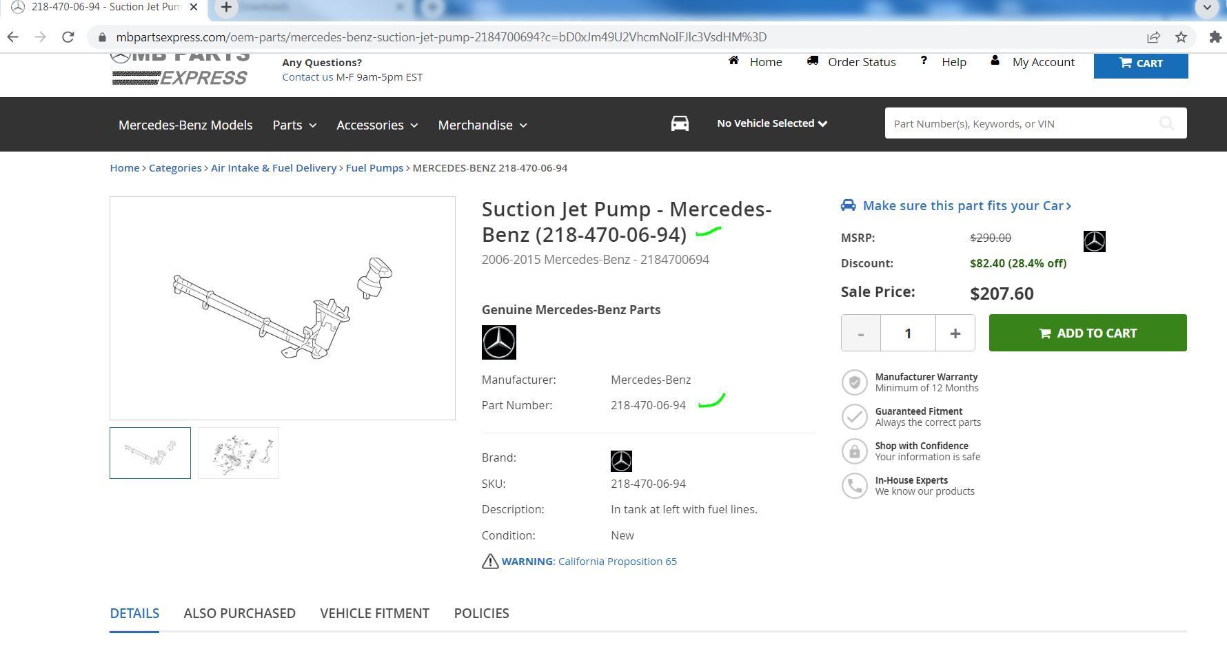

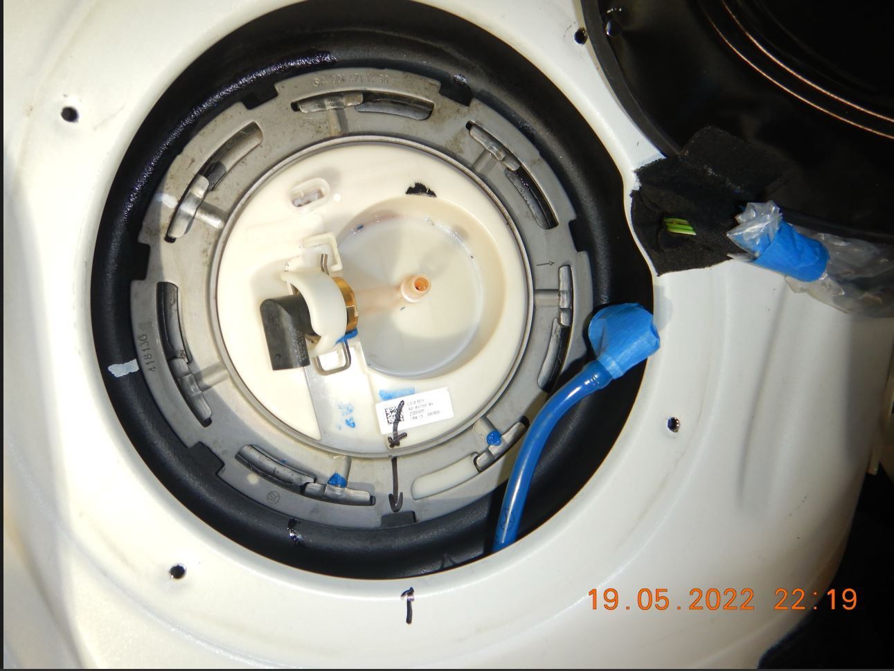

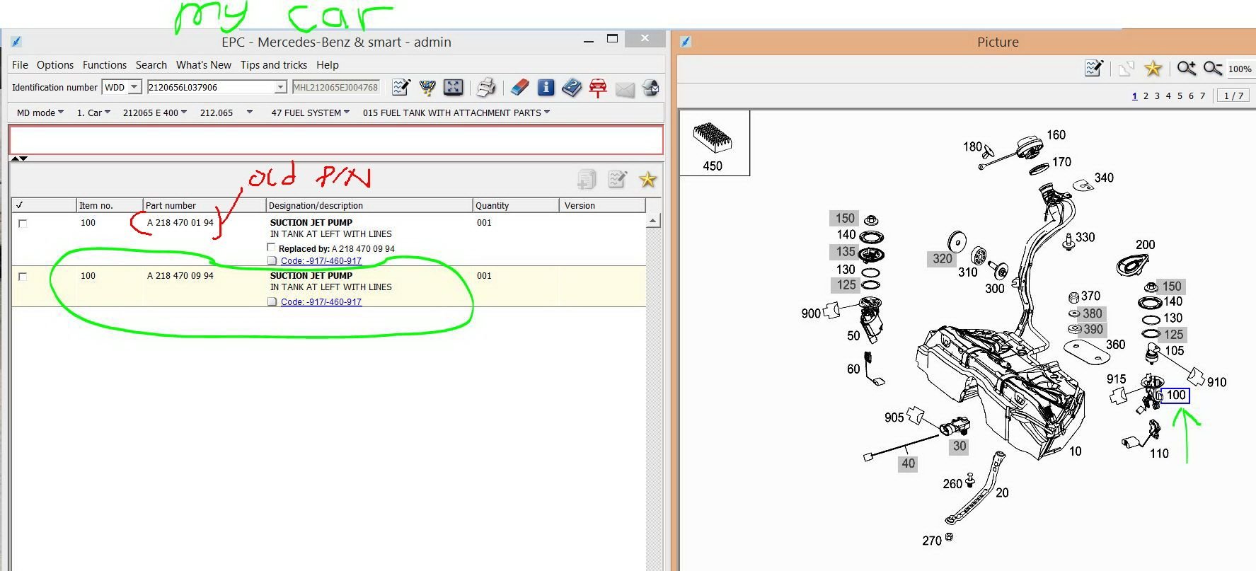

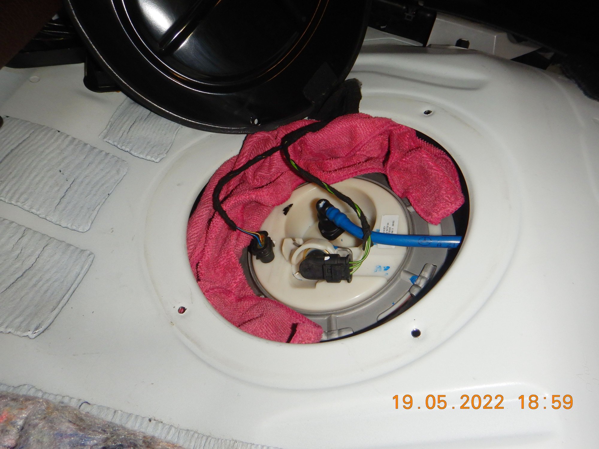

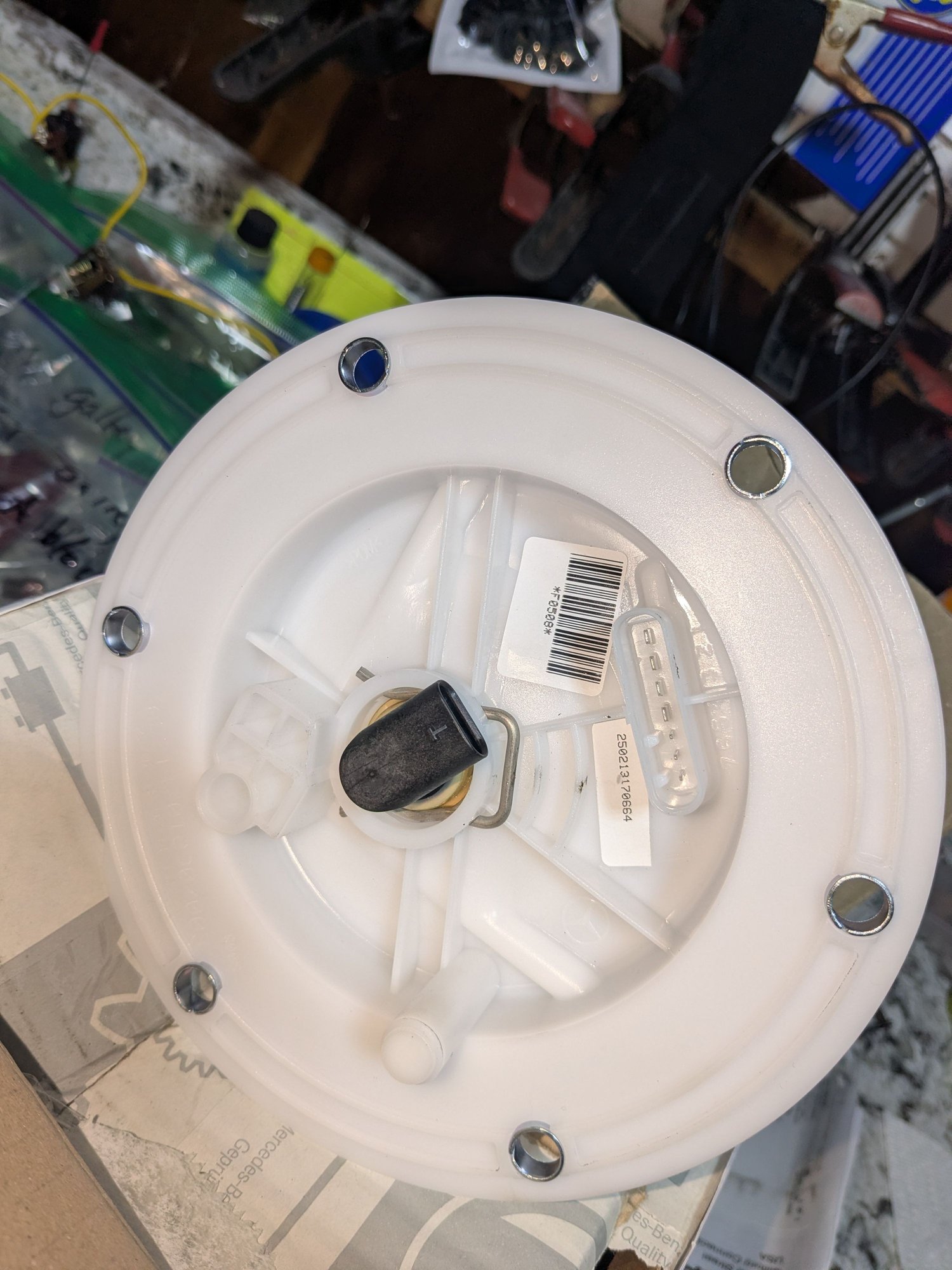

Why waste time going to FCP Euro when MB genuine fuel filter at official MB dealer is available and cheap ?
https://www.mbpartsexpress.com/oem-p...IFJlc3VsdHM%3D
As long as your car is US car, enter your VIN and they will match it at the final check out. They DO NOT export out of USA.

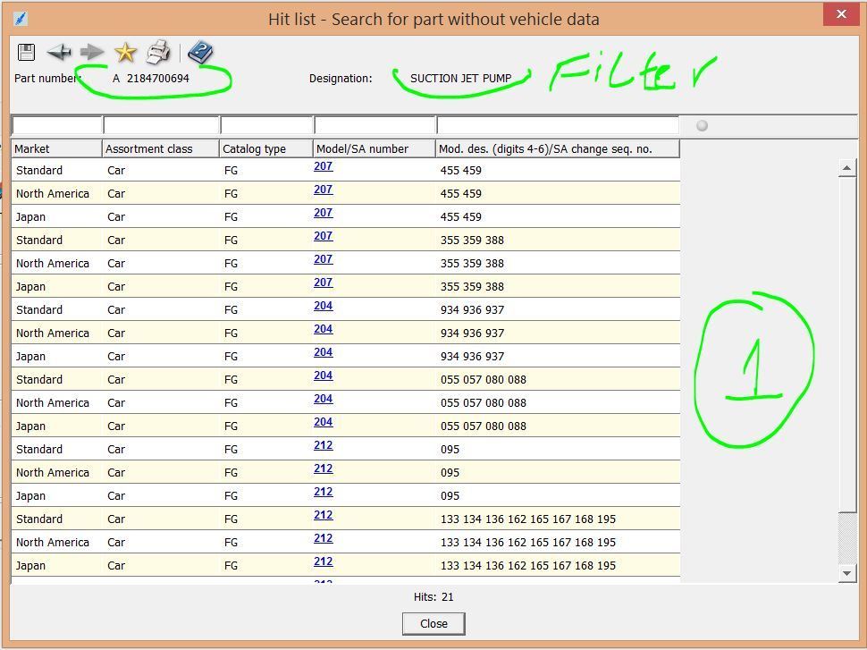

This is 0994 and not 0694
FCP Euro more expensive : https://www.fcpeuro.com/products/mer...mer-2184700994
In 2022 I bought from FCP Euro, because they export out of USA and cheaper than MB Indonesia even shipped + taxed, back in 2022.
Your fuel filter is very similar to mine
These are the cars using our exact same fuel filter P/N , but you must verify the VIN.
Mine, back in 2022
.Mine is a 0994 , yours 0694 ending
Happy shopping.............
