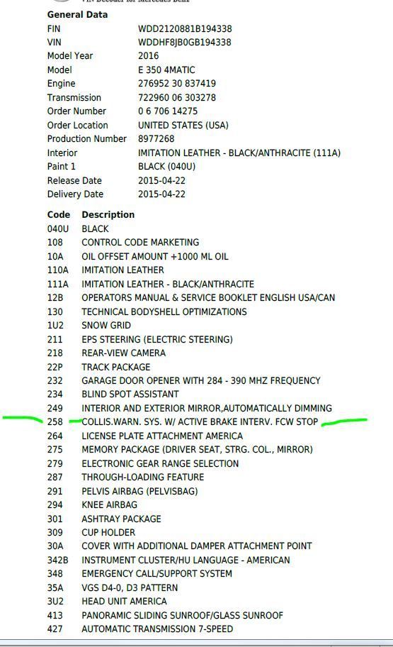

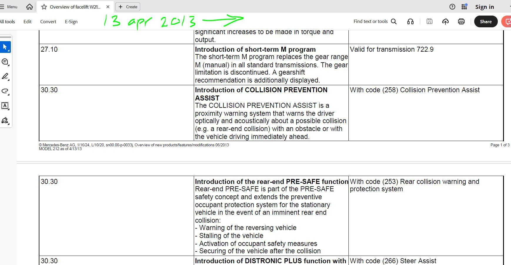

First go to lastvin.com and get ur data card, to decode your options related to ADAS and then post the PDF here.
I am looking at WIS for you and I already got migrain, because my car has no bull-shiet ADAS and there are names or code changes for these system in 2014 and up,
thus my system names familiarity is very low. MB also has newer Model Year 2015 variant with improved capability...dang.
Attached for the time being what I can dig out for you to read..
Finding WIS for the correct options and correct car need lots of time, the search feature of the WIS is very bad.
You want to learn more about your car, get knock-off EPC/WIS, a must have.
Spend time when car not in trouble to read about it while not under pressure, it will take more than 50 hours of WIS use just to know how to find stuff in WIS.
I have not gone as far as code 266, because too much reading...............
You got decent scanner like the baby launch ?
If not, get one , you MUST own one.

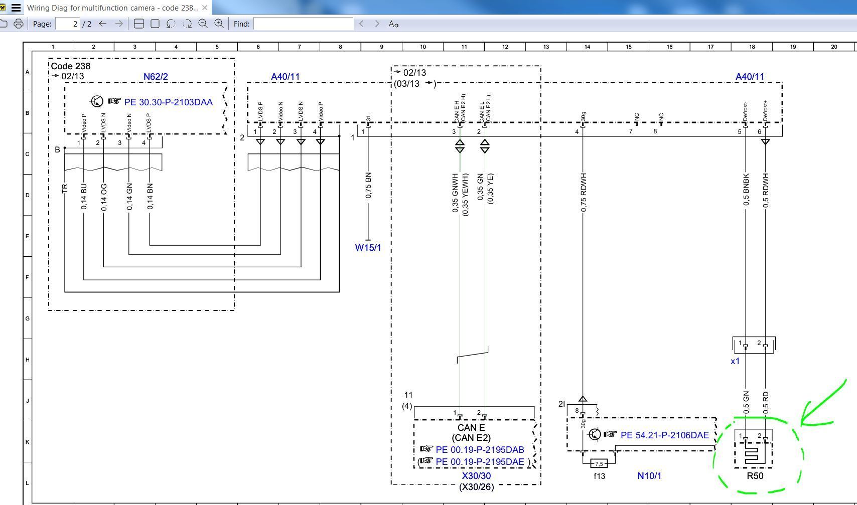

Check if your R50 heater on the front windshield serving the multifunction camera is bad or not ? This is an important anti-fog device, that R50 heater.
Now, post the datacard from LastVin.....asap.

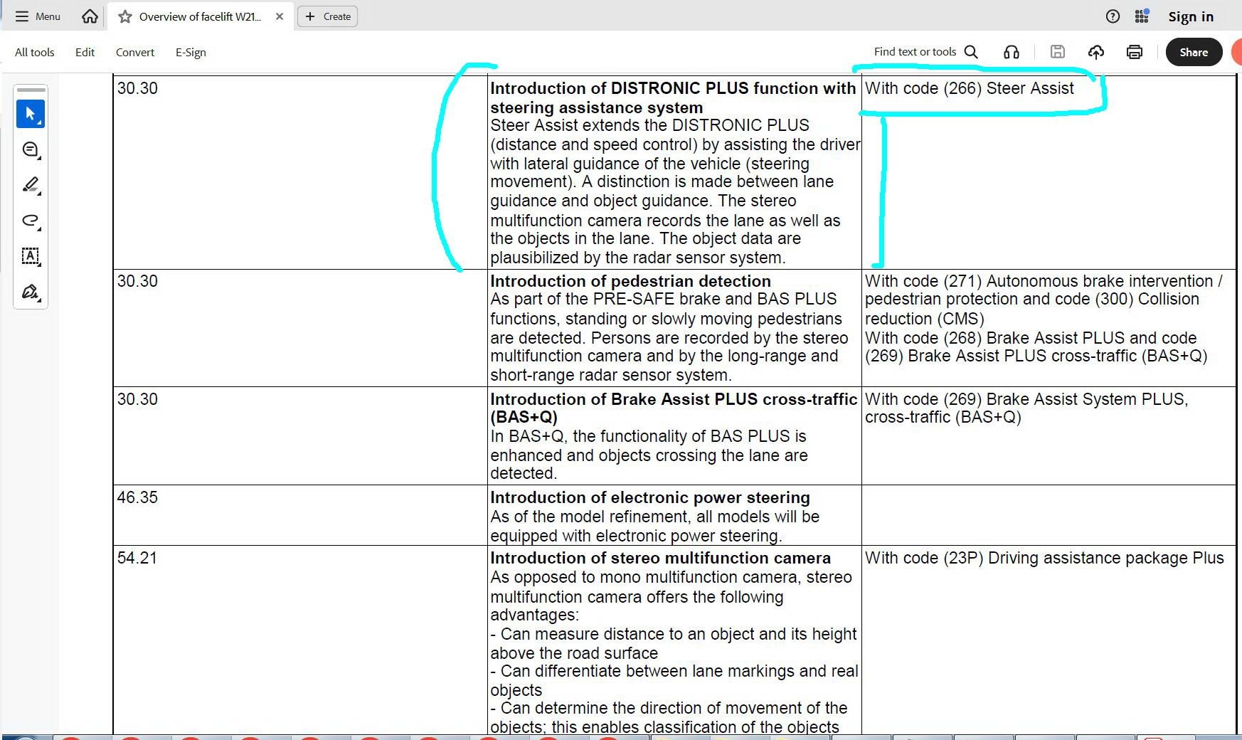

To add, option code 266 is NOT COMMON. Maybe cost a lot of $$
Only option 266 can correct your steering within lane keeping using its own logic, that is what I gather from the document below and attached
If you dont have option code 266, your steering doing its own "wondering" around is then nothing to do with multifunction camera, because if no code 266 those cameras are not being used for lane keeping or steer assist.
Most common USA cars options for W212 seems to be code 258.
I went thru 6 used W212 from 2014 to 2016, could not find one with code 266

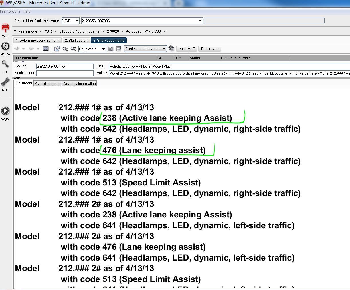

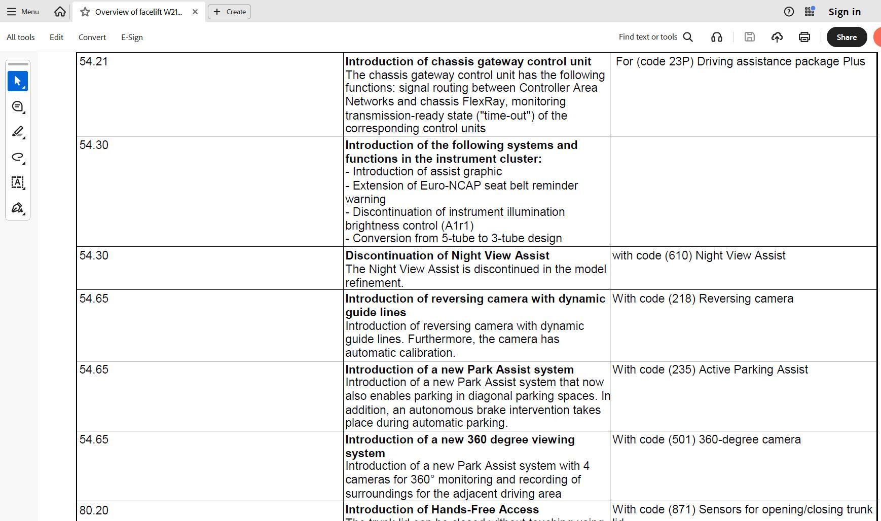

Before facelift these two are the lane keeping assist option code. Damn it is so confusing when I don't have any of them
Before facelift tech manual, snipet below and the PDF attached
I can't find the word ACTIVE LANE KEEPING ASSIST.
MB have always confused me when it comes to naming option code which over time changes or more mature.
My headlight is the ILS, but the highest model ILS and the WIS tech document call it not ILS but DYNAMIC.., the label on the headlight itself is ILS ( intelligent Light System ).

Based on all that... now factor in the stereoscopic view from the dual-camera setup
I don't think anyone should be tempering with vehicle safety systems such as brakes steering or computers...
> - 1 - MFK...
-- My simple steps suggested cleaning the haze film on the inner windshield surface + delicate plastic sensor lenses.
-- My advanced steps suggest soldering the loose pins used by this fancy module.
-- Beyond that if I had to revisit this module I would drill venting holes in the casing being sure it does not introduce light nor dust - This module is above 100°C without windshield heat.
> - 2 - SCM...
Another worthy target of repair for the wandering cruise control electric rack is SCM.
The Steering Column Module host the high-resolution steering position sensor. It uses optical prism looking through a comb to compute fractions of degree.
This module reads the precise steering column position so the steering rack position as well.
> - 3 - CGW...
I am not exactly sure what CAN bus the rack is connected to nor how the MFK + SCM interface with it. If Central Gateway is involved in bus translation... you can suspect it impact dataflow.
Regardless of advanced theories simple chassis Reboots can deliver temporary CGE sanity to help troubleshoot which unstable disruption is playing out.
> Closed loop Combination....
I used to have the funny wandering rack that I magically transformed into great center-biased better than new.
Perhaps the steering system requires all working inputs to work well: SCM + MFK.
Now car stays planted straight without cruise control active. This is extremely comfortable to drive chassis that's not on a unstable barrel roll left to right at every road bump.
