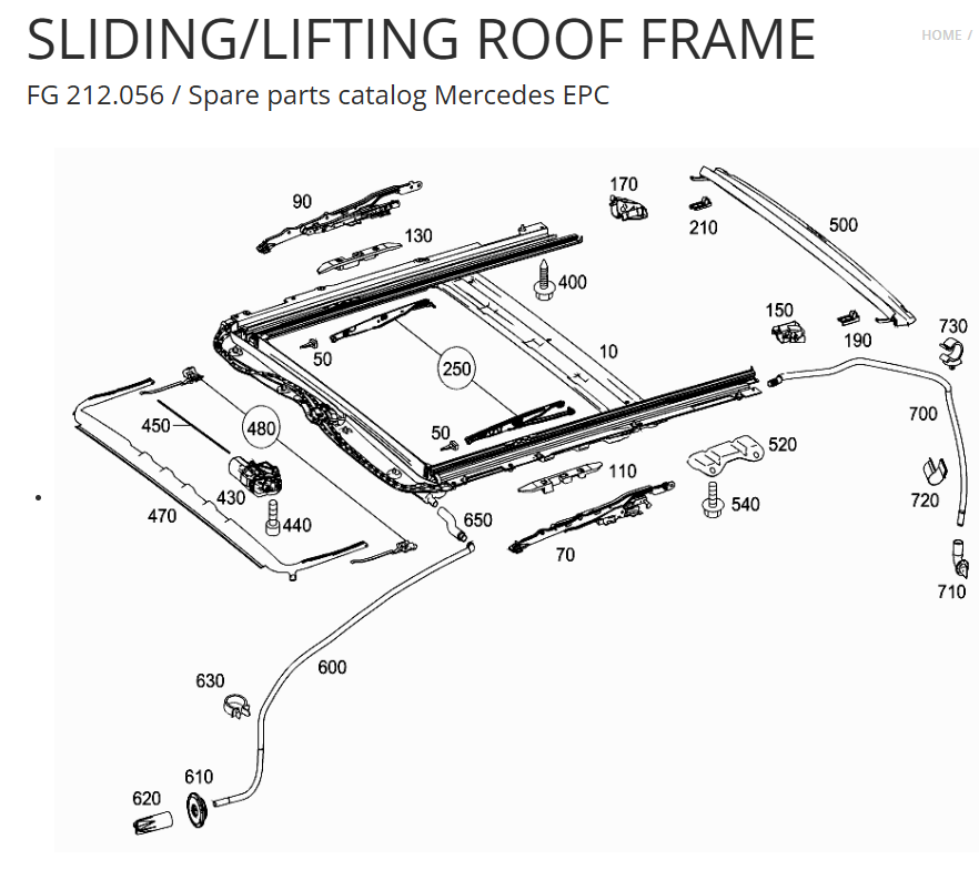

The sunroof discharge has 4 plastic pipes that shrink and pull-off...
Discharge hoses use a rubber nozzle that conveniently glues itself shut to overflow...

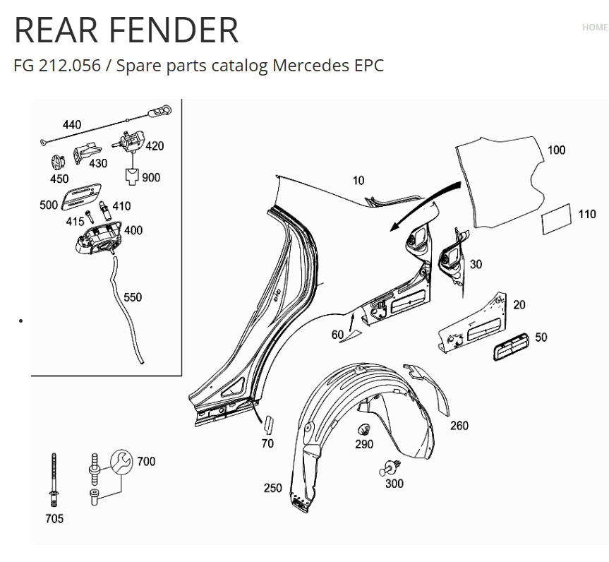

The water discharge channel area surrounding the trunk lead seal features a plastic cover fastened by rubber pins that are drilled straight into trunk area...
You describe an entry point that seems low-down not up-high...

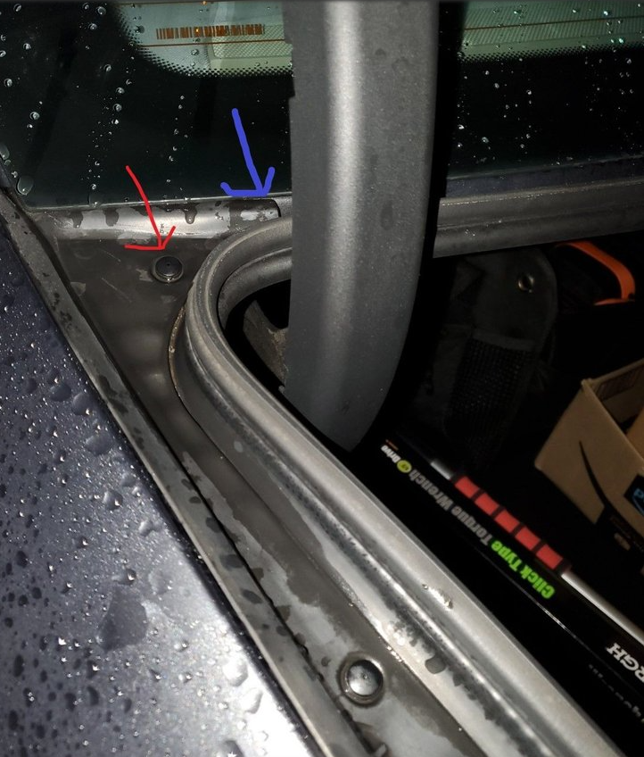

ENGINEERED... WATER-WORKS
trunk water pooling area

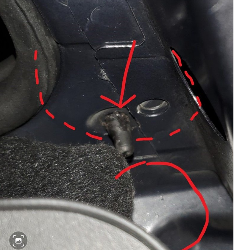

Leaking rubber pins...
water entry point
water entry point
