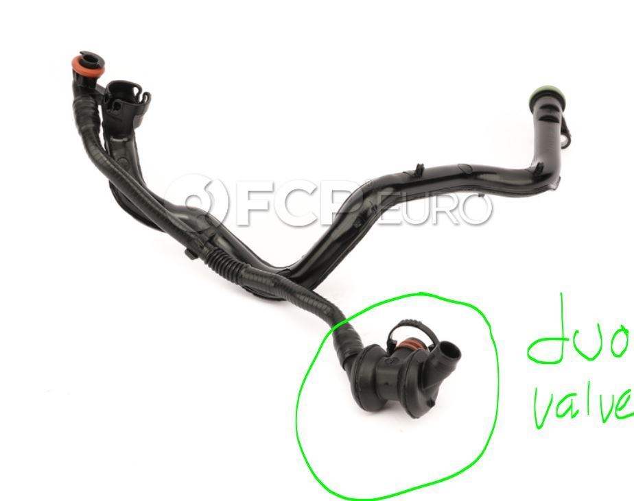

They should replace the entire assy and not only the 2760182300. However this part has the duo-check valve which can fail.

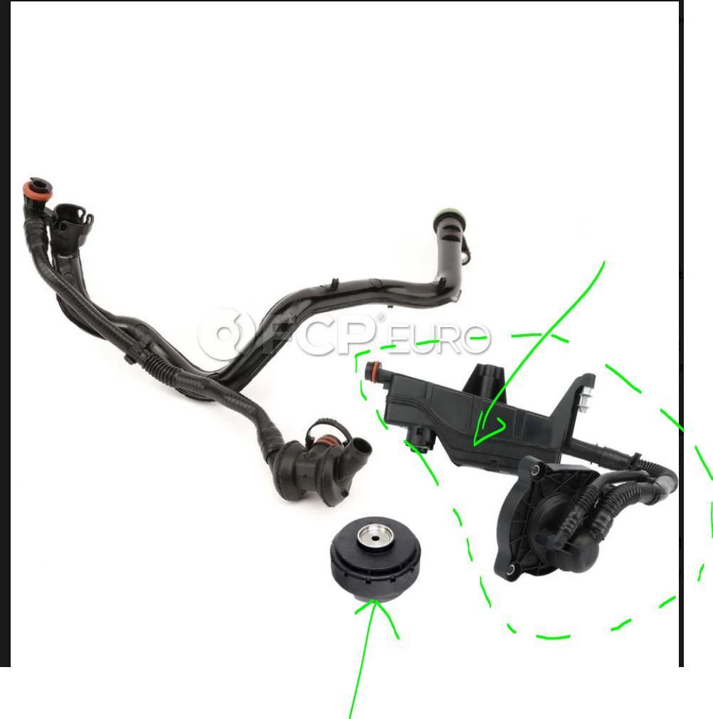

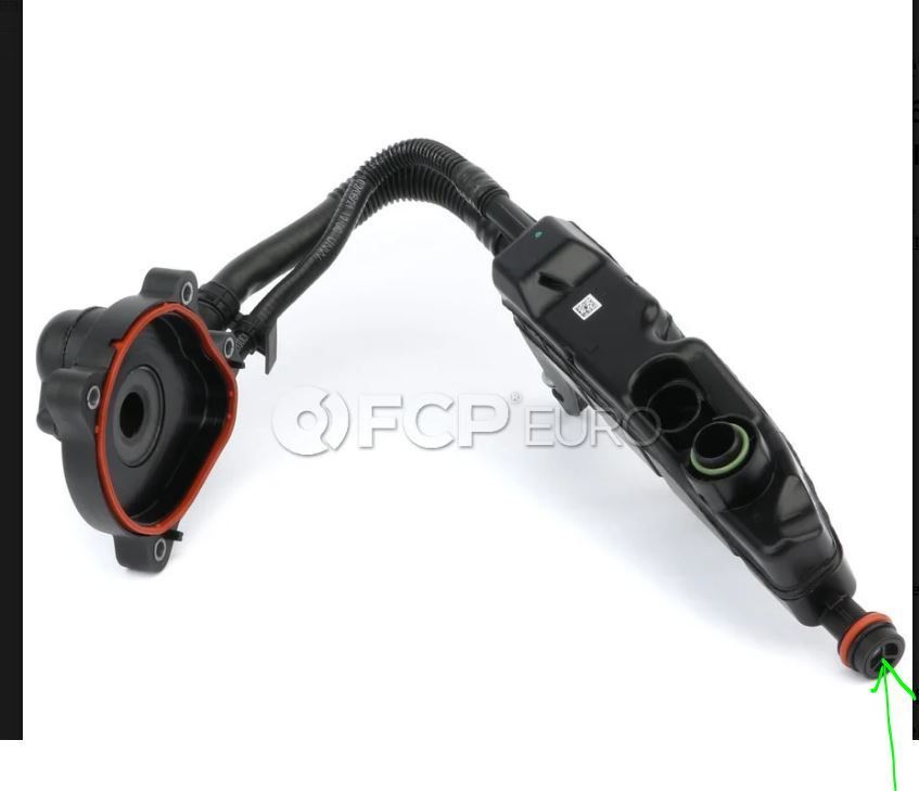

The entire complete system : That fine mist oil separator A has check valve too inside. I have replaced mine, as a 10-11 year refresh.
