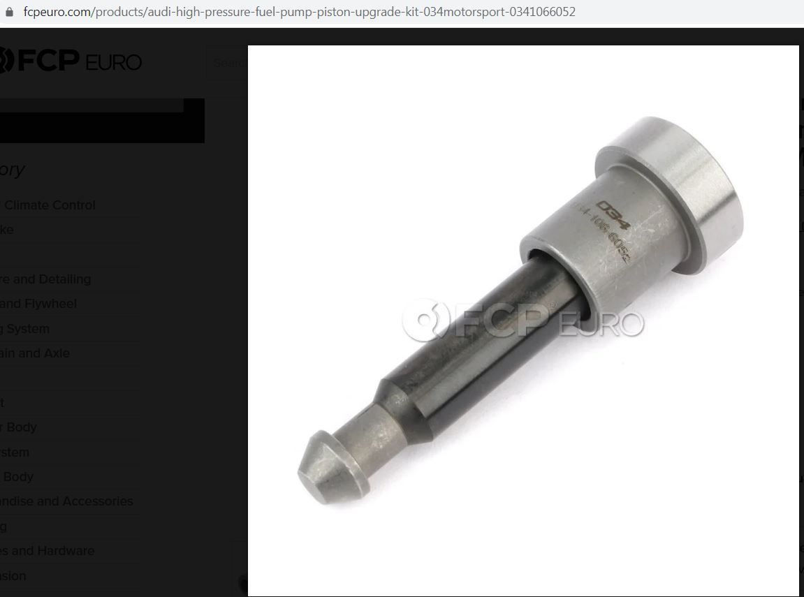

Close up of Audi aftermarket HP fuel pump upgrade kit for its piston and the liner/sleeve , also a GDI system.
https://www.fcpeuro.com/products/aud...ort-0341066052
Look , no piston ring. It is simply precision machining tolerance.

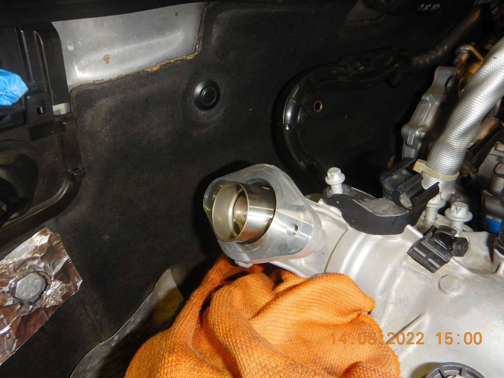

04 - Run engine say 3 minutes, shut off engine, cylle ignition.... and see what new DTC/s you get, by now any DTC/s will be STORED one.
This is my engine after 60 days being worked on and fuel system bled dry at both low and high pressure side.
I primed it properly etc etc and started the engine :
Yep, the air intake boxes I flipped them forward so that can inspect fuel leak better.
The air intake boxes pressure sensors (2 ) are installed at its connector but not at the air boxes, so no DTC/s.
See how long it took for my engine to crank, but there is no bad misfire because I primed it properly using bi-directional control.
NOTE : fire extingushers ( 2 ) standing by all the time , because I am leaking fuel out of the union nut of the injectors.
