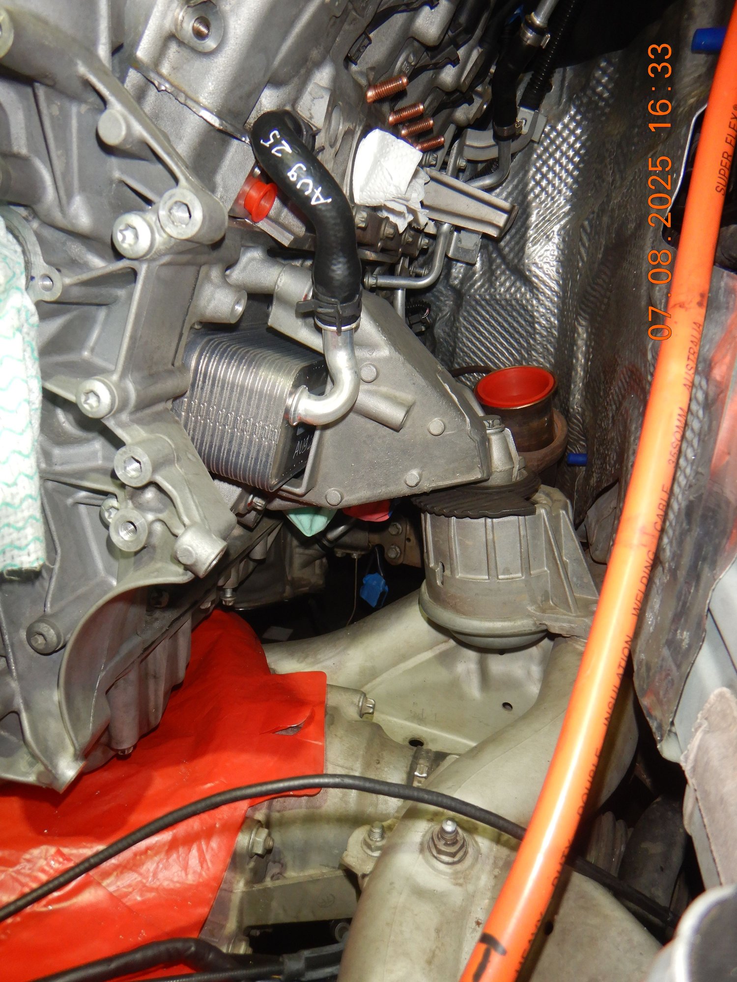

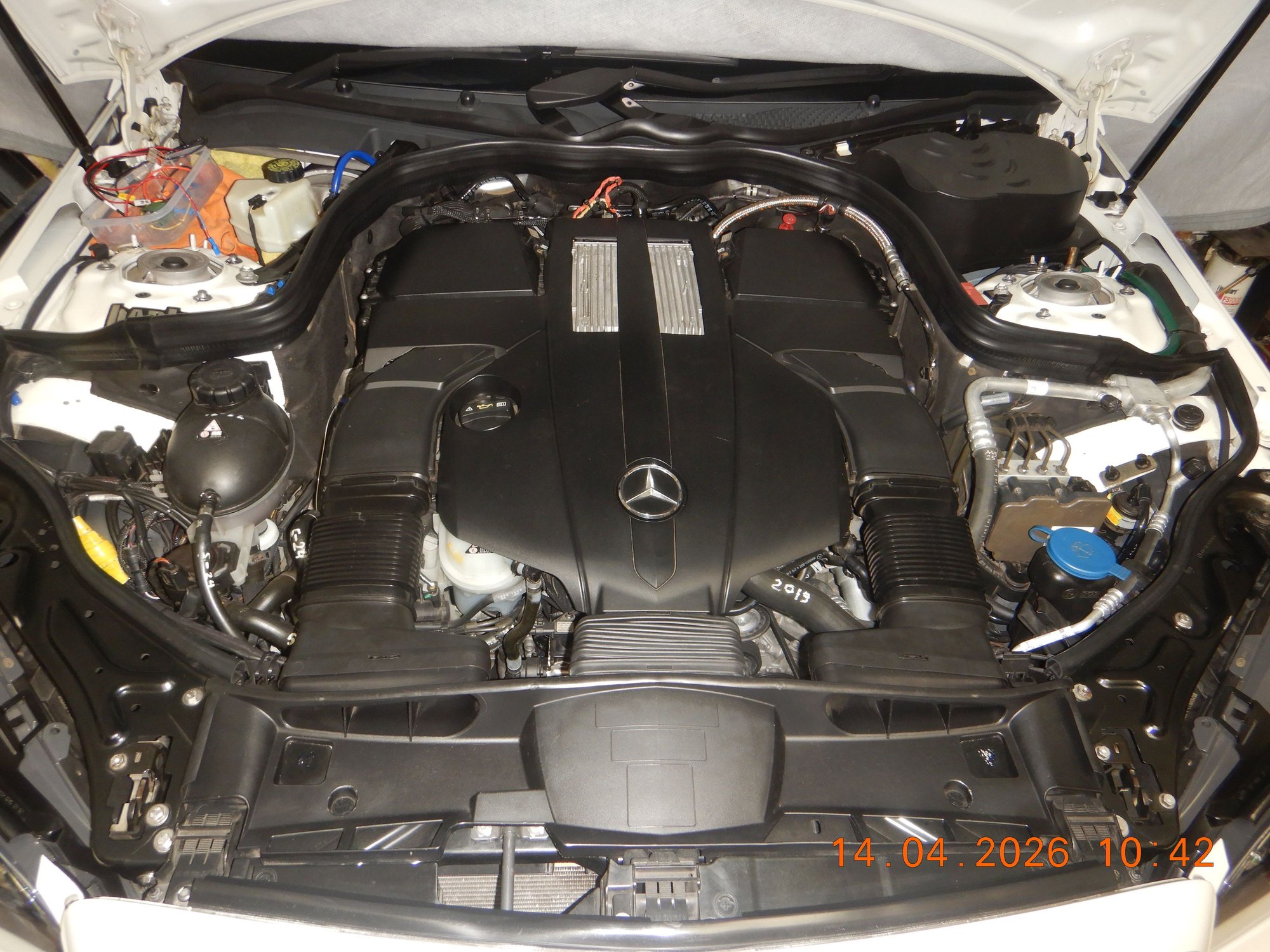

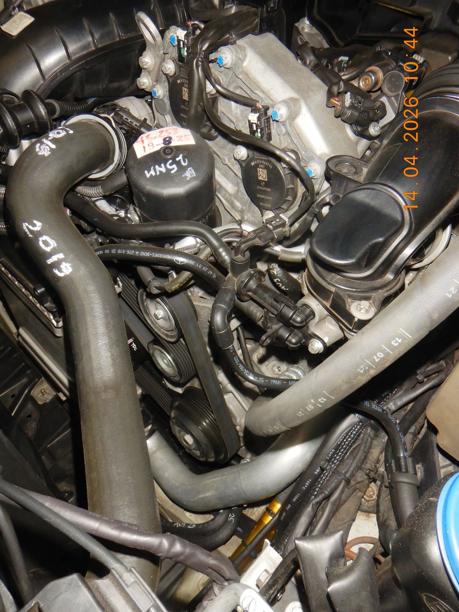

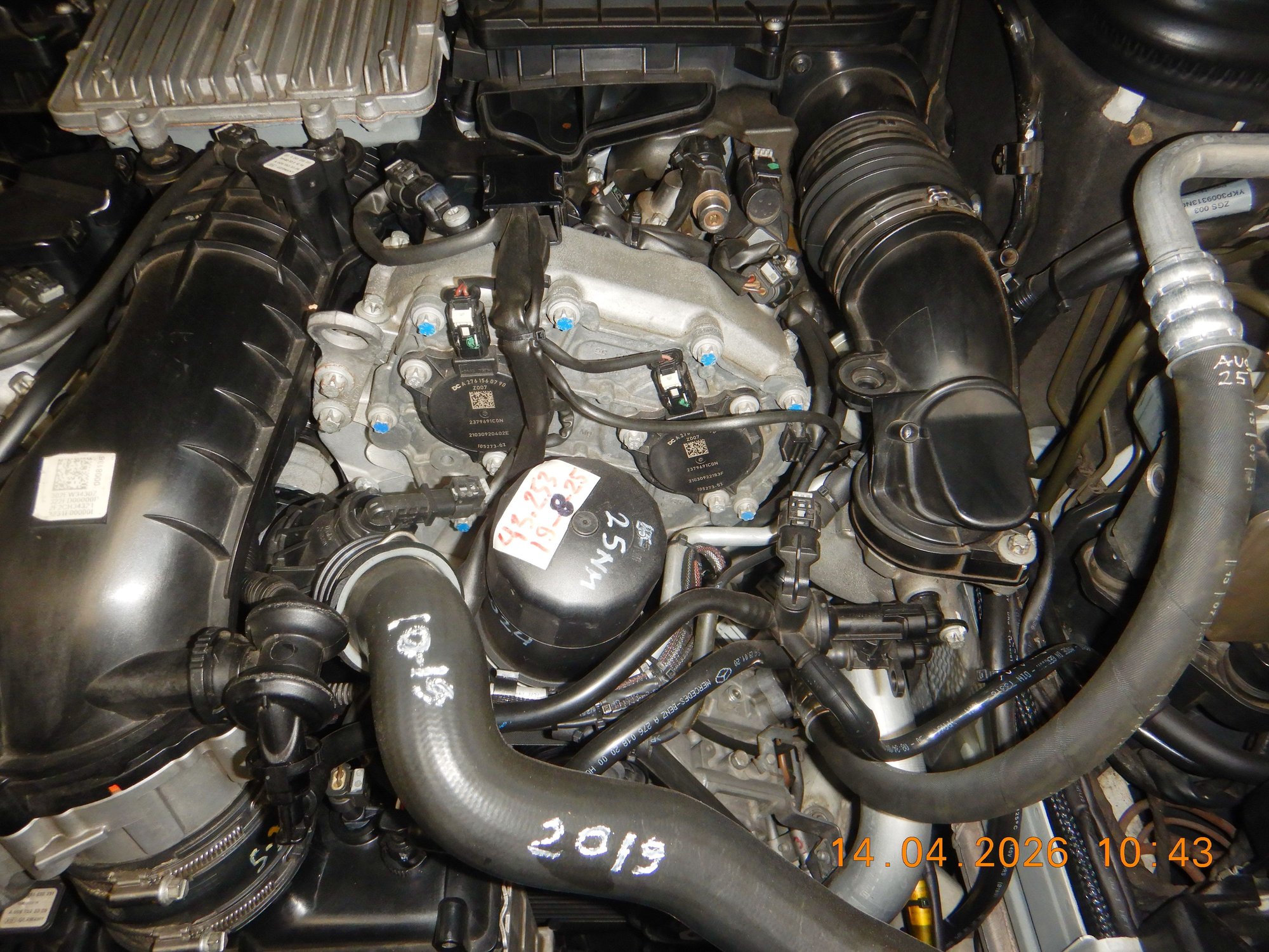

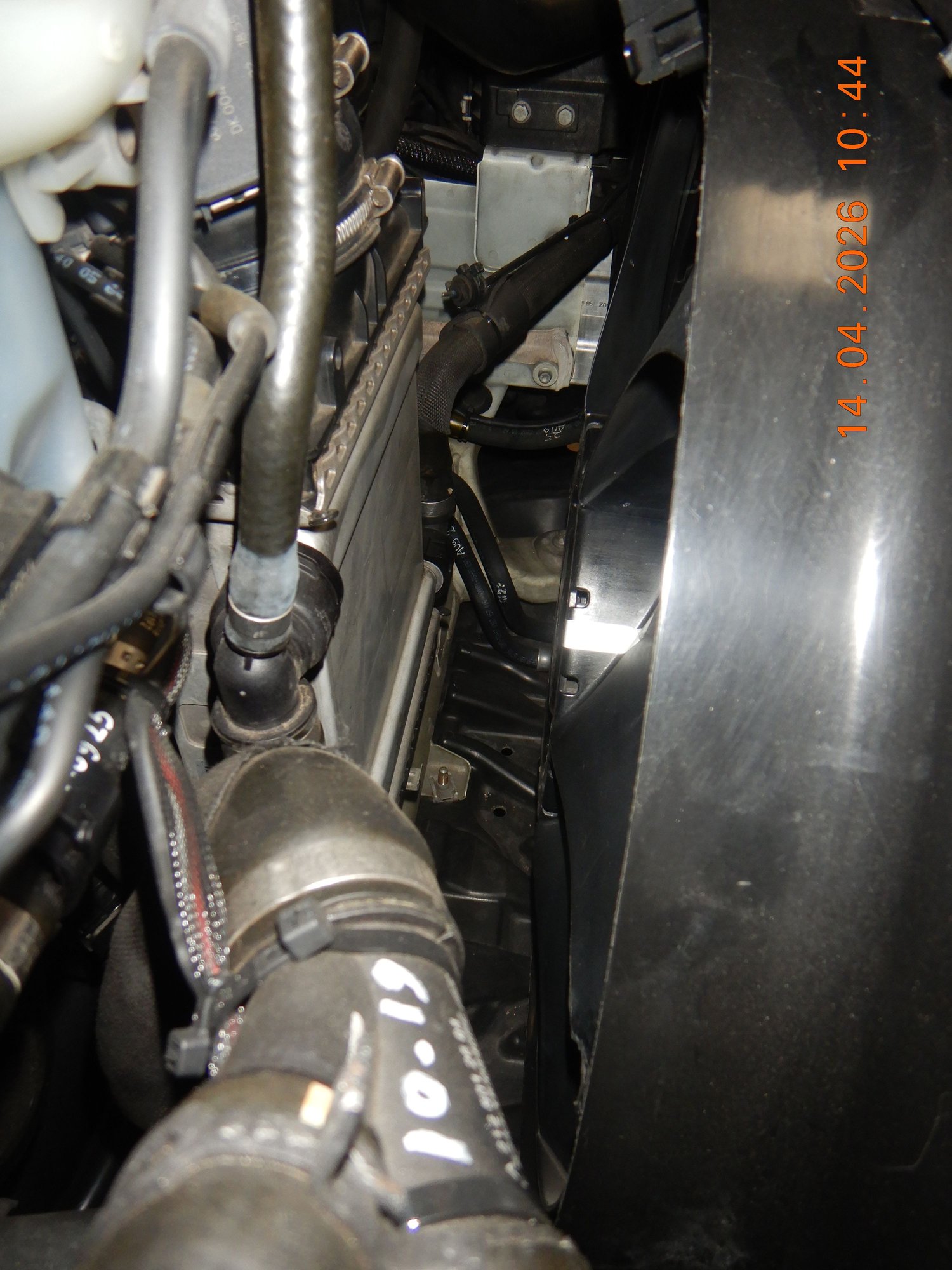

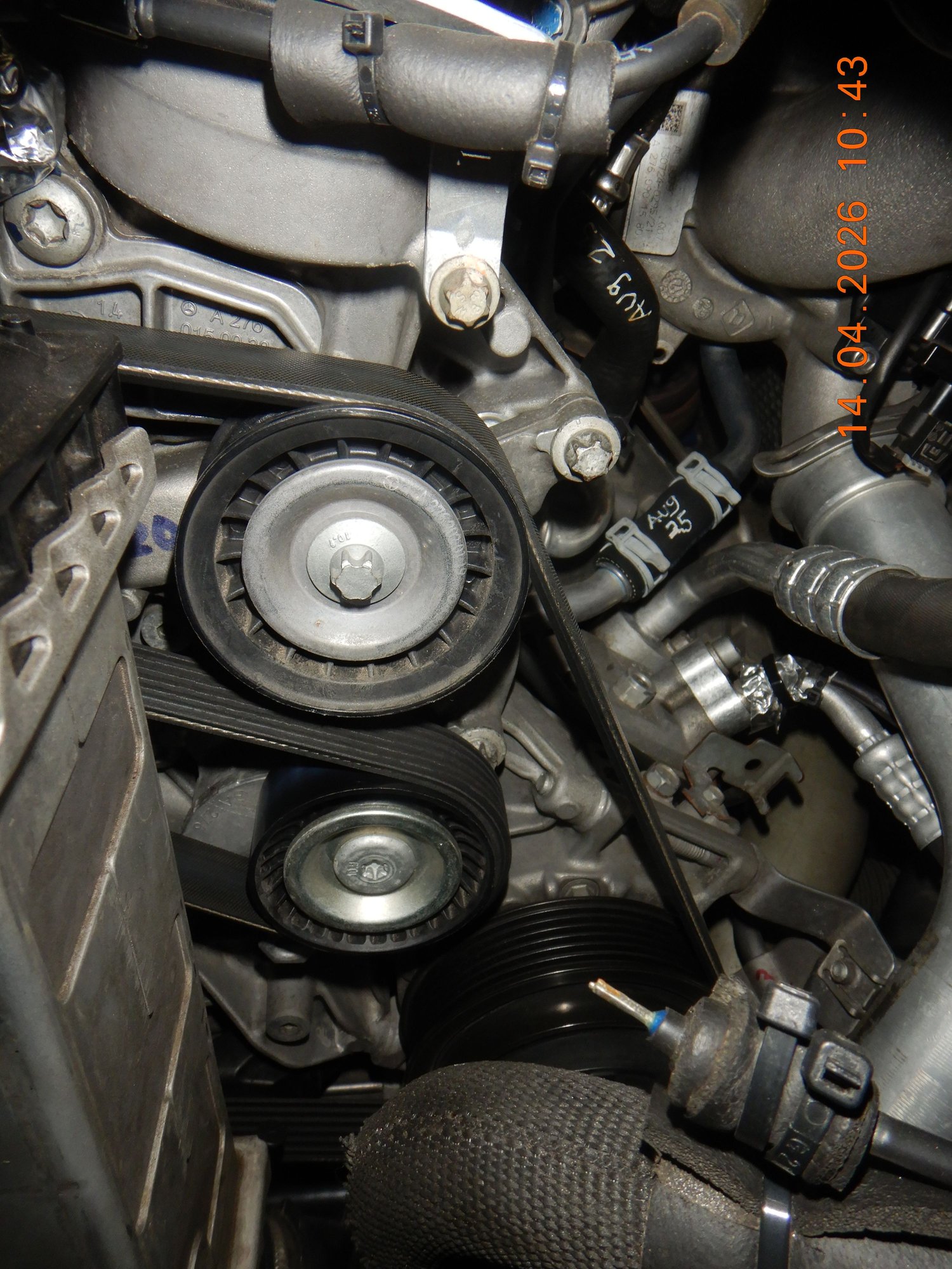

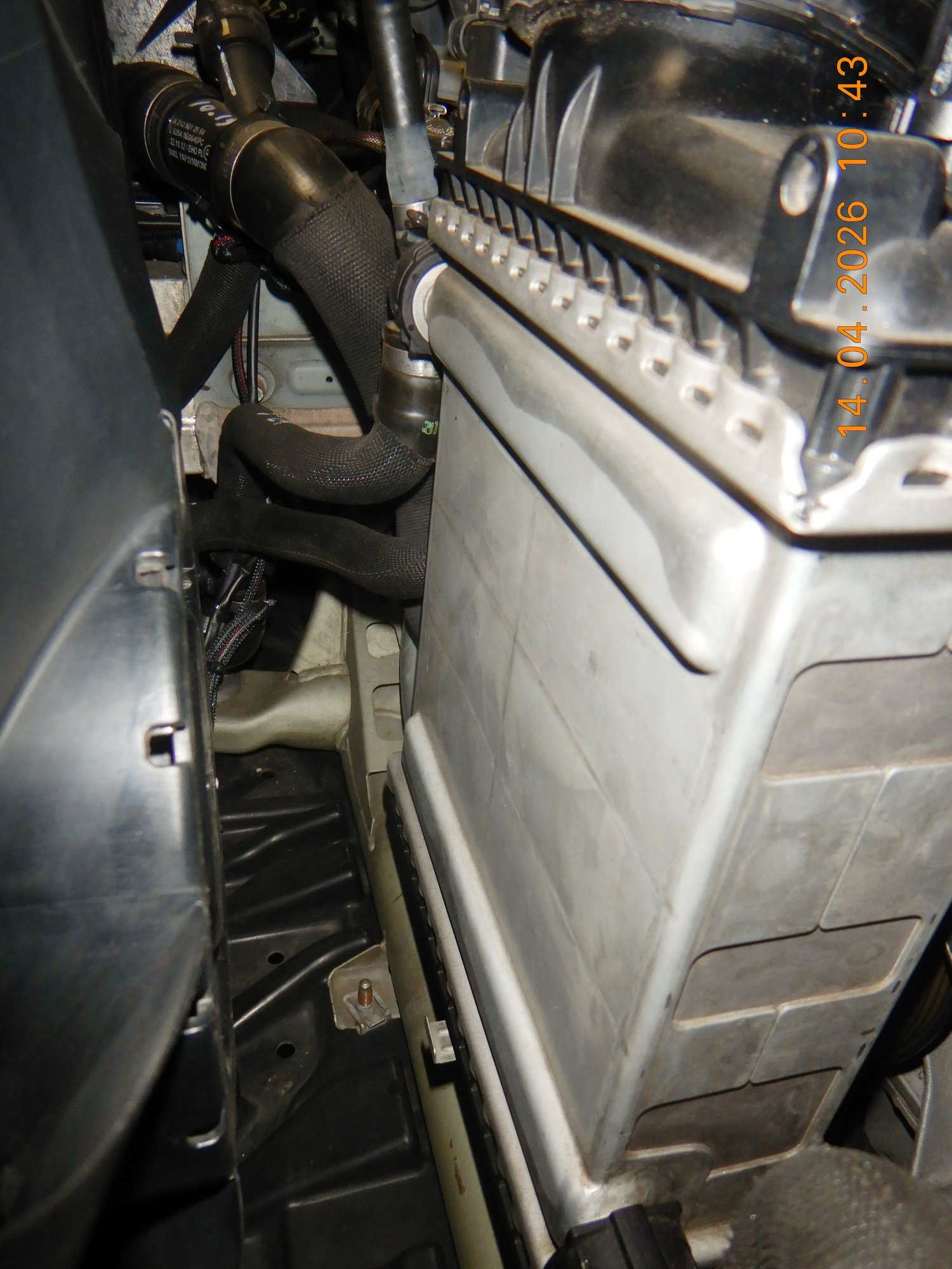

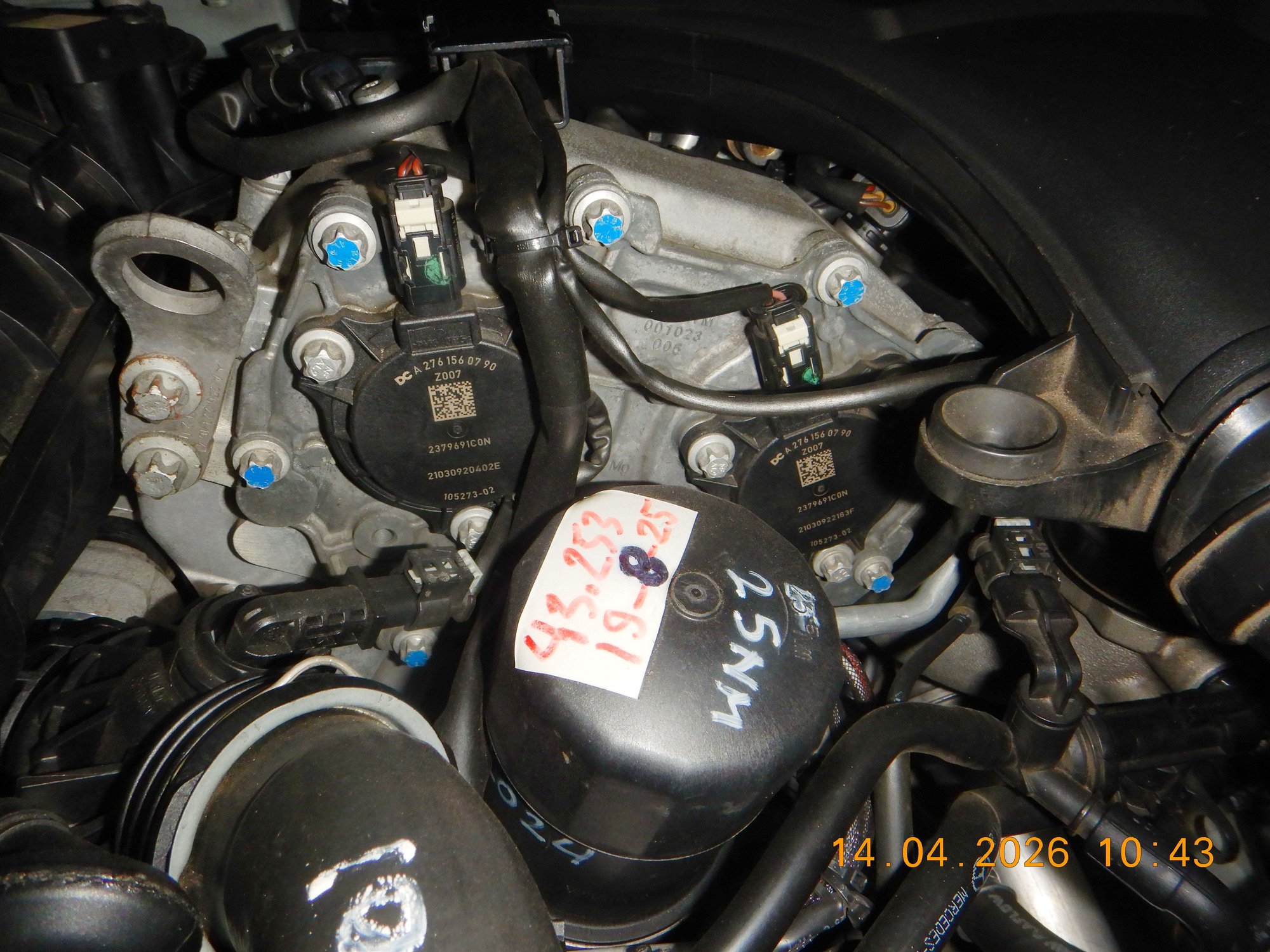

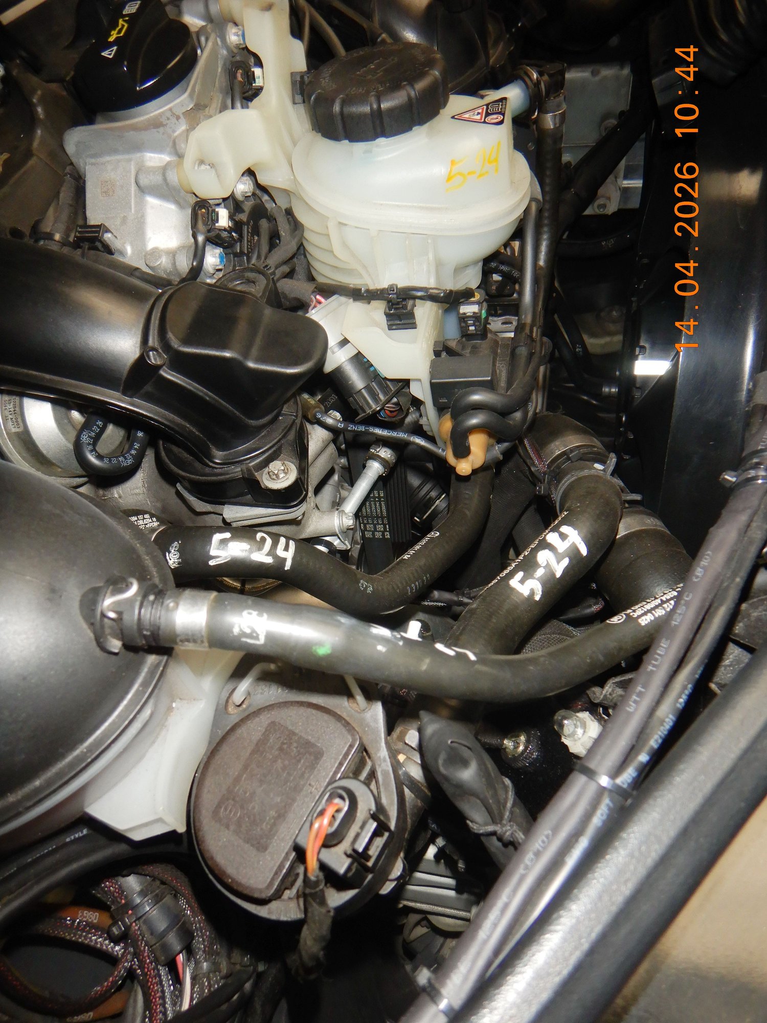

Because it was only 400KM ago, albeit 6 month ago I was replacing lots of cooling, engine and tranny oil and HVAC-R134A handling components of my engine, it is now at its superb cleanliness.
I mean all the nook and cranny is accesible back then. I even removed both the turbochargers, so great acccess.
If all installed, M276.8xx 3.0 Turbo front side is very crowded due to the chargecooler system.
Jakarta ambient dust when car get used on the road is just bad.
NOte : Ignore the left side, Front SAM rather messy, I am still doing Fuse Pulling/Blown simulation.

It look nice & shiny.
I'm not used to seeing the intercooler between the engine and front radiator.
You do have the benefits of a more effective oil separator unlike NA.
MB turbines bearings seem pretty reliable, right?

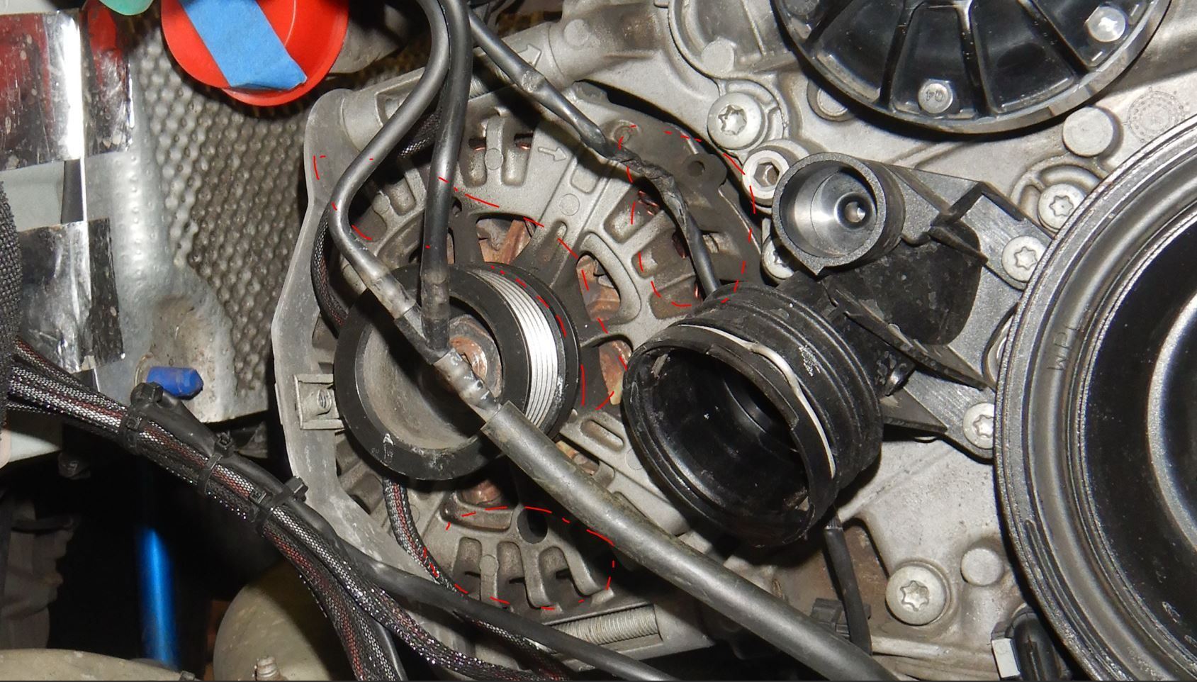

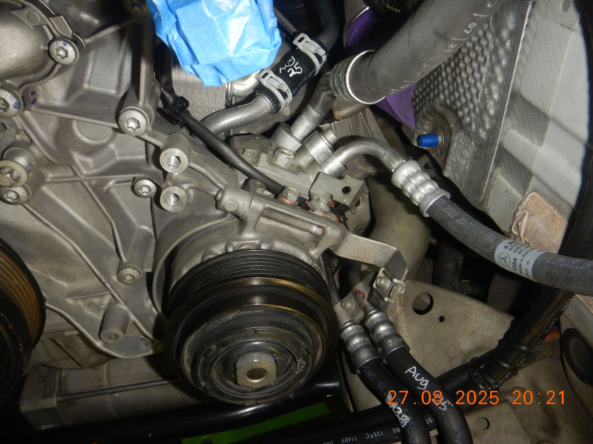

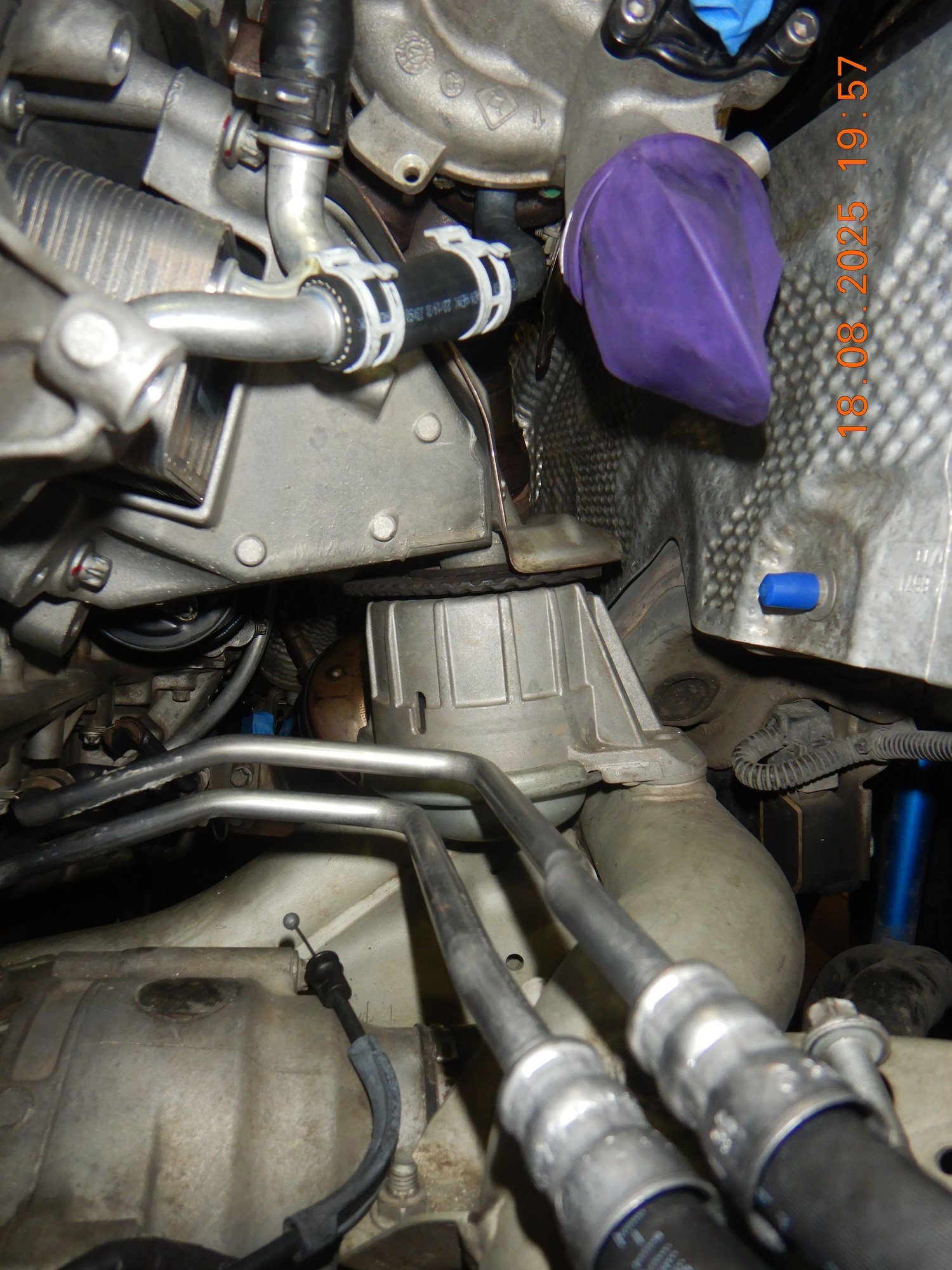

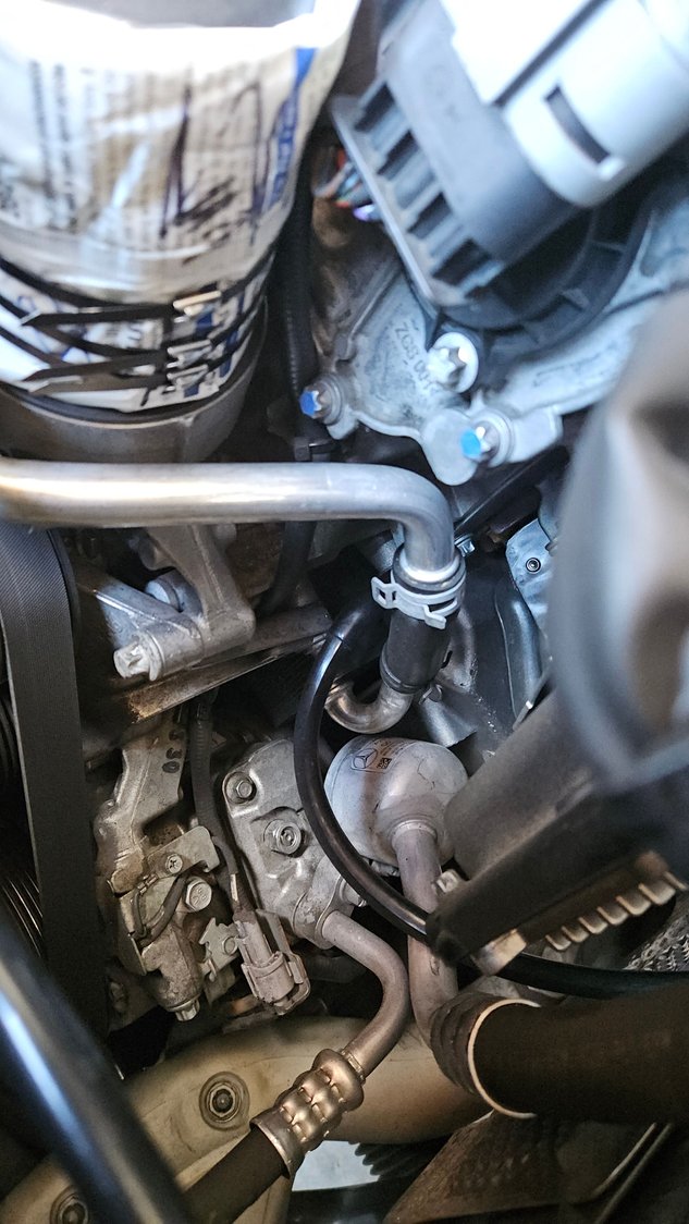

My engine bay dirtiest moment.........
https://mbworld.org/forums/e-class-w...lant-work.html
Spoiler
This image below is RIGHT SIDE BANK. Alternator is at right side bank, lower side. M
HVAC compressor is at Left Side Bank, lower side.
Engine oil leak will also drip down to Electric Power Steering connector
Alternator location, with alternator REMOVED
My car is RHD, so you can see the steering link on right side bank of the engine.
If my mileage were much higher back then in 2022 ( probaby 36,000KM max ) meaning more oil leak covering the alternator, this alternator might have been cooked , lucky I fix the leak back in 2022.
ALTERNATOR BODY : Between the 2022 oil leak fix fix and Sept 2025 refresh or approx 8,000KM later, the serpentine belt and ambient dust are as below :

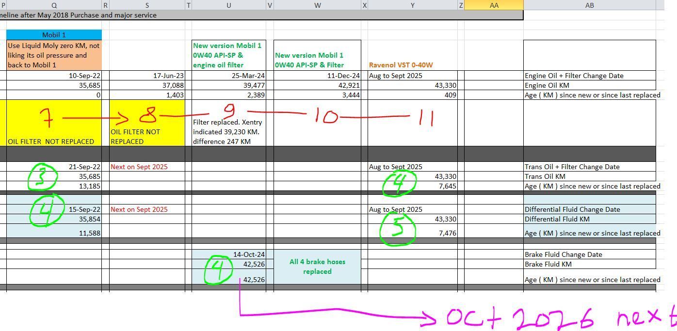

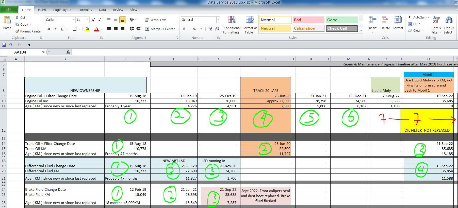

The last 4 years since early 2022 have been expensive ..............low mobility on the car, but services do go on of course.
The engine oil in red numbers are the very very low mileage, but months exceeded. My target is maximum 9 months old oil and not 12 months....or approx 5,000 KM or 200 engine hours.
Engine oil been Mobil 1 OW-40 MB approved version since day 1 of my ownership, unless I wrote other brands like Ravenol or the Liqui Moly which I do not like.
The good thing about tranny oil get replaced so soon and so often, its so smooth and so responsive.
Even DIY, tranny oil + oil filter replacement is the most expensive and troublesome.
