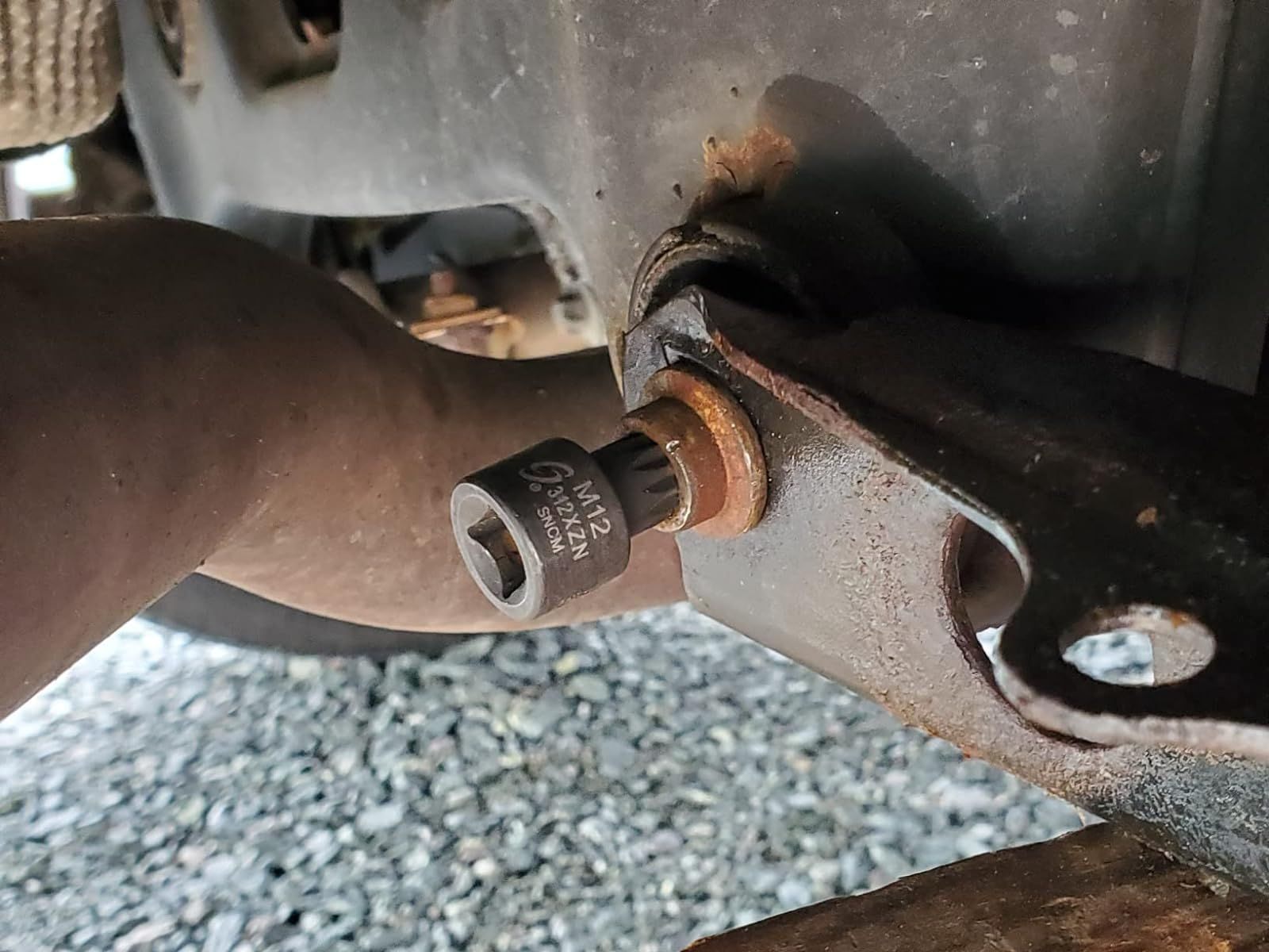

Rear- only toe is adjustable, to an extent. It uses an eccentric bolt and disc at the inside mounting point. When replacing the rear tie rod it is important to mark its position and install the new one the same way.
Front- toe, camber and caster are adjustable. I believe special bolts are needed to make adjustments.
I would inspect the entire suspension for anything worn, loose or cracked bushings. My tie rods look pretty bad so I have replacements i just need the time to install everything. It involves lowering the front of the rear subframe to remove the bolts.

If the rear springs are not broken, you may get away with adjustable camber arms, to correct the negative camber that was caused by slight spring compression
Then do a toe-in realignment
I would try that approach first

Alignment at the REAR is only for rear toe, yes you need to do it after spring replacement, just to be sure.
For my case, new springs did not cure the too much camber at RIGHT REAR.
https://mbworld.org/forums/e-class-w...g-seating.html
I had to use adjustable rear camber arms, right side only to get back to proper spec
https://mbworld.org/forums/e-class-w...-out-spec.html
But do remember, my camber is not crazy out of whack, but is not within SUPERB spec.
