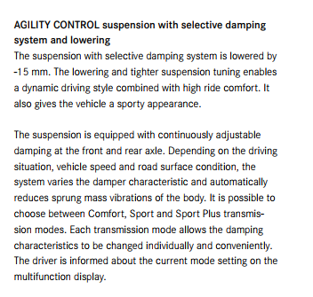

According to page 5 of the brochure - it looks like depending on the transmission Comfort Spot and Sport plus - the damping is adjusted. SWEET!
No, only if you have the option SA 459 or 489
This is package 677 according to the brochure. Am I reading it wrong?

It is not correct, SA 677 is non adjustable, and furthermore it is not possible to lower the vehicle on the fly without Airmatic.
It is my understanding the capability is built into the struts themselves and is passive, e.g., not driver adjustable.

From: Sweden
S213
Yes, hence the misconception..
