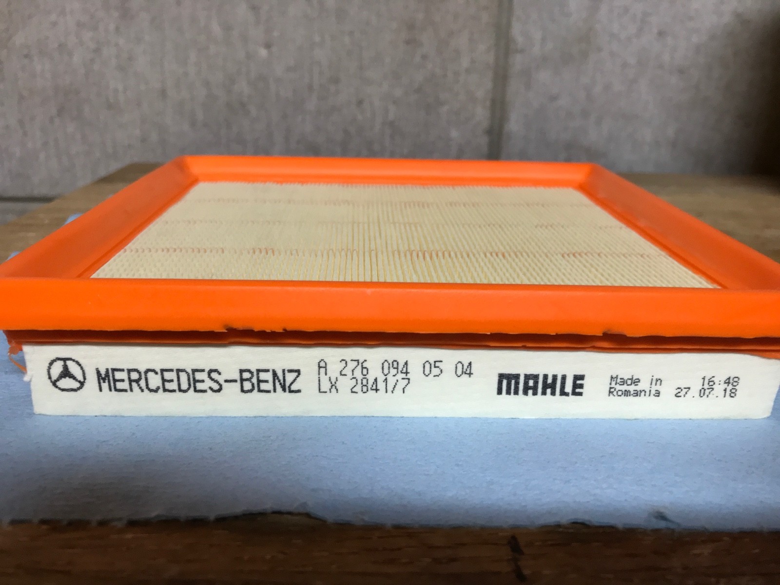

Changing/checking air filters is easy in this W213
Heck if a fool in a wheelchair can do it anyone can right? I just used that torx screw tool and that was the only tool I needed. There are clips on front of the engine air intake so be careful when unclipping those and then the engine cover just pulls off by hand no tools needed. The air box covers only have 4 of those torx screws, just make sure to tuck down the far end that clips in across from the torx screws, that's what holds down the right side of this cover. I figured with the small amount of debris/dirt I saw in these filters today they should be fine for at least another 10 to 20K miles. I thought maybe they would be worse after 10K driving in Florida and 2K driving back from Florida and New England.

Does anyone know if the orange filter in the picture is the Mercedes oem air filter? Do they look like that? It sure seemed like a el cheapo chinsey air filter. Maybe the filter was changed with a non oem filter at the 10k mile service although I doubt it. Just kinda surprised that Mercedes would use a filter like the ones I had in my hands today. Maybe I’ll stop at the auto parts store tomorrow and see if Wix makes filters for this car yet. I always had pretty good luck with those.

Thanks. Yep that was it. I missed looking at the sides. Darn though looking at those they look like cheap Chinese filters. I’ll have to compare them to a wix or a Mann or some other filters. Maybe Autonation using the cheap Chinese filters is not such a bad thing after all. They might use the same Chinese vender Mercedes uses lol.

Originally Posted by riamga
If you want the same filters are the MB factory filters just by the Mann brand. Mann makes all of MB air, oil and cabin filters at about 1/3 less in price.
Doc
Yes, except for TT V6 400/450/43 it is made by MAHLE (see pic post #3).

I still have not looked into other filters but am going to when I have the time. The Mahle looks like it was made by a Tamale in Mahee, lol. There's gotta be a better quality air filter for our cars I'd think.

Yes these filters do look flimsy (not because made by MAHLE instead of MANN, but because of how MB designed it for V6TT - even E300's I4 single, MANN made, air filter looks/feels more "substantial"). The worst part is that service manual calls for them to be changed only at 50Kml/5yr intervals. I would do it 30/3 instead. For some it could be yearly with 25K+ m/y.
