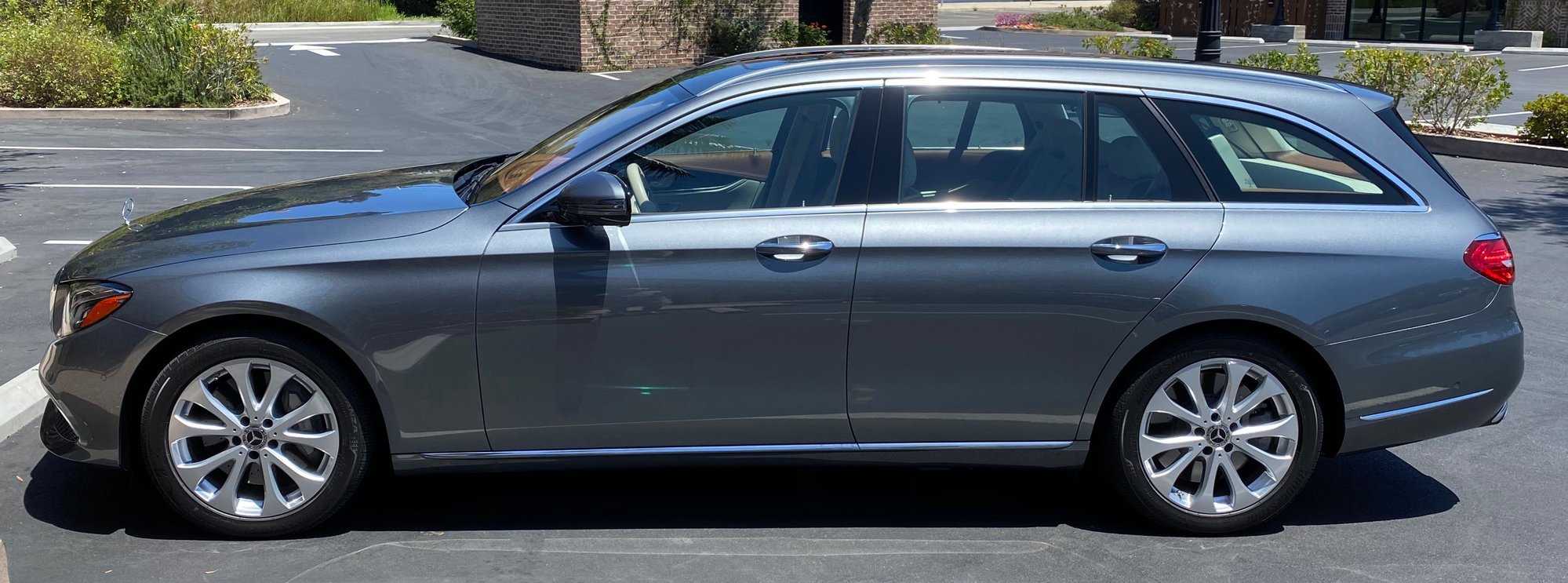

My favorite tires are Bridgestone QuietTrack non-run flat tires. The QuietTrack replaced the Serenity Plus line, which was my previous favorite. I put them on our 2019 E450 Wagon within days of picking it up and the ride is MAGNIFICENT! These tires are very quiet and very soft riding. I have them on my S560 sedan as well.
