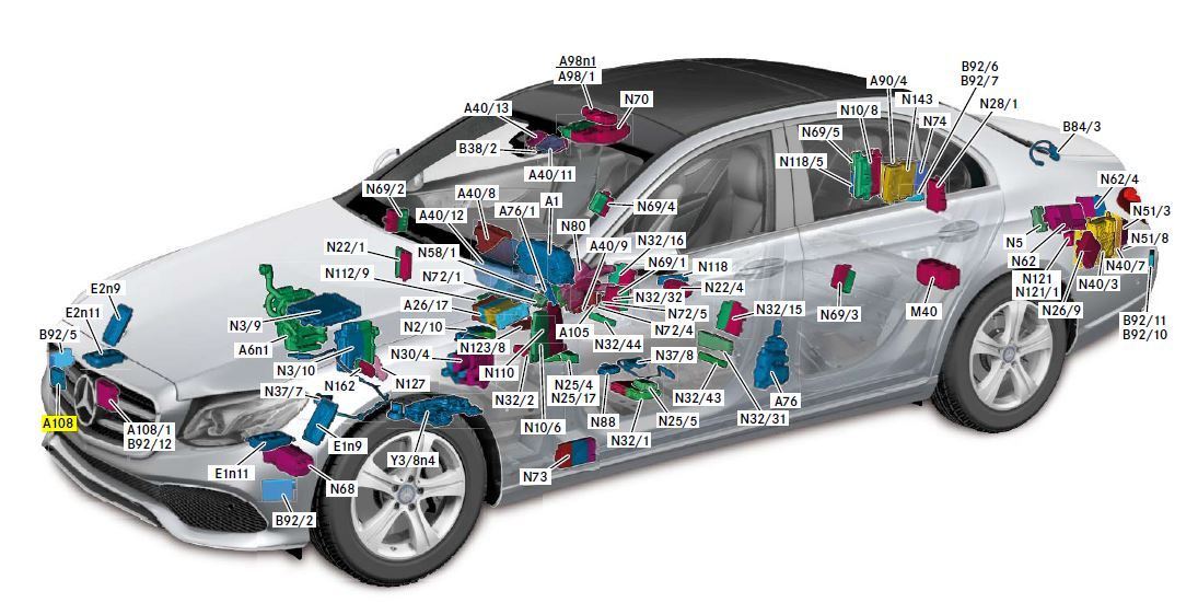

Anybody know the exact location of the radar sensor in the back bumper of the W213?
I'm not talking about the small sensors dotted around the bumper itself.
There's a main squarish histrionic unit hidden somewhere.
I've been under the car and can't find it.
I have the "Radar sensor dirty" message. Cleaned the front unit behind the grill star throughly - many times.
No cruise, no proximity sensors, no lane changing or keeping assist.
No codes.

Shown on 212 same location for 213.
File Type: pdf

You are the Champion Konigstiger.

Now all I have to do is get at it.

Turns out.
Dealership did their scanning and found that the front sensor bracket which holds some electronics is faulty.
Cost of the new part - AUS$ 4,100 plus $ 850 for it to be fitted and the Distronic radar recalibrated.
Part failed in heavy rain. - at the time with 7000 miles only.

What’s a “faulty” bracket? Like broken or loose? I don’t see how rain ruined the sensors, unless they were physically compromised and water got inside.

Very good question.
I'm assuming water ingressed into the electronics via wicking through the wiring.
I'll ask my service guy for a detailed explanation.
And then ask him to cover the connections in epoxy or something to prevent a repeat.
I've seen on other forums that this seems to be somewhat common - - probably bad design.

I found an entry into TSB's for this problem he posted up on Benzorg.
TSB LI54.70-P-066764 - deals with this very issue.
I've printed it out and am heading off to my local dealership to see if they are aware of the TSB.

Turns out to be - fault in ABA control module.
Radar sensor dirty is just an indicative message that there's an error in the control module.
