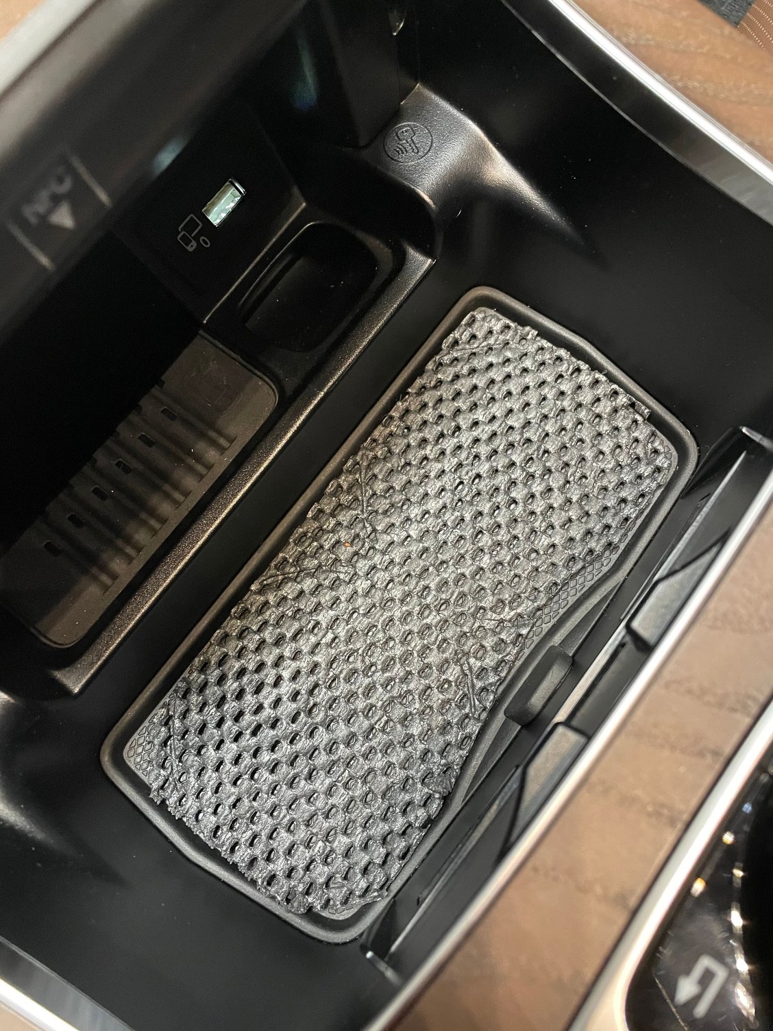

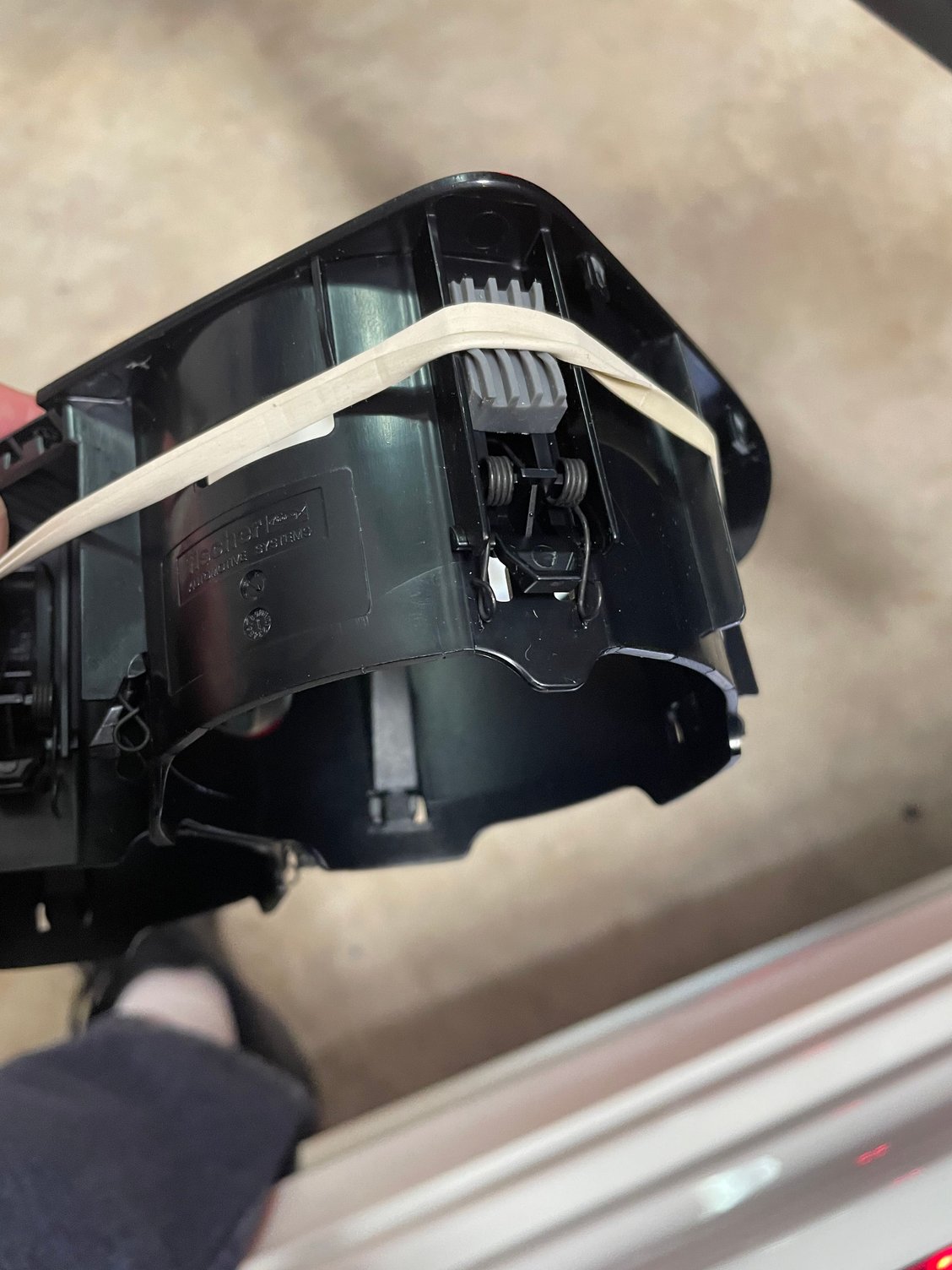

So I have to agree with the cup holder problem. The main issue is that the springs for the tabs are too week. They are fine for paper cups, but metal cans (or thermoses) are not properly held and therefore rattle over bumps and tip over in corners. Additionally the flimsiness of the tabs means that they themselves rattle and creak.
I did come up with a somewhat novel but also a little bit crude solution that works surprisingly well.
Each cup holder has 4 tabs (2 on the outside and two on the inside). What I did was remove the assembly and glue four small rubber pieces to the outside tabs so that they would be flush with he wall of the cup holder. In the picture this is the grey thing you see. I then put three elastic bands around the entire assembly. What this does is make the 4 outside tabs of the cup holder much stiffer. Because of the design there was no way to do this with the inside tabs, but it turns out that stiffening up the outside is sufficient.
To deal with the rattling and creaking, I installed a thin pice of black foam on the floor of the tray and also added some graphite to
all the tabs and springs of the cup holder.
Problem solved. We will see how long it lasts.
