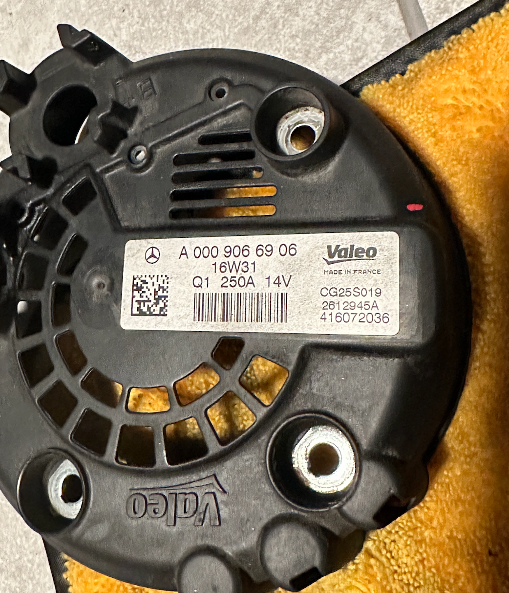

Hi everyone. I just wanted to post this here in case anyone runs into the same issues i've been having. While I replaced my battery with a new OEM Mercedes one, I was still getting the "Keep engine running" message with the battery icon after leaving my car in the drive way for a few hours or even a day or two. I removed my Alternator and found that the bottom brush was almost shot, and the top one not even touching the alternator. I also had a hole in the regulator cap for some reason.
Once I saw the brushes I ordered a new regulator on eBay (https://www.ebay.com/itm/223004344315). I was skeptical of buying it because it didn't say what AMP's the regulator is and what the voltage of the regulator is. My E300 4Matic alternator (A0009066906) is 250 Amps and 14V. However, after doing some digging I found that it is a 14.3V regulator and it should work by looking at this websites description (https://www.maniacelectricmotors.com/599288.html). That website also references the part numbers on the back of my alternators back plate which is CG25S025. So i'm hoping it works.
I have a few more things to button up and replace in the engine, but when I turn the car on and test I'll update the thread if it worked or not. This could save folks a few hundred/thousand dollars as MB quoted me $1,800 just for the alternator and core charge.

Did not work. I re-assembled the entire engine today and started the car up for the first time in about 5 weeks. Got an instant check engine light and when I read the code it said communication to the alternator is not present. I went into the DYNAMIC mode on the cars screen and saw the battery voltage was 12V flat and did not go up or down at all even when revving the engine.
I put back the old regulator and the voltage was higher, but still didn't work correct as my brushes are almost worn out completely. But that just tells me the new regulator did not work. So we W213 folks are SOL when it comes to cheaply servicing/fixing our alternators. Looks like we'll have to dish out $1,074.08 for a "new" refurbished alternator from Mercedes

That alternator unfortunately does not fit the M274 E300 250 AMP / 14 Volt replacement. That website doesn't even sell the alternator needed for the M274 Gasoline model

It's the regulator brushes that have worn out. My regulator that came with the car/brand new is down to it's last few mm of length. It's not making contact with the spindle of the alternator, therefore not producing enough voltage to charge the battery. The regulator I tried to use was I believe not 14V. It more than likely 12V only.
Only thing that can fix this issue is to get the correct regulator or a new/refurbished alternator. I did however find another Valeo OEM regulator that is 250AMP/14 Volt on eBay so I will be purchasing that and testing it out to see if it works.

I was not provided the wrong alternator... My Mercedes (as with every E300 M274 4Matic) comes with a Valeo 250 AMP, 14Volt alternator.,
I swapped out the alternators voltage regulator and IT was not 250 AMP / 14 Volt. It was 12 Volt, and did not charge my battery properly.
I just have to find a voltage regulator that is 14 Volt and 250 AMP and the alternator will work.

I looked at the bearings and they're fine from what I can see. These alternators can last up to 200,000-500,000 miles with no issues other than the brushes wearing out. That's why i was looking to replace only the regulator because spending $60 is a lot cheaper than $670
