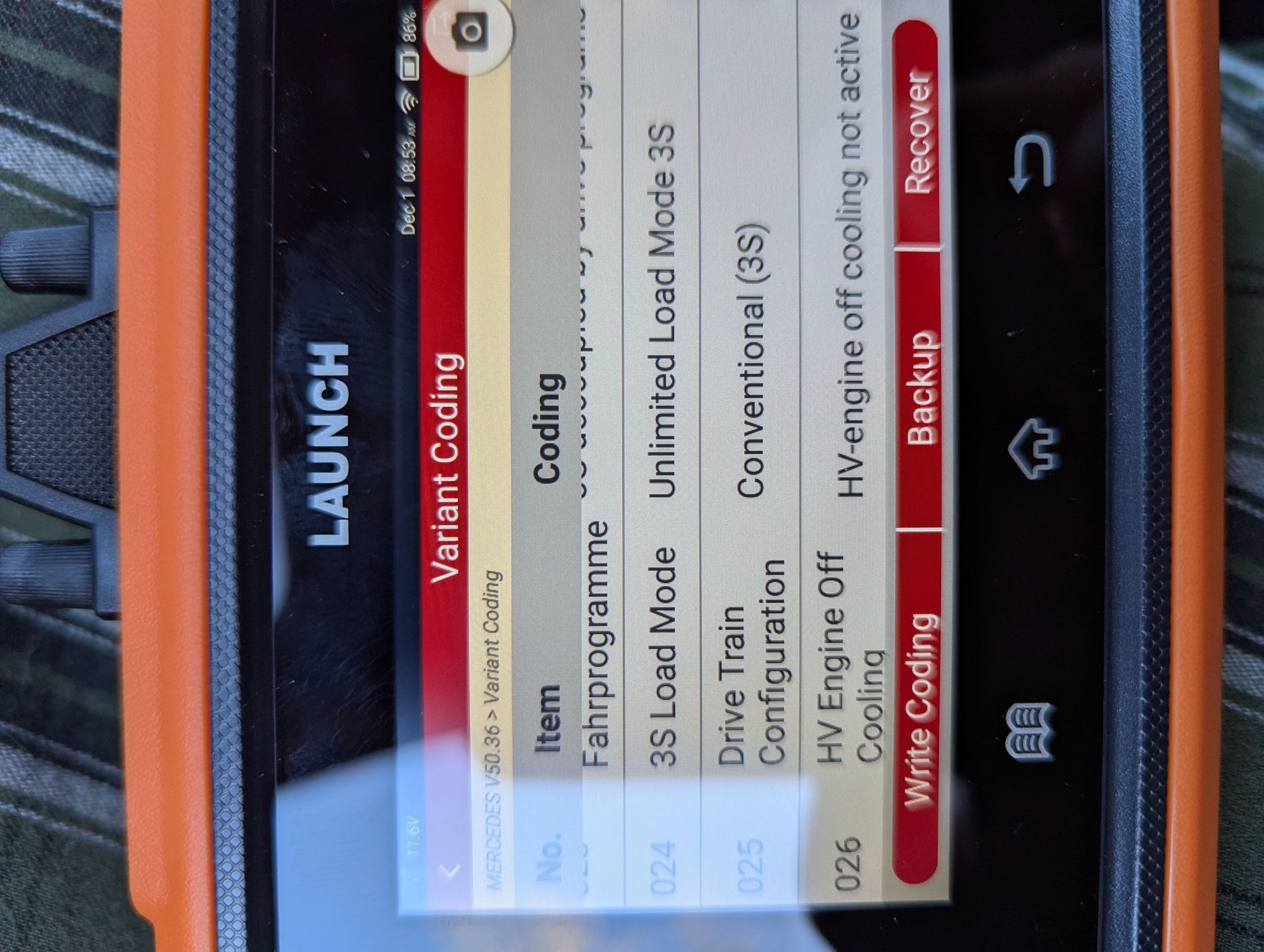

Success! Seems like everybody gets slightly different menus, different wording, etc. but I was able to set my Start/Stop to act in a "last mode selected" manner.
I have the
Launch Creader Elite V2.0 Launch Creader Elite V2.0
with the V50.36 update for Mercedes. I found the options in the variant coding for PTCU under "3S Load Mode". There are a couple different options that give you normal behavior as MB gave us, 4 hour memory of selection, and the winner "Unlimited Load Mode 3S".
Once this mode coding is written, the button on the center console still toggles Start/Stop on and off, but it retains settings trip to trip, day to day. It doesn't matter if you change from Comfort to Eco, etc.
I have the Launch Creader Elite V2.0 with the V50.36 update for Mercedes. I found the options in the variant coding for PTCU under "3S Load Mode". There are a couple different options that give you normal behavior as MB gave us, 4 hour memory of selection, and the winner "Unlimited Load Mode 3S".
https://cimg0.ibsrv.net/gimg/www.mbw...1efaa5ce6e.jpg
neat stuff

I would just like to reply that this also worked precisely as described for my 2019 E300 sedan W213 08 .... and as you say, there were several other red herring "disable start stop" under "special function" and under engine control module that did not work... as well as the totally disabled start stop under PTCU... thank you very much for finding this much more satisfying setting....

I ordered the Launch CReader yesterday and it arrived this morning and I did the Unlimited Load Mode 3S update. I hate the AutoStop function. Now I need to do a search to find what/how to program the vehicle to remember Sport mode.

I have the same scanner. Could you elaborate how did you get to the variable "3S Load Mode"?
Old Apr 14, 2025 | 06:07 PM
vinceleo's Avatar
Joined: Mar 2011
Posts: 74
E450
after "system select", I opened each option and tried variant and implicant until I found 024 Load Mode 35. I can't remember which one it was. It wasn't type of drive
