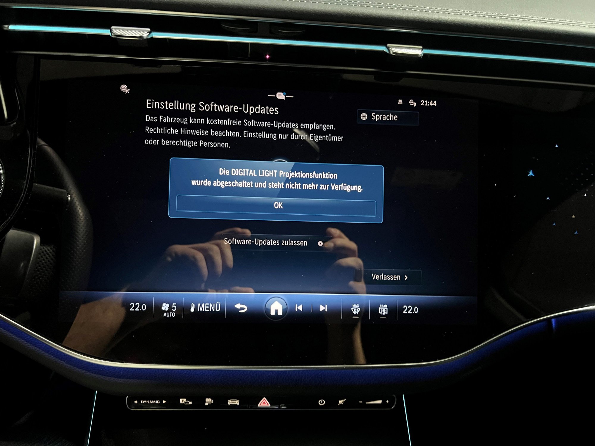

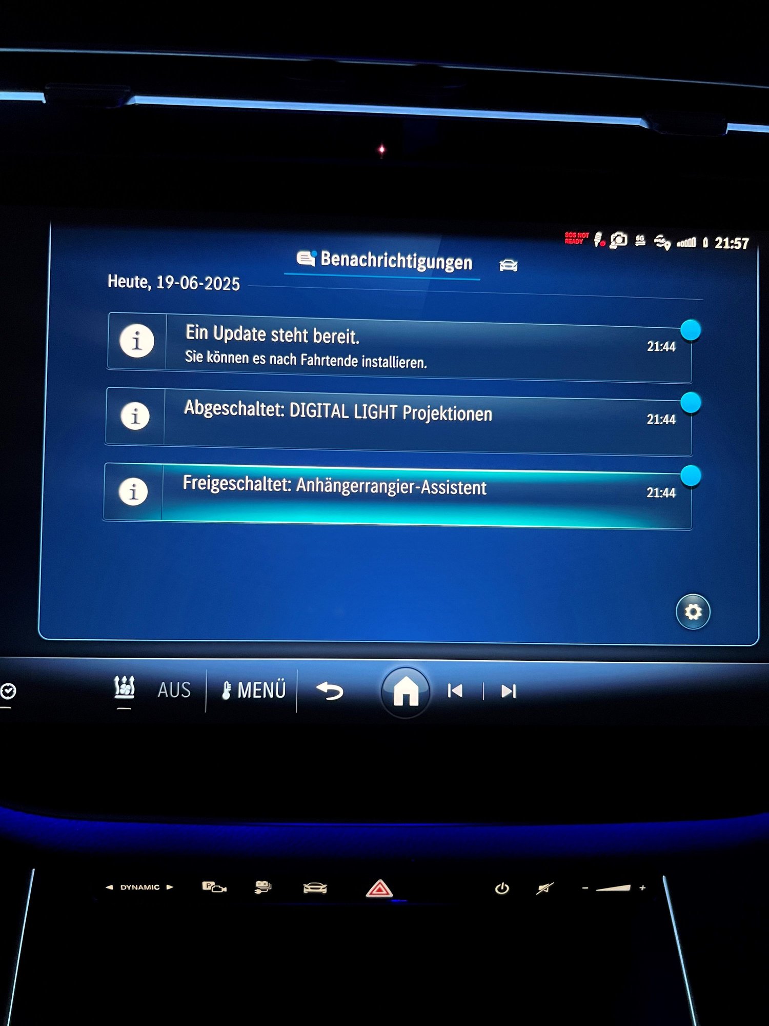

Hello everyone,
I would like to share an update. Yesterday, I picked up my car. The new version of "FreshUp" was installed, but I don't know which one.
Now, I received a message in the MBUX system that the projection function has been deactivated and is not available, see the pictures, its in german.
I'm a step further.
Now, it needs to be clarified how I can activate the option, as I don't see or can purchase it in the Mercedes Store.
Perhaps some adjustments are necessary. I have already sent an email to Mercedes.
I will get back to you as soon as I know more.
Best regards

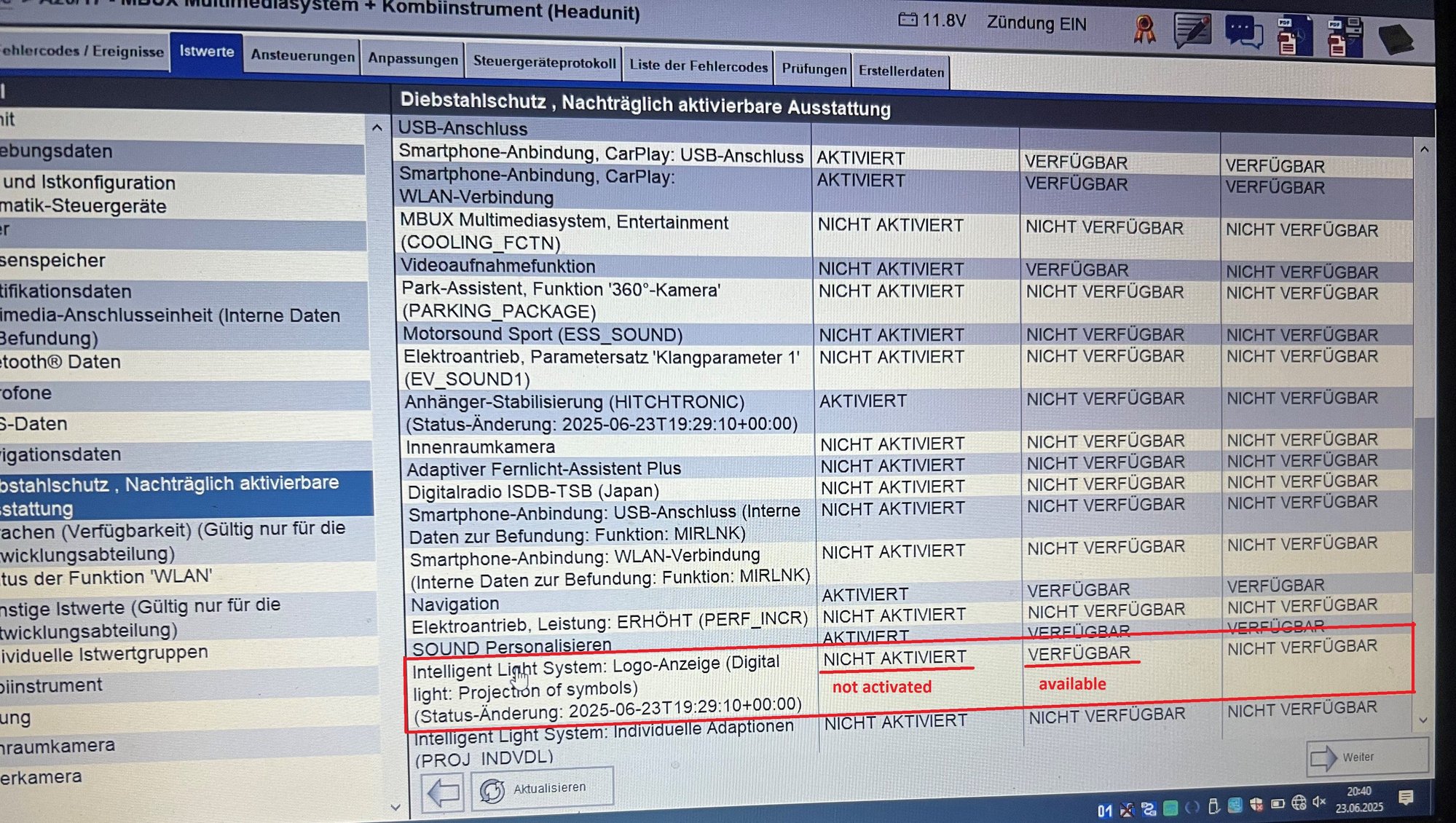

I have diagnosis my car's system. Under the MBUX system, I found an error code, and the error is "B19C100 - System activation failed." Unfortunately, this error cannot be cleared.
Then I discovered the following under "Live Data," see the picture.
"Digital light: Projection of symbols" is available but not activated. I suspect that something needs to be done at this point.
Today, I will visit the Mercedes workshop and ask about it.
