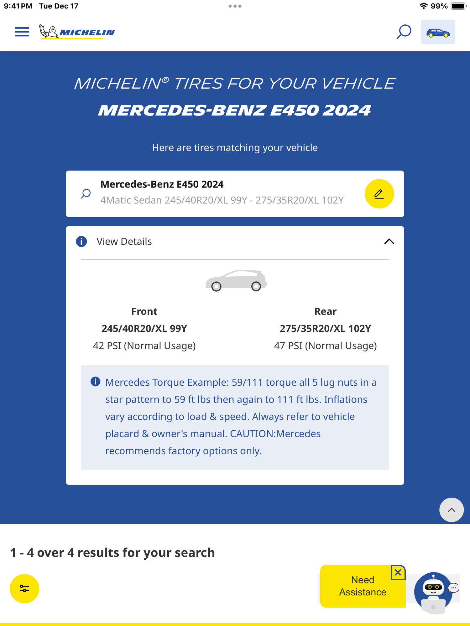

From Michelin website: Mine’s a 2025 but it wasn’t listed yet.
Looks like the car betrayed MB and followed Michelin.
That is on the high side for these wheels imo.

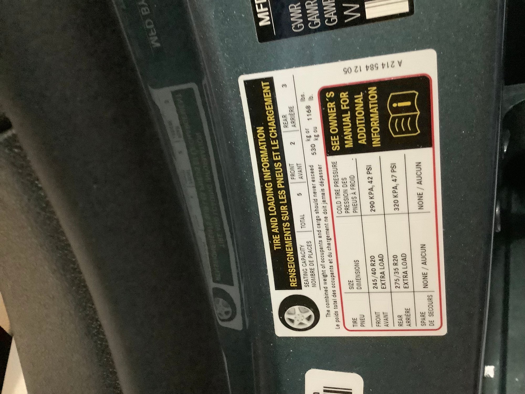

Heres a shot of my sill sticker. Sorry for the wonky orientation. My fuel door decal is the same as your pic above.
https://cimg3.ibsrv.net/gimg/www.mbw...aafc6dd75.jpeg
Thanks don't worry about the picture quality, problem is you quoted the wrong person : ) All good though : )
