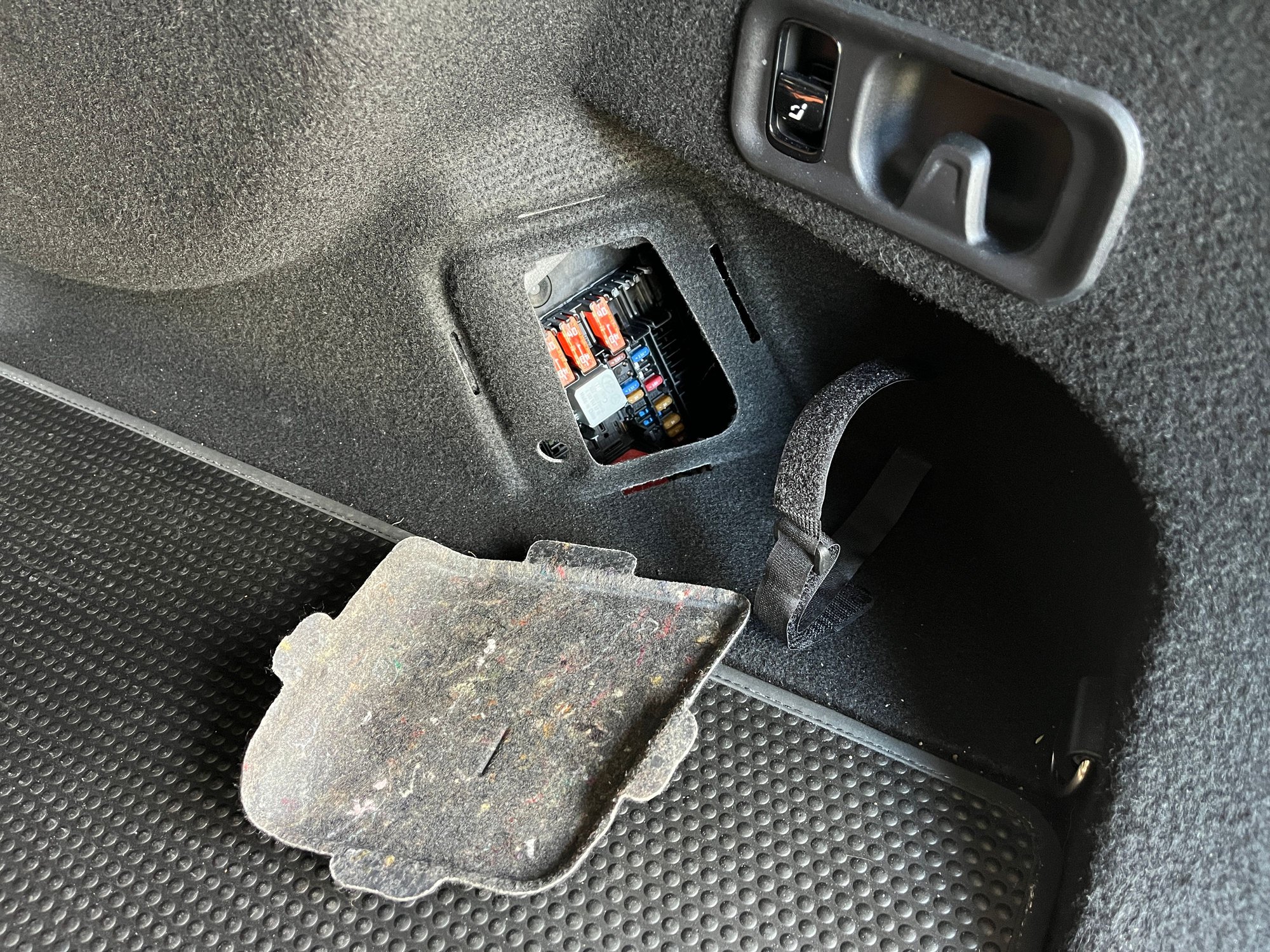

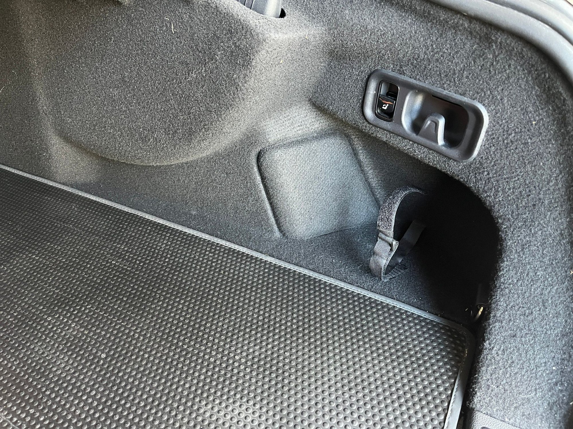

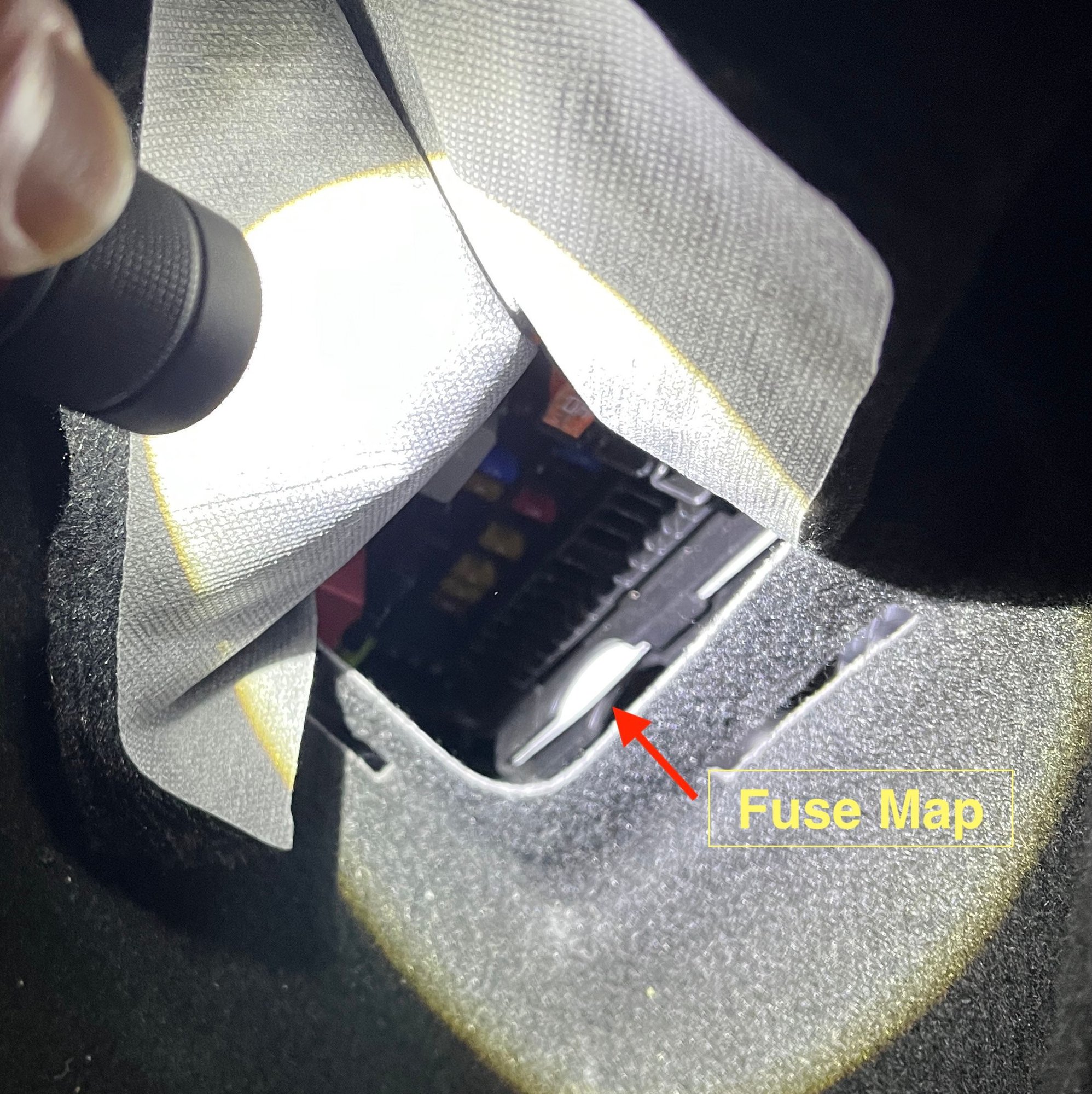

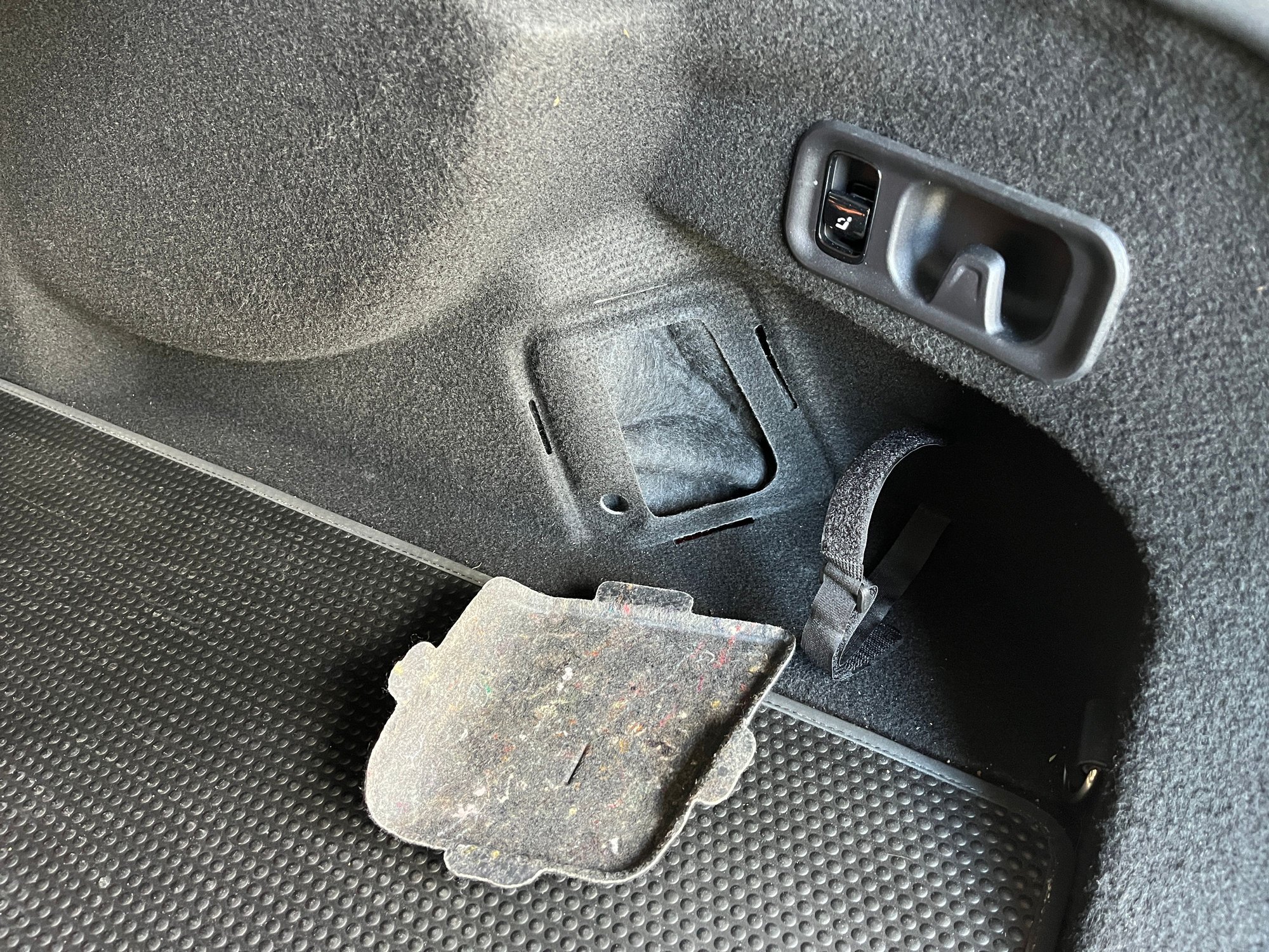

There is a small access cover in the rear corner of the passenger side of the E53 trunk. Removing the cover exposes the fuse block which contains a slot to store the folded fuse map. The fuse map provides details for all of the fuse blocks in the car. It's very difficult to remove the fuse map and equally difficult to change a fuse. I decided to store the fuse map with the owner's manual rather than struggle to insert it back into the fuse block storage slot. If I ever had to change a fuse in this compartment, I would enlarge the opening under the access cover so that the opening started closer to the four slots for the access cover tabs.
Fuse block access cover in place.
Cover removed, shroud in place.
Shroud tucked behind trunk liner.
Lower fuses are 2
Lower fuses are 2" below opening.

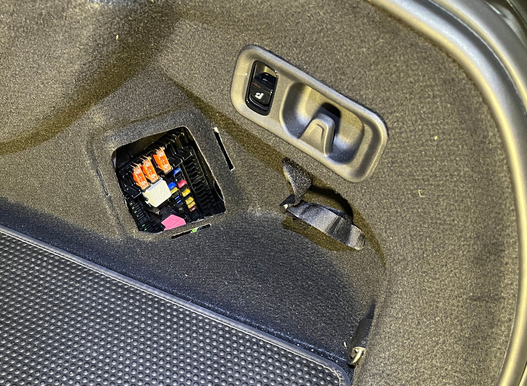

Made the fuse block access hole larger to facilitate changing fuses.

E53 owners are likely to lose a few fuses while attempting to remove or install them in the rear fuse block.
