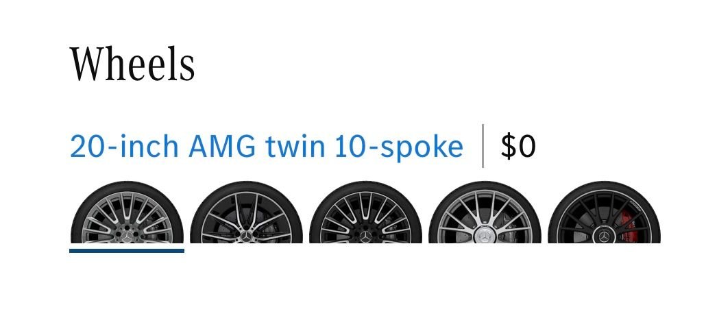

Yes, it is the E53, and these were my options in terms of wheels.

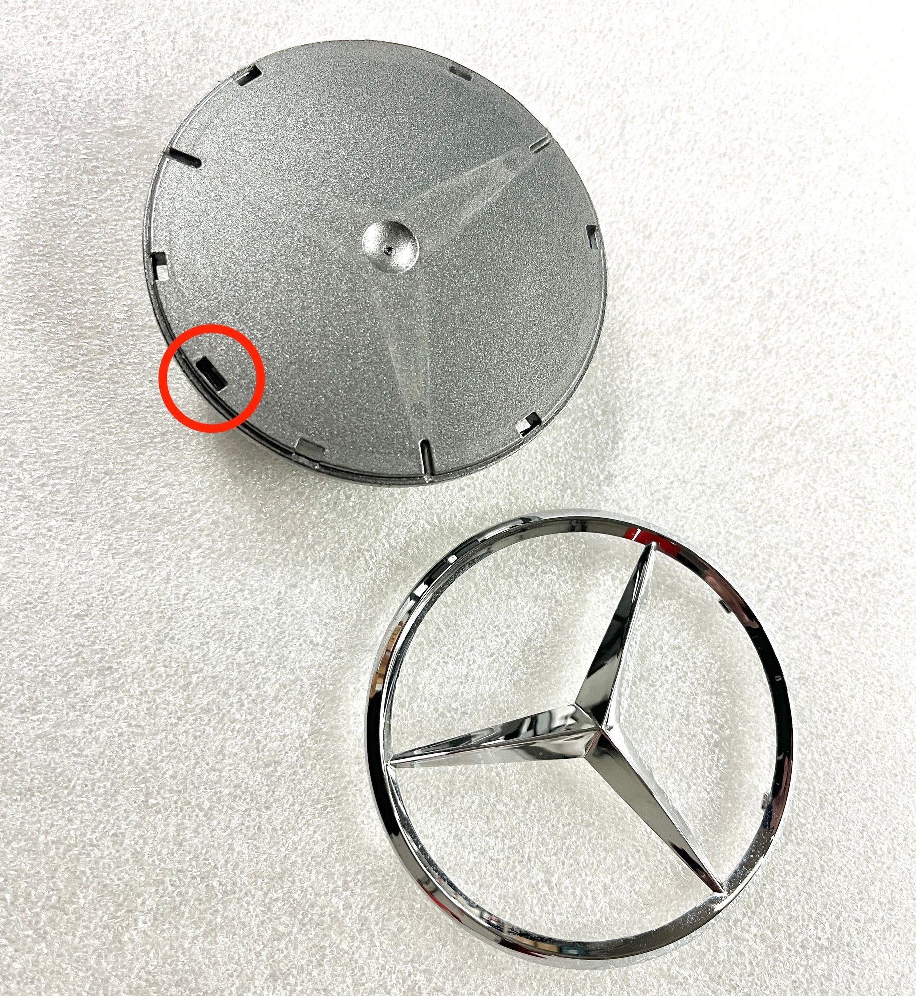

I removed the star emblem on one of the center caps from my E53 to wrap it with red 3M film. I decided against changing the color and disassembled the cap to remove the film. The stars are secured to the cap with small tabs, not any type of glue. They are "keyed" so there is only one "correct" position. It's fairly difficult to remove the star and I cannot imagine it falling off unless someone tried to pry the cap away from a mounted wheel rather than pushing it out from the backside of the wheel.
Disassembled center cap.
Disassembled center cap. "Key' slot circled in RED.

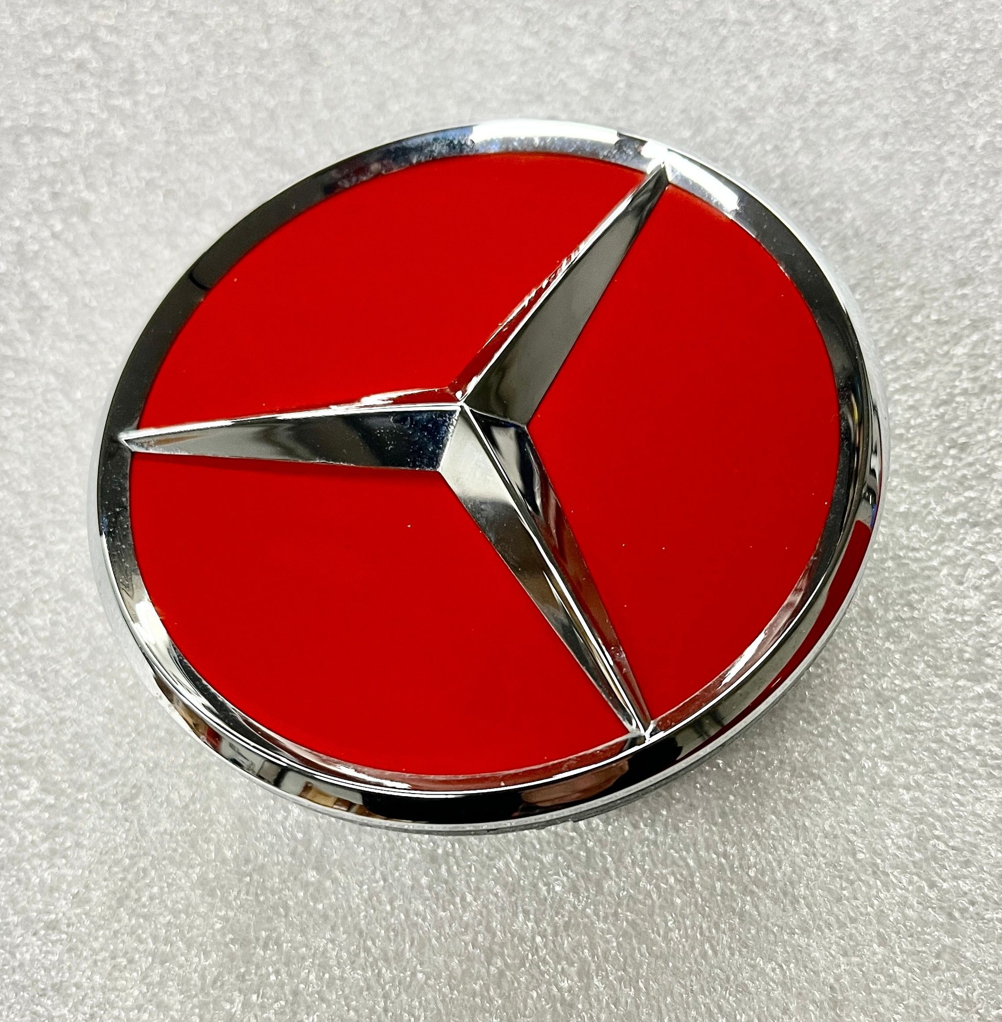

Red 3M film applied.

Thank you for this, didn't even know the star can easily come out. The older model's MB logos don't have those tabs, specifically talking about those with no Mercedes-Benz logo.

This might be true for your car, but not for mine. My car had the tips of the star with a small amount of glue.

Did the entire star and ring fall off? Or just the three pointed star? Are you certain that someone has not broken the center cap and then attempted to repair it with glue? I find it very unlikely that MB would have more than one type of center cap for the W214 E53. The next time I have the wheels off I will snap a picture of the part number on the back side of the cap.
