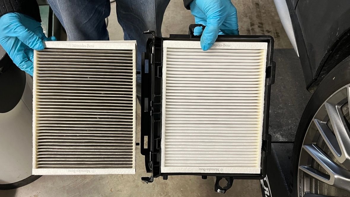

Originally Posted by regor60
Peering into the box on the passenger side I see the battery through there but I do not see anything that resembles a filter. Also didn't see anything in the box on the driver side so maybe there are no filters
The filter housing is directly above the battery. The two filter part numbers in my E53 are: 1) 254-835-01-00 Fine Particle Filter, 2) 254-830-14-02 Dust Filter.
