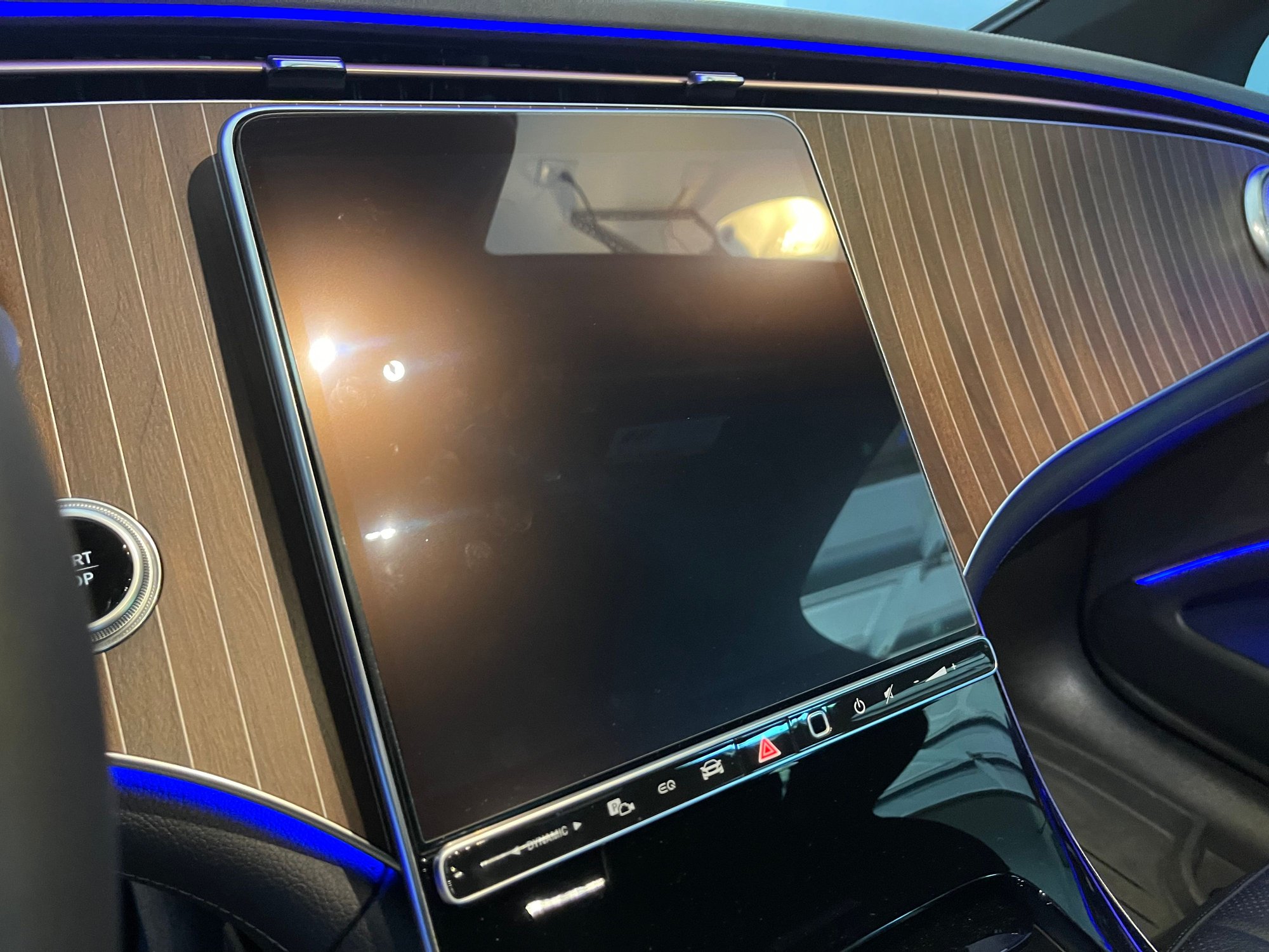

I have a 450+ with the normal center screen and today it went completely blank. In addition, my getting error messages on my center display telling me that parktronic, park assist and sensors are inoperable.
Does anyone know how to reset/restart the MBUX display? Also, any idea if the sensor messages are related? TIA.

I had the exact same problem this afternoon. Error messages and blank MBUX screen. Outside temp was 102 (cool day for Vegas!) car had been sitting for about 2 hours in the sun (ceramic tint windows and weathertech sun shade). Started the car, received the warnings on the drivers screen, MBUX blank. MBUX screen was extremely hot. I let the car cool down for about 30 minutes. Then shut down. About an hour later, climate control cooled the car for about 30 minutes via departure control. When I started the car, everything worked normally. Needless to say, the car has sat in the sun in MUCH warmer temperatures without issue, but this is the first time the MBUX was almost too hot to touch. Seems like the MBUX was still generating heat while off and overheated. Thoughts? Bought the car in May, currently has 4500 miles.

I doubt the screen consumed any power when the car was parked. In any case if it was just the screen blanking because of excess heat, the control unit should still run and the display should wake up when it has cooled down enough. The list of fault messages would be shorter too.
