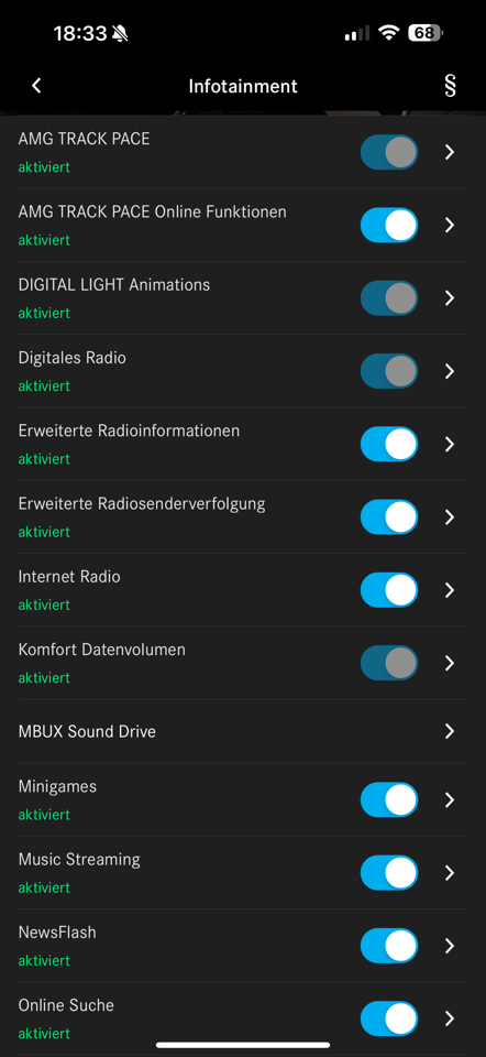

MBUX 2.6.1 (E505.404) is currently being rolled out OTA. I have not received it yet.

I thought Sound Drive was going to be only for AMG, but maybe that's no longer the case.
Anyway, there's some good looking stuff in here, so I hope to receive this OTA update at some point, even though I do not have AMG.
If you haven't received it yet, how did you get these pix? I assume somebody you know has received the update for real (vs. marketing promo from Mercedes...).

In a German car forum and in 2 Facebook EQE / EQS groups, some users reported that they have already received the update.
Sound Drive does not seem to be activated yet, but it is already listed as a service in the Mercedes app after the update. Sound Drive will be available for AMGs as well as for AMG Line vehicles in various model series.
MBUX Sound Drive Homepage
"The launch of MBUX SOUND DRIVE will start at the end of 2024 and will be available for Mercedes-AMG and Mercedes-Benz with AMG Line vehicles equipped with the second generation of the MBUX (Mercedes-Benz User Experience) infotainment system. As customers you will receive a notification when the MBUX software update is available in your region. You will then be able to download and install it over-the-air (OTA) using the update assistant on the MBUX media display or in the Mercedes me app."
