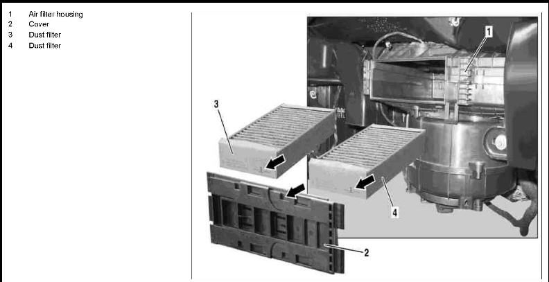

There is a cabin filter, it is under the pass side of the dash. Replace it first, or ideally, pull it out, do the evap cleaning stuff with the lysol or whatever (if you don't remove the filter it will just hit the filter, not go into the fins), and then install the new filter.

Could you please guide me to that. I had it apart and only had access to a tube that connected the system to the rear of the car and the passenger side footwell. I removed the little metal clips in the video but could not pull the rest of the *** apart because the other clips were well into the center behind the dash. It seems like I would need to remove the entire center dash to access it, I don't think a simple cabin filter would be so hard to remove? I'll take it apart again and take pictures.

I found this picture of the location in an ML. I'll see in a few hours.

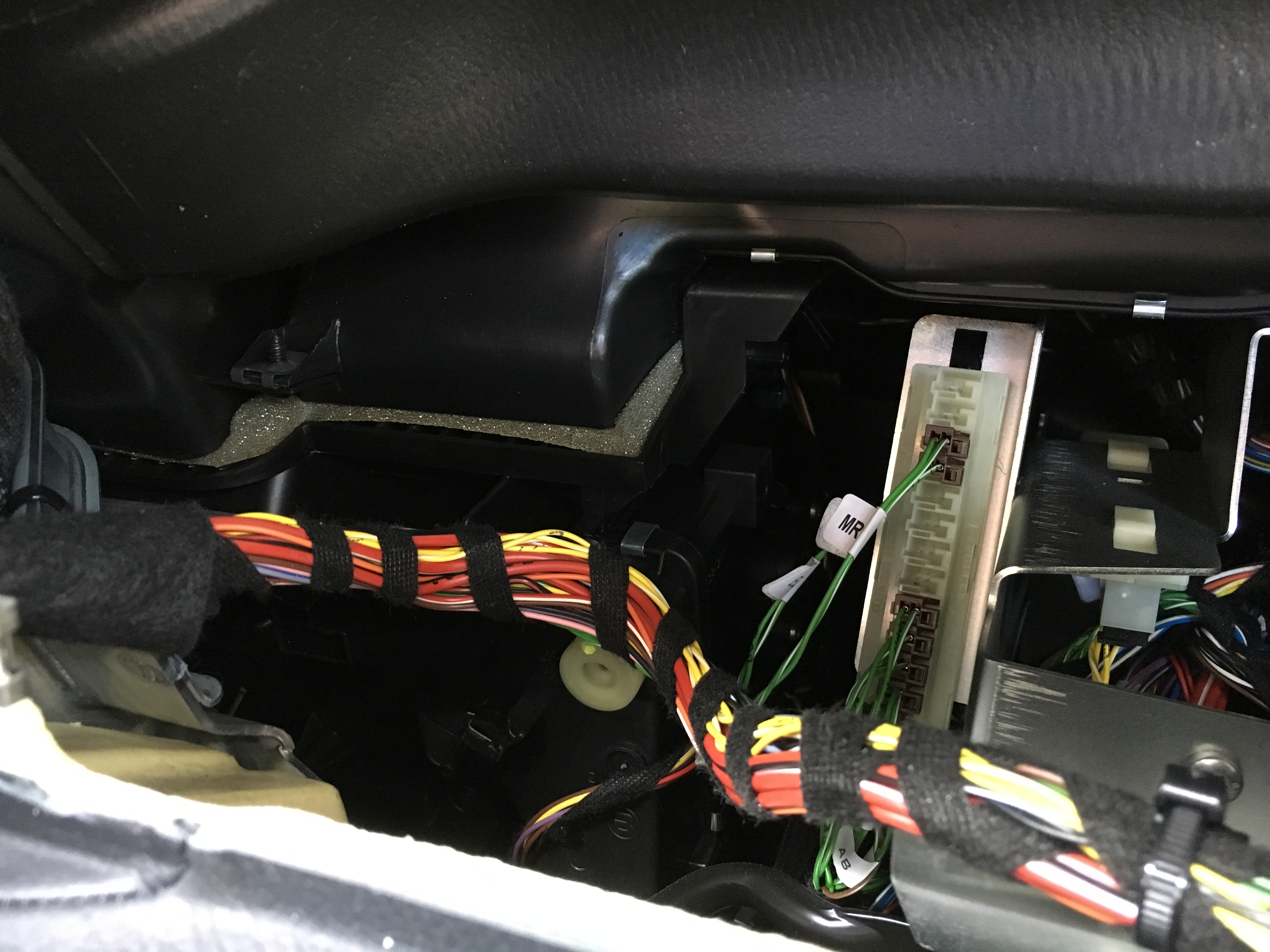

This is the view behind my glove box. I'm not sure but the sloppy mess of foam sticking out doesn't look right?

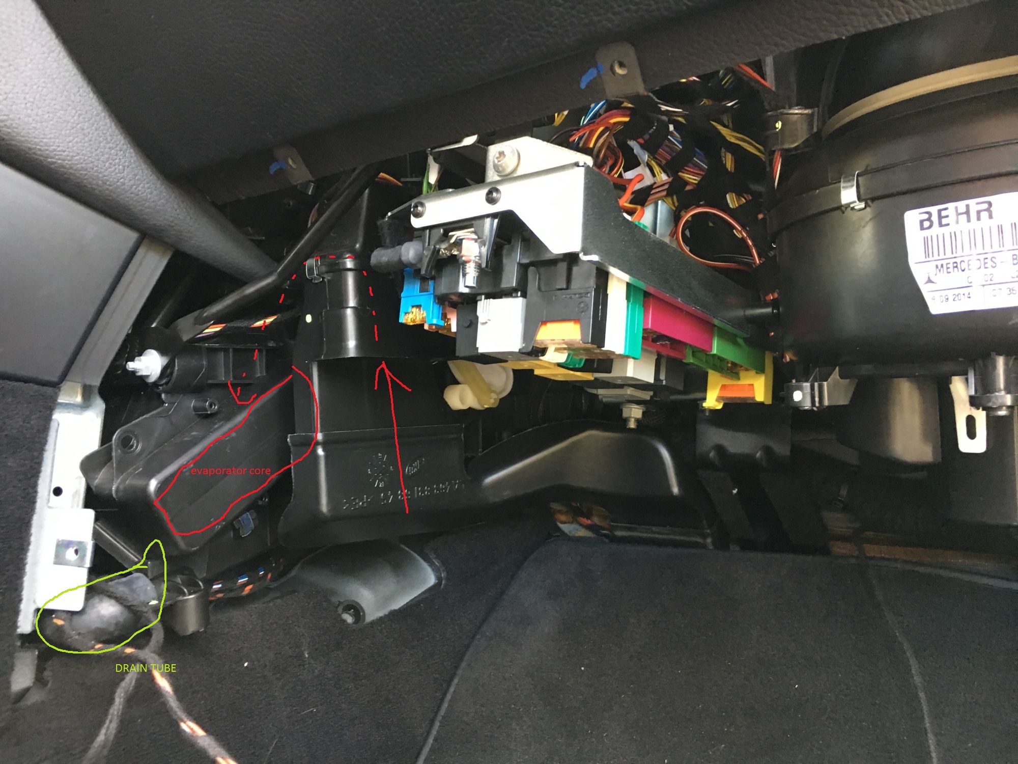

And this is a view underneath w the passenger trim removed. I assume the far left is the evaporator which I can't/don't want to take apart.

Ok I was able to get that out but it doesn't smell. I gave it a febreeze treatment while it was out. I did however get access to the evaporator this time from under the passenger side. Hopefully this takes care of it.

So far so good! It's only been a day so fingers cross. I was able to access the evaporator through the passenger side foot area (see pics). This time some brown/yellow nastiness came out of the drain tubes. While I was there I checked the drain tubes and they are not clogged. Hope this helps someone in the future. Thank you all!
