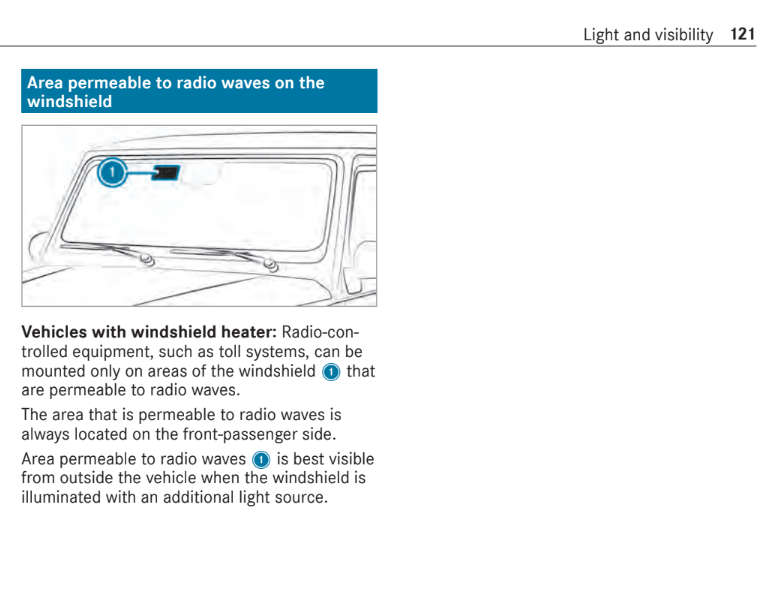

It can only be mounted just to the right of the rear view mirror. In your owners manual is a picture of the area.

From the manual
Attached Thumbnails Valentine 1 radar detector and polarized glasses-capture.png

awesome, thanks for the info! Do all US vehicles have this windshield heater or is that an option on only the cold weather package cars?

All US G63's have the windshield heater. Also I have the widescreen and wear polarized sun glasses. No issue at all seeing the screens.

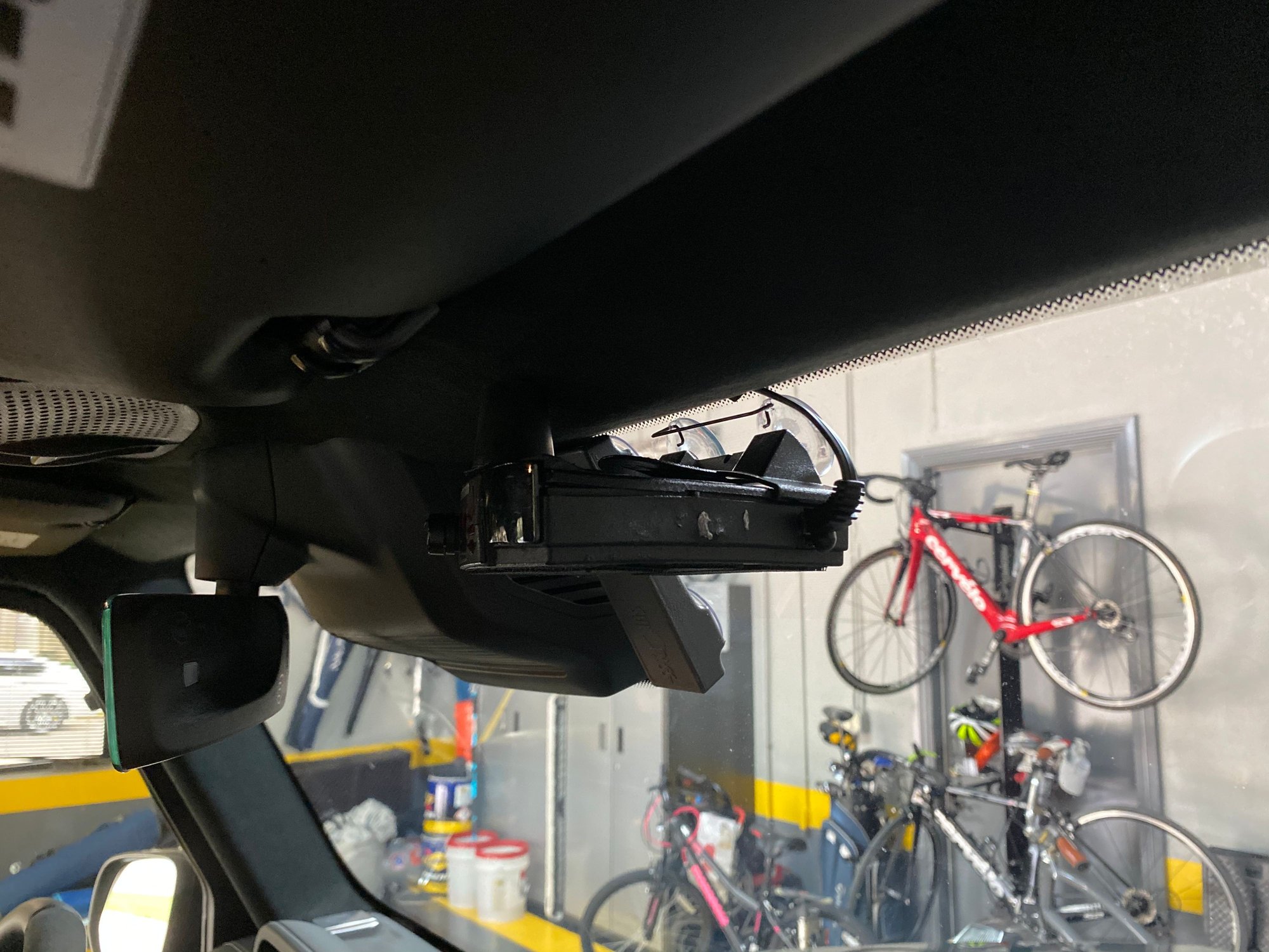

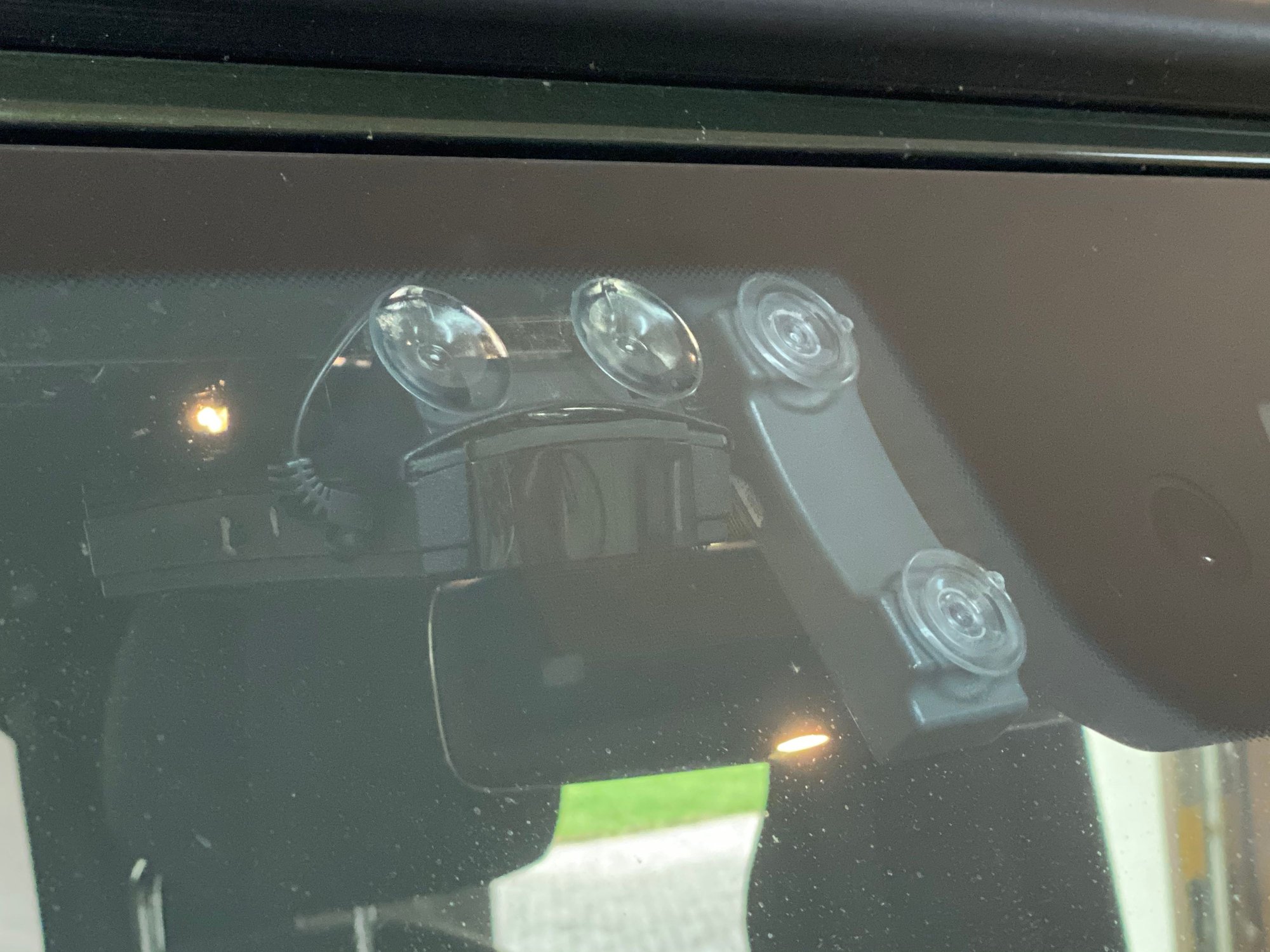

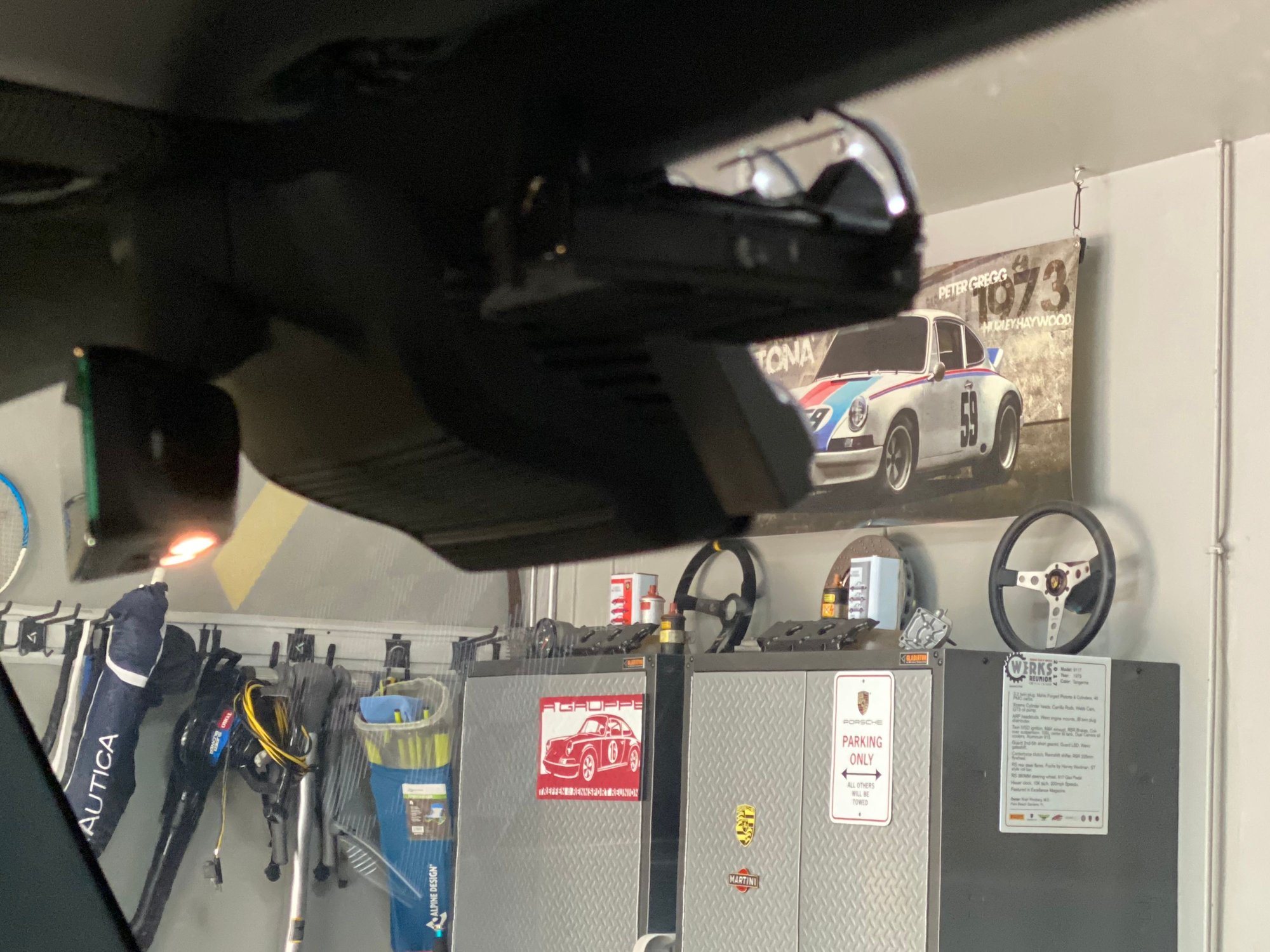

Got V1 to mount nicely after some fiddling. Here is what I did. Did hidden hardwire install to SAAVY module into OBD port. Angle of G windshield not friendly to mounting angle of detector. When you put it on windshield if points at the hood. Do below and it will point in right direction. Make sure using new larger suction cups as if they are hard and dried out won't stick well enough. Position V1 high up in area where windshield has transparent opening that doesn't block detection. Wet suction cups and put V1 into first click on windshield mount. To get V1 pointing in right direction I used a rubber test tube stopper that I had on workbench from another project. Picked up bag of them on amazon for cheap years ago. They make bunch of sizes. Tons of other things you can use for the spacer. Just look around and see what you have of right hight. You attach the stopper to the V1 with one of the 3m tape tabs that Valentine supplies for install. With V1 high on windshield the stopper is in perfect position to push it so sitting flat. See picts below. Hope this helps.
thanks for the write up and photos!

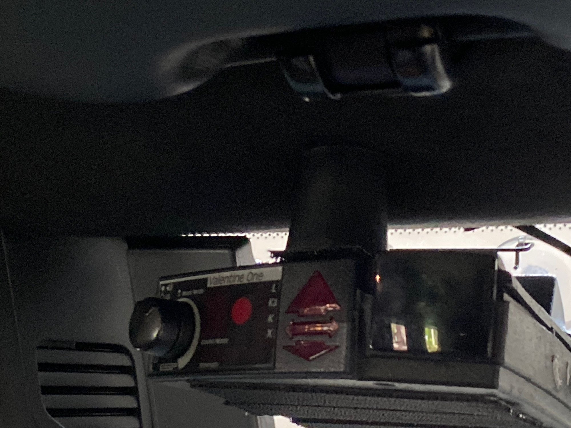

I can see the V1 arrows to right of my rearview mirror in that position. Works great. Have the V1 accessory module but didn't need to install that. Unit hooks up great with Savvy into OBD port put I get an alert I need to turn off every time I turn car on. OBD doesn't like things being kept in. No issues other than annoying alert. just hit that when I turn off stupid lane keeping assist.

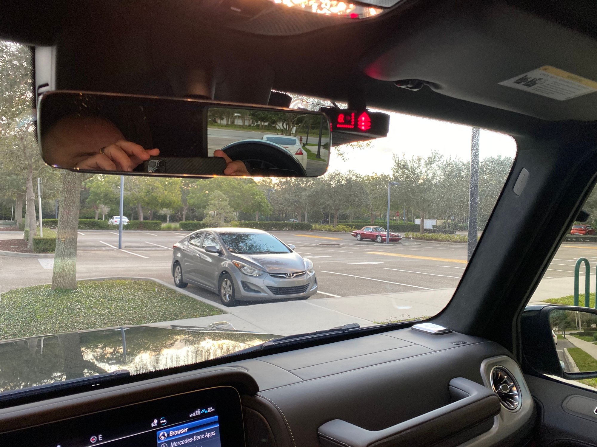

picture of V1 from drivers seat. you can see the arrows just fine. just mount it as far right and high as possible in the window foil gap. leaves room for my EZ pass to right of detector. don't mind my big skull in the rearview mirror.

Seems better viewing wise than my 360 but I am afraid to be looking top right while driving on highway frequently.

I can see it when I look at rear view mirror. No need to look unless it's setting an alert which with custom sweeps almost never happens. If it chirps there is a cop around. you can mount V1 accessory module in different more centered spot or use smartphone as display if you buy the bluetooth module. Have had my V1 for 15 years now and have upgraded it with new electronics 3-4 times to keep the internals current.
