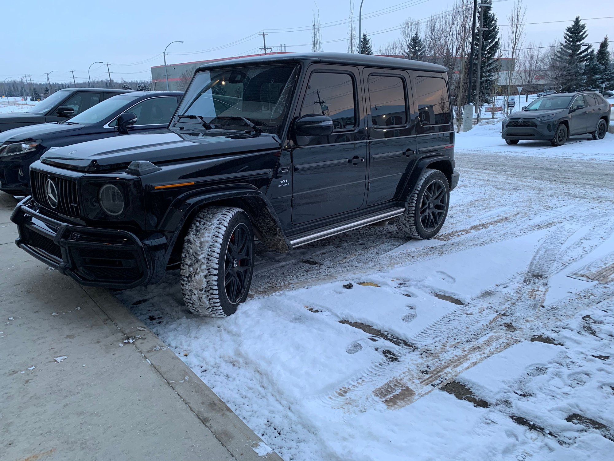

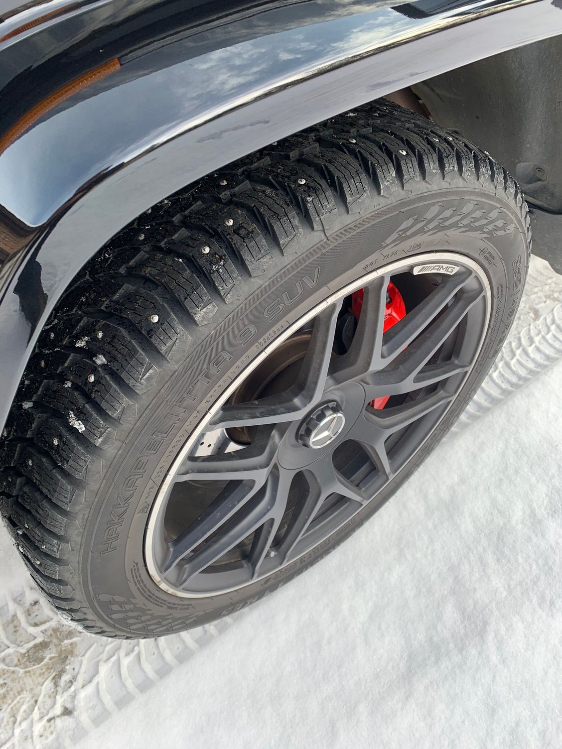

Yes I do. No issues at all. I had 285/40r22 originally but didn’t like how small they look plus the ride quality. Got the 285/45r22 this season and love em. I run Nokian Hakkapelita 9 Studded tires. Here’s some pics..

Looks great...thanks for sharing! Not sure where you live, but I wish MN would allow studded snow tires.

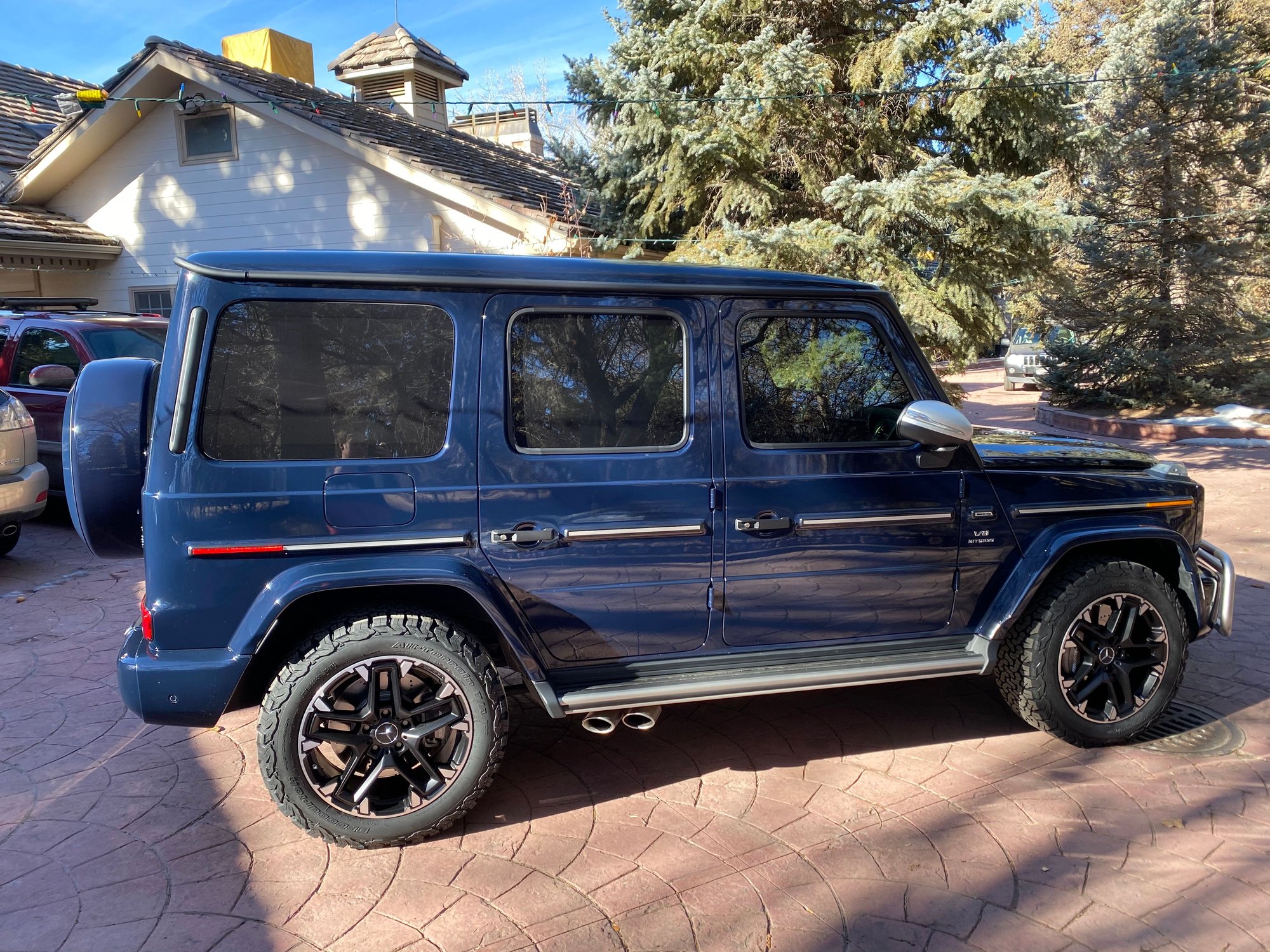

Just installed a set of the 20" trail package wheels with 275/55R20 BFG K02s. Love the look, just waiting for it to snow so I can get the car out on some back roads in the Rocky Mountains.
