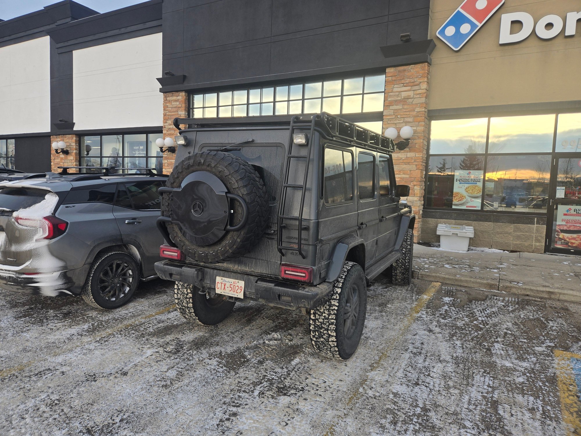

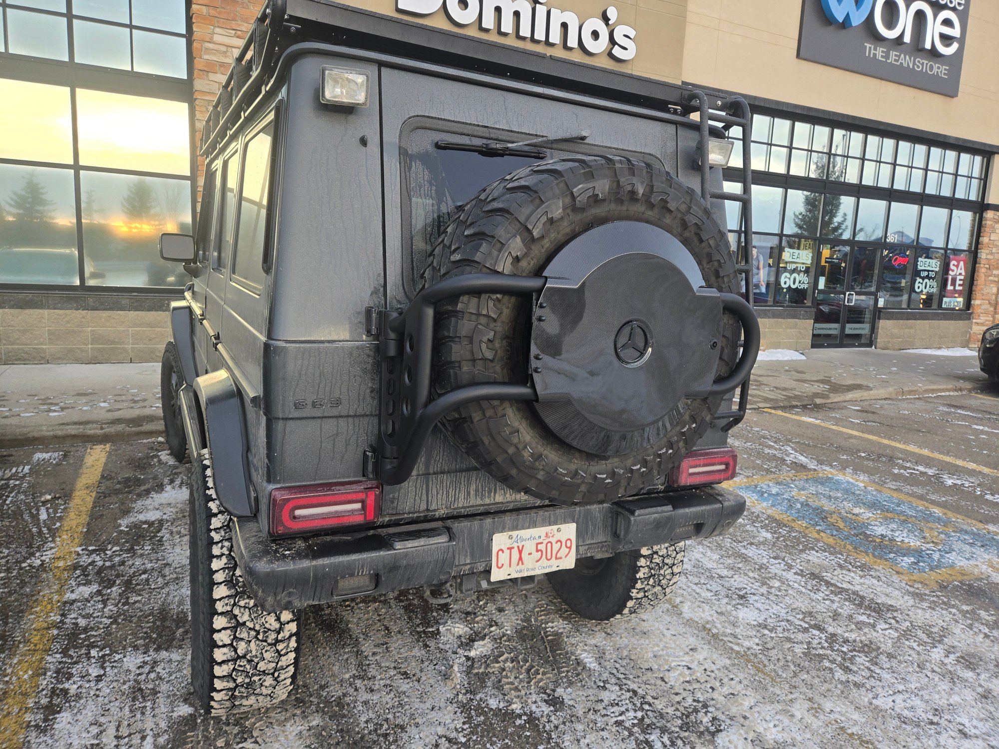

I just finished installing my letech style carrier.. I ordered something similar on Alibaba for around 3k I believe. I just finished getting it installed today and I'm leaving for about a month tomorrow. Need to do some more adjustments but it seems very solid.. I think 37s are the max as the spare is a 37x13.5 and it's touching the carrier brackets..
