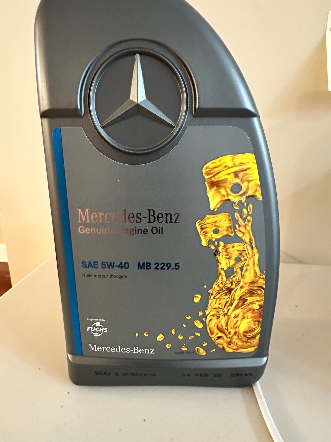

Hi all,
Seems to be some fuzziness regarding the exact proper oil weight for the 2025 G550. In the owners manual it mentions 0W-20 or I believe 5W-40. I've seen multiple different weights mentions here and elsewhere on line.
I just hade my first oil change done at my MB dealer, according to the service paperwork they used 0W-20 Mercedes Benz oil by the quart (not bulk oil), on the quart bottle it says its made by Fuchs?? I asked for an extra bottle to keep with me just in case, but the extra bottle is 5W-40.
So I ask.......What brand and weight do I want for my 2025 G550?
Many thanks

How much did you pay for the extra bottle?
$14.76

Several other forum threads discuss oil weight, and there seems to be a preference for 40 weight, as it retains better viscosity and lubrication at engine operating temperatures. I'm about to change my '19 G550's oil (4.0L V8 TT) and will be using Castrol 5W-40 Eurocar (API SP and MB 229.5). There's been a lot of discussion about 0W-20 sacrificing engine wear for fuel economy. GM's recent recall on its 6.2L engine failures include re-spec'ing 0W-40 in place of 0W-20.
BTW, FCP's price for the Fuchs 5W-40 MB229.5 is $32/5L jug if you're a DIY'er.

So if I’m understanding correctly, 5W-40 would be better for wear protection than 0W-20?
And regarding Fuchs oil brand. I have never heard of Fuchs oil before this latest oil change. No idea where it ranks in comparison to LiquiMoly, Mobil1, etc…
Bottom line, I want the best oil and the best weight for longevity

MB engine oil specs are found at https://operatingfluids.mercedes-ben...ory/engine-oil. They do their best to make this all very confusing, but Sheet 223.2 summarizes oil specs by engine type. The 2025 G550 has the M256 engine (I think this is correct), and the 223.2 chart specs Sheet 229.71 and .72 oils for the M256.8 variant, 229.51 and .52 for the M256 Hybrid variant, and any of these for the M256.9 variant. Confused? I am. But from the footnotes, I conclude that 0W-20 should only be used in engines specifically designed for it, but this doesn't mean that these engines can't use a 30 or 40 weight oil (with a possible fuel efficiency penalty). An excerpt from a MB technical document on the M256 engine states that any of 229.51, .52, .61, or .71 are compatible (see attached).
It's interesting that the liter bottle of 5W-40 you bought is MB 229.5, and is not one of the low ash variants .51 or .52. I've been using MB 229.5 oils, and do oil/filter changes every 5K miles.
