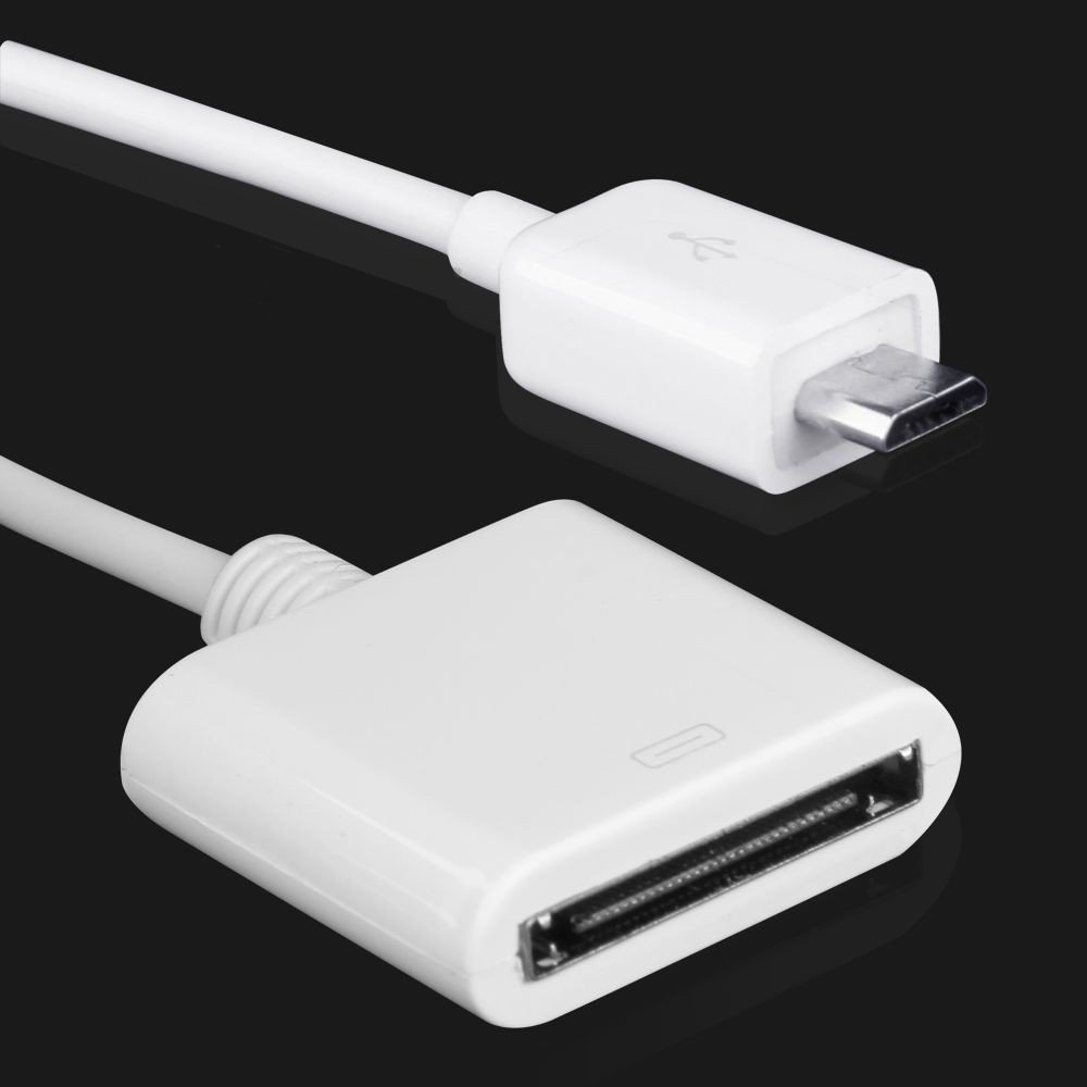

I like the idea of this, but is there a way to make it even cleaner?
Can you pull the power from the iPod dock with a cable like this (below) to power the Aluratek or BB gateway and then use the standard 3.5mm audio cable for the sound?
Anyone try this?

That's what I did - use the ipod cable for power and send audio over the aux input. I posted about it in another thread: https://mbworld.org/forums/5309830-post55.html
In short, I used this cable to provide the power: dockBoss+ by CableJive (it has to be the "+" version).
Amazon Amazon
It's a little pricey ($30), but it was the only one with the female 30pin that I could find at the time. There are cheaper cables out there though, like this one ($9): http://www.usbfever.com/index_eprodu...oducts_id=2736 .
