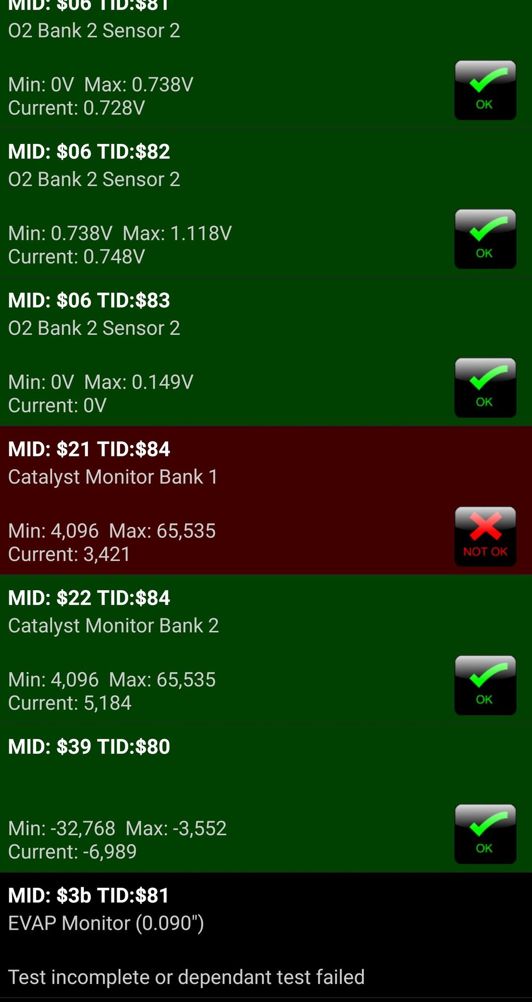

My 2007 GL450 is throwing two CEL error codes:
​​​​​​P0410: Secondary Air Injection System
P0422: Main Catalyst Efficiency Below Threshold (Bank 1)
I think I have the P0410 one addressed, but the second one, P0422 showed up. Now, it could be that it has been there for quite a while, because I just bought this truck and know that the catalyst cycles can take some time to show up if the seller had the battery disconnected (which I suspect is the case). Truck has 197K miles on it. Yep. That's a lot. But other than these, one front strut airbag (which I will replace with an Arnott), and a weak rear lift hatch hydraulic, it's in great shape and worth keeping up.
So, back to the P0422 code... Truck runs well. No secondary issues. Engine is smooth. When I connect my OBD2 scanner and Torque to it and watch the catalytic converter and O2 sensors, it shows that it's barely below the threshold for triggering the CEL (see screenshot). I'm not sure if that reading leans towards the cat being on its way out, or that one of the O2 sensors needs to be cleaned or replaced - or if it's just a red herring. I can't just swap the O2 sensors and see if the error follows the sensors to Bank 2 or sticks with Bank 1 because the O2 sensor cables are different lengths. Anyone have any thoughts on troubleshooting this one?

Which O2 sensor (fore or aft of the Bank 1 cat)?
Old Aug 30, 2018 | 10:07 PM
jtb33's Avatar
Joined: Aug 2018
Posts: 90
From: Arizona
2007 GL 450 (former) and 2012 E550 Coupe
Originally Posted by Plutoe
The resultant one which is aft!
So, that's passenger side, the one that's right on the Catalytic Converter towards the rear of the vehicle (and easiest to get to)? (ie, Bank 1, Sensor 2)
