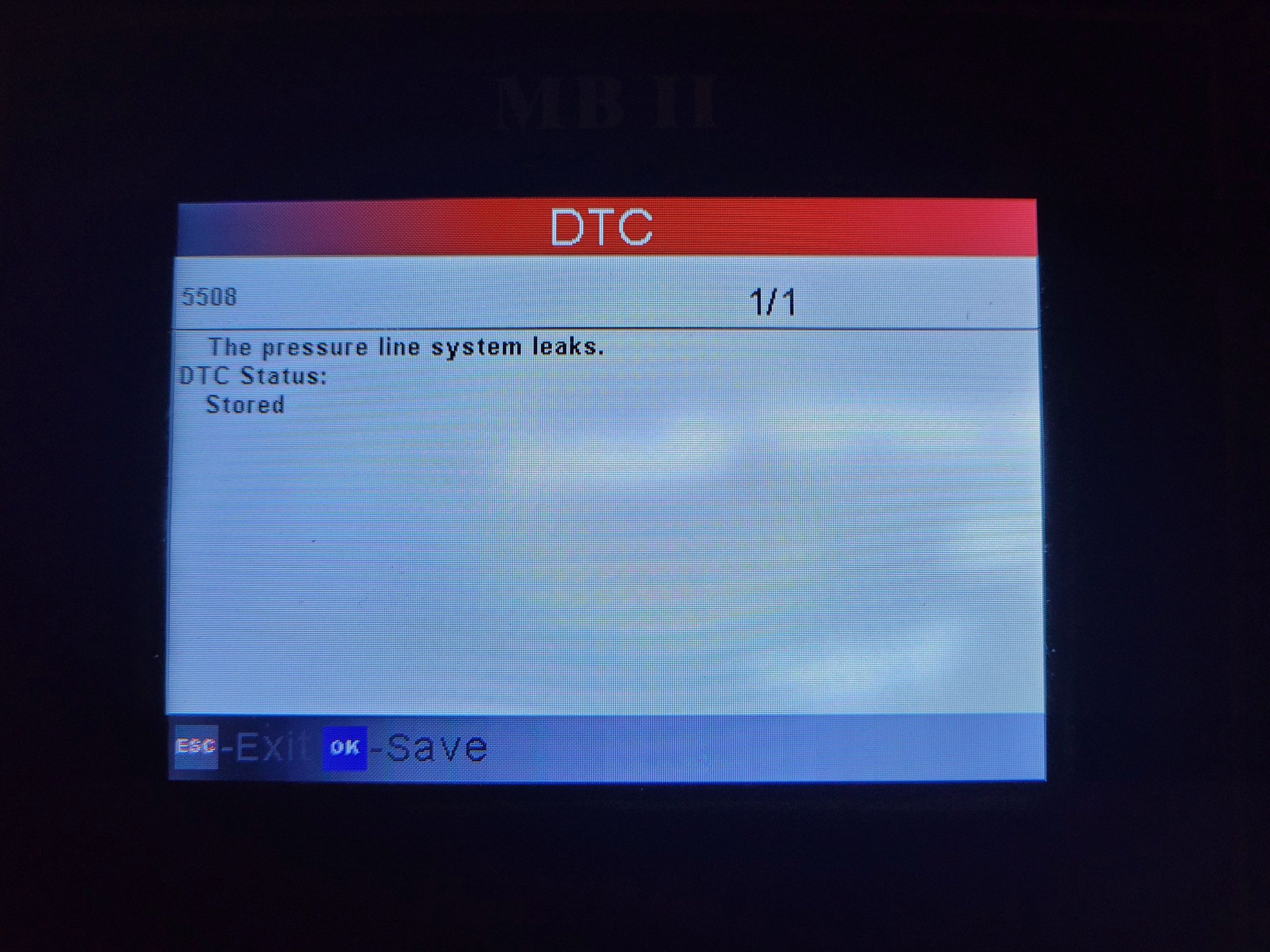

Hi everyone and happy new year! My front left and right air bags are deflated, the rear are raised to the normal level. I have been trying to diagnose the common suspects - bag leak, burned compressor, cracked valve block, fitting leaks. I have tested both FL and FR bags with air from my air bubble and they inflated and held air. I did not hear any leaks while they were holding air and also no indications of leaks after spraying down with soapy water. I don't suspect the compressor is bad as just a few days earlier I had the vehicle in the raised position, but I'm not ruling that out. I turned my attention to the fuse box and found that fuse #108 40a fuse had blown. I installed a new fuse and it blew immediately after starting the vehicle . I took the compressor and the valve block out and inspected them and do not see any visible cracks or leaks, again testing with soapy water. I will try replacing the relay and see where that gets me, if a new relay and fuse does not get the compressor running, does that mean the compressor could be locked up? What would cause that 40a fuse to blow suddenly like that? Any advice on how to bench test the compressor? Thanks for any advice in advance.

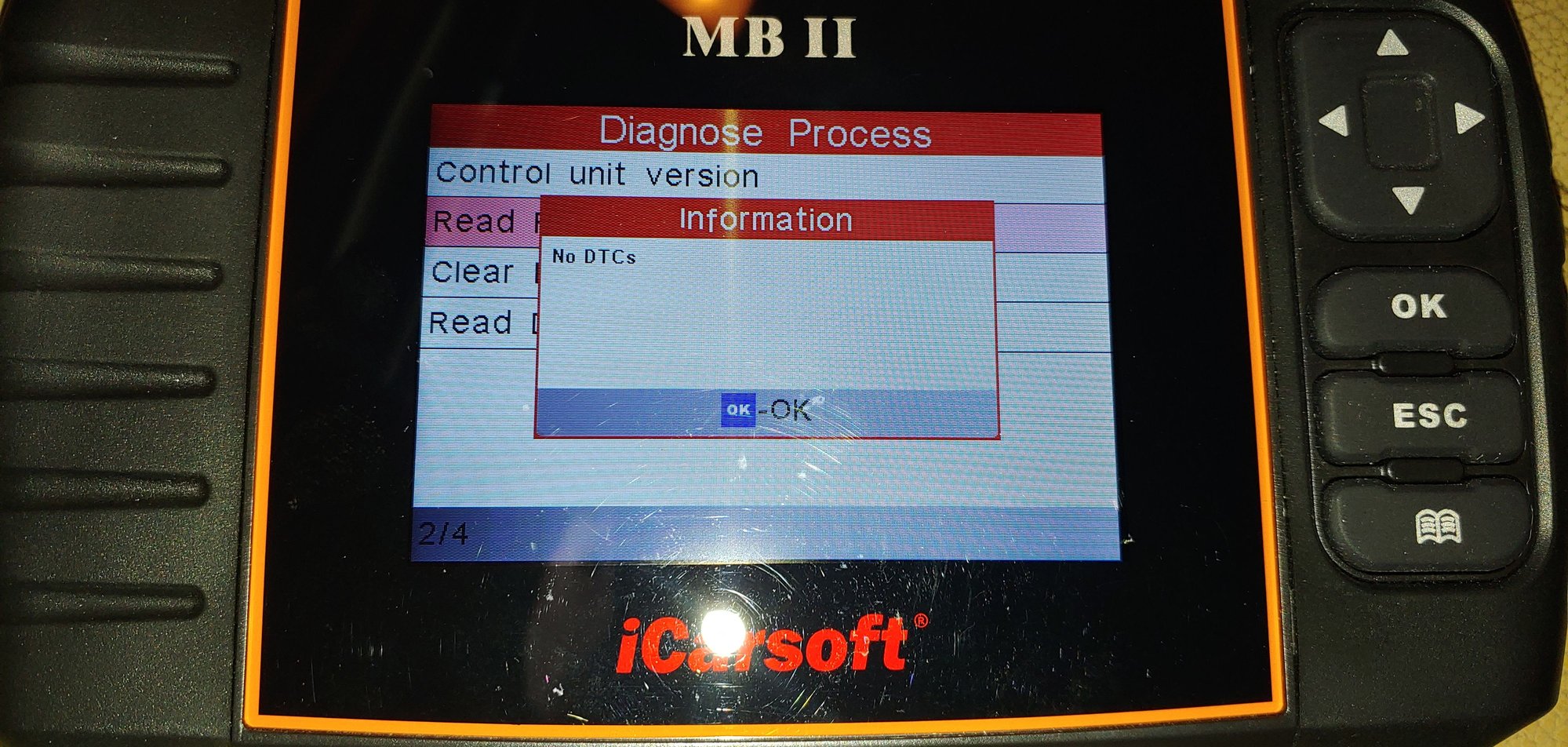

I have the MBII and didn't see that test in there, will look again. Just got done bench testing it and it's locked up. Made a nice buzz and burn smell. Going to replace front shocks/bags as well as there must have been a leak.
