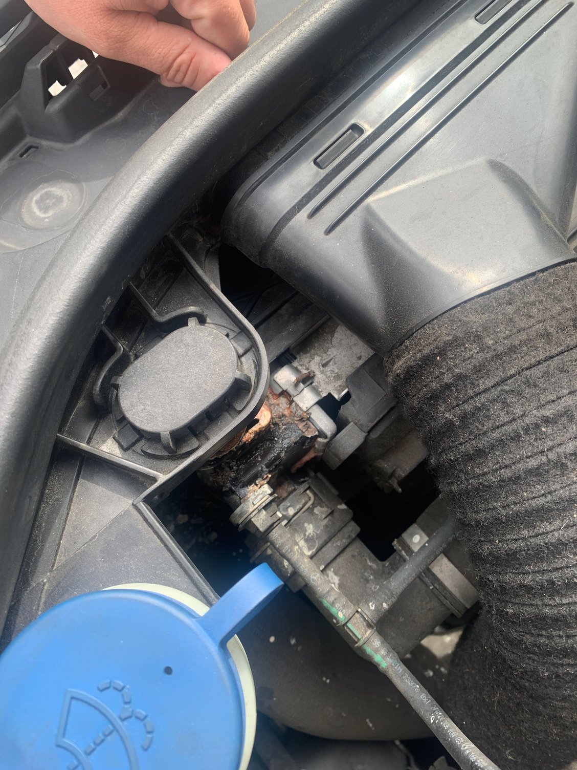

Hello,
Message on the dash came up that coolant was low. I opened the hood and coolant seemed at an adequate level but I will top off to see if after that it comes up again. But upon opening the hood I saw what looked like leaking coolant. Can anyone tell me what they think is going on. I did the AEM update and have the extended warranty, would this be covered ?

Clean the area well with a brush and water. See what happens.

I still haven’t topped it off, did you
get the zerex g40? Idk I think I’m just going to top it off with distilled water.
I hosed off the coolant and have been keeping an eye on it, nothing as of yet.
