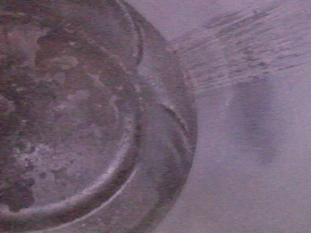

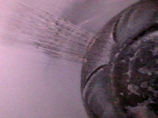

UPDATE: I got 132k miles and done the borescope at 107K and there is wear on cylinder walls. Couple of weeks ago I had a cylinder 3 ignition coil internal fault and replaced 3 and 4 with beru and ordered 6 more to replace all. Long story short, replaced the number 2 coil after the post and noise was gone instantly and sounds more quiet. There was no CEL and drive issue to begin with, maybe coil.was going bad. I will.keep an eye on this and hope it stays that way.
