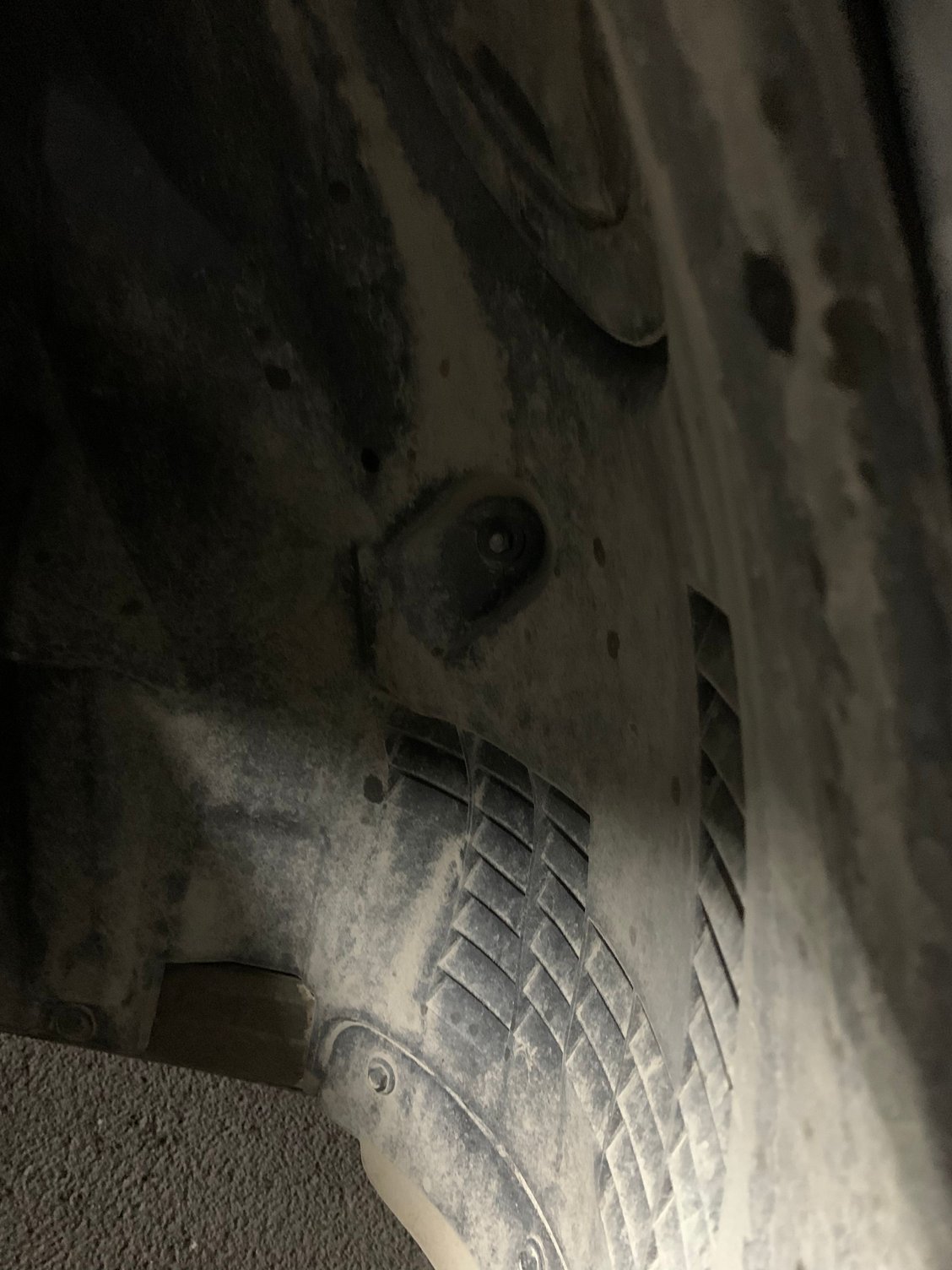

Look at the inside of the tire after you have done your full turn left & right while moving and see if there are any rub marks on the tire.
Old May 1, 2022 | 06:15 PM
Divadtri's Avatar
Joined: Jan 2022
Posts: 48
Glb250
i check look everything normal ,
and under where the wheel turn .and try in park turn full left and right couple time didn’t hear any noise is normal.maybe is the steering wheel noise why running?
