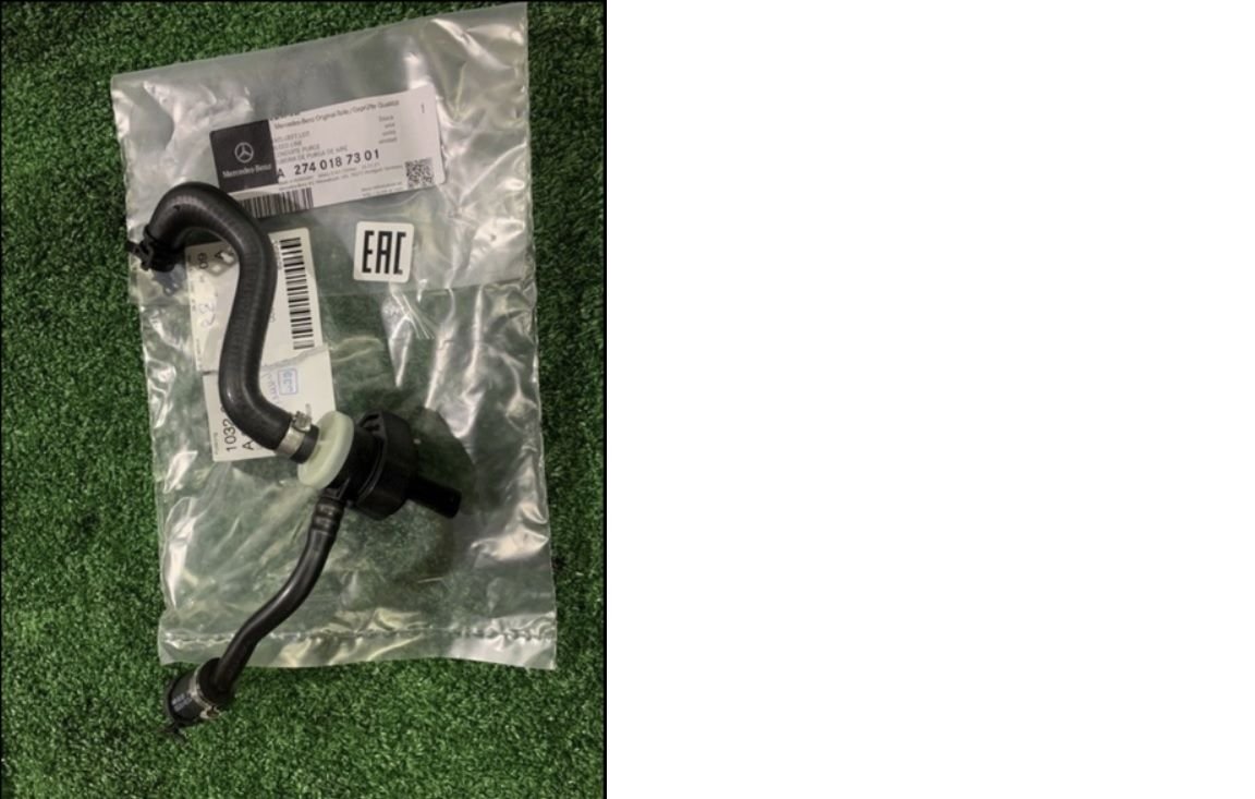

Where did you buy 274 018 73 01
Originally Posted by kcattorney
OK guys, pay close attention to this post by sn202020.
I just bought both a 2015 GLA 250 and a 2017 GLC 300, and both had the P052E code and the P06DA code. Additionally, the GLA 250 had the P0597 thermostat code. I ended up purchasing two of the vent valves, part number 274 018 73 01, (cost $63 each) and splicing them into the system rather than using the Mercedes recommended part (270 090 07 00) that costs at least $638 and requires a lot more labor.
The good news is that splicing in a new vent valve worked on both the GLC 300 and the GLA 250 to resolve the P052E code. The only codes I have left on both the GLC 300 and the GLA 250 are that P06DA code, and it does not make the check engine light come on. The P06DA code can simply be ignored, as recommended by Mercedes.
I made a P052E vent valve splicing video for both the GLC 300 and the GLA 250, and as soon as I've edited the video footage, I'll post them on YouTube along with a link to the videos here.
For all of owners that are dealing with the P052E code, just know that you do NOT have to pay $2,000 to fix it. On the GLC 300, I spent about 5 hours fixing the problem because I was being very cautious and shooting videos, but I could do the job again in less than 2 hours. On the GLA 250, I spent about 4 hours combined replacing the vent valve and the thermostat. But, again, I was being cautious and taking video. Neither required any great mechanical skills nor a lift (it was all done from above). I think I could do the entire vent valve/thermostat job again in about 3 hours on GLA 250. Parts cost for the vent valve was $73 including shipping.
Thanks to sn202020 for the tip on the Metris forum posts and for saving me almost $4,000 between the two vehicles!
Google searching for the last 2 days. 274 018 73 01 is backordered everywhere. Same response, available only direct from Germany eta 3 weeks. Where did you order?

Originally Posted by DontBuyMercedes
Google searching for the last 2 days. 274 018 73 01 is backordered everywhere. Same response, available only direct from Germany ETA 3-7 weeks. Do you know where to order in USA for rush delivery?
I bought mine through Mercedes Benz of Fort Washington, via their online discounted parts website: www.yourmercedesparts.com
However, I just went back there and searched, and it is now showing that the part is no longer available for sale.
Here is my receipt from back in July 2023 (2 months ago) from them. I bought 2 of them - one for the GLC300 and one for the GLA250. They worked perfectly in both vehicles.
Try to find at Aliexpress
A2740182201 $50
It says for glc but looks a little different part number and shape, so you might need to cut and modify.

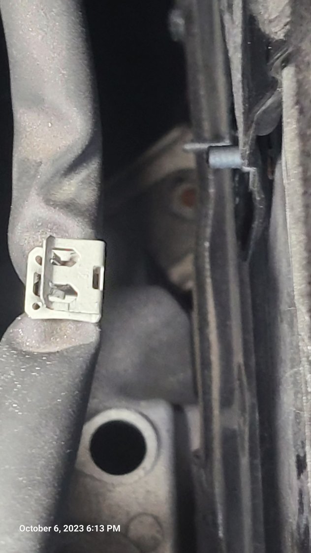

Best video ever. Thank you so much. Replaced it today using your awesome video. The only concern the part # stamped on the unit. Original A000 997 69 12 4 new unit A000 997 96 11 2 and the lower is a different angle. Made it fit by cutting half of the new hose off and using new stainless steel hose clamps.
But what was real strange there is a round open hole. Appears to be the suspension housing. Can only be seen with inter cooler, bracket and ECU removed. Looks like there may have been something connected. What is this and should it be covered?
That hole is just there in my glc when i see my old pictures.
So no worries.
