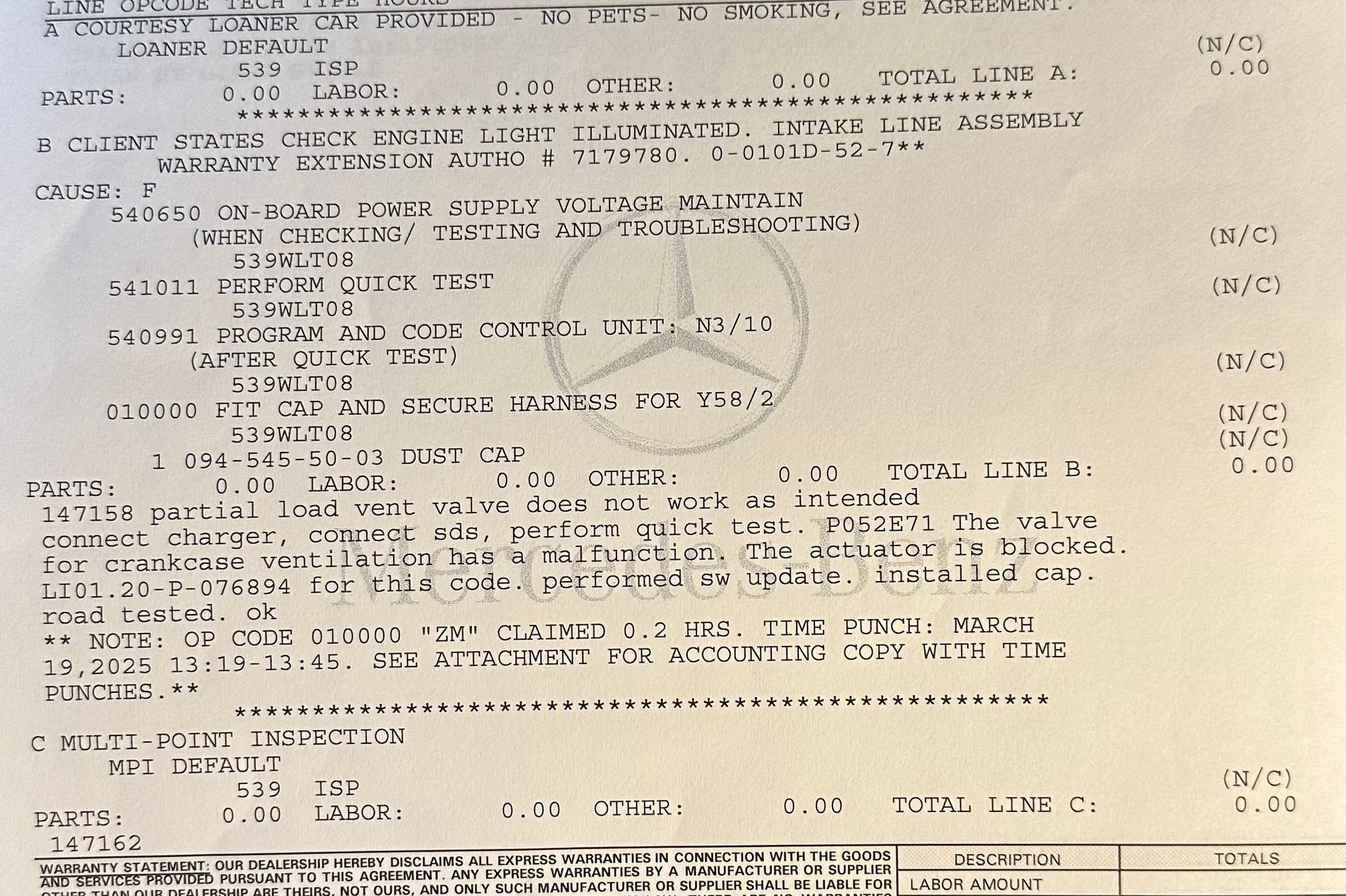

Hey all, an update on this issue. My 2018 GLC300 4Matic recently threw the P052E71 PCV valve code, so I took it to the dealer under the Intake Line Assembly 15yr/150,000mile warranty extension. They did cover the repair 100%, but they did not do the $2000+ multi-hour PCV valve assembly replacement as others have had done. Instead they performed an ECU software update, installed a $10 dust cap somewhere and "secured harness" (see attached). The CEL light and code is gone, so hopefully the update fixed the issue. I have 147,000 miles on this car, so if the PCV valve is failing I hope it truly dies soon so it is covered.
Found THIS on the DOT website after looking up the procedure code LI01.20-P-076894. It says "This li will be updated once the software solution is available for model year 2015-2018 vehicles. Model year 2019 perform software update for n3/10 engine control unit. Replacement of intake line assembly is not required". So it appears that the "software solution" for 2015-2018 is ready, as that is what they did. Fingers crossed!
