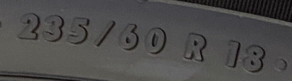

My tires were over inflated at purchase - with rears on my 2020 GLC 300 SUV showing 41.5 PSi, and the fronts were ~ 38.5 PSI. Checked cold tire
pressure around sunrise this morning with temperature around 50 degrees.
Using a high quality tire pressure gauge checked all tires this morning - and reduced pressure in all four tires to 35 PSI.
Before the ride was ok but a bit stiff.
Just curious if anyone is running these 18" tires and what you feel works best for your GLC 300's. I'd like to hear your thoughts & comments
re: inflation pressure.
235/60 R 18 Continental Cross Contact LX Sport
